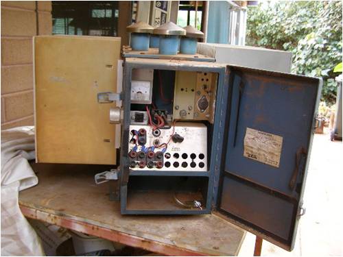

Earlier this year there was a post about heat generating power, I couldnt find the original post so had to start this one.

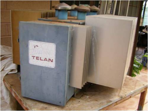

In the original post I said that when I got back home I would post a picture of the one I aquired, it was made by an American company TELEDYNE isotopes & was used as a power source for two way radio repeater station battery charging during cyclonic/cloudy periods where solar power failed.

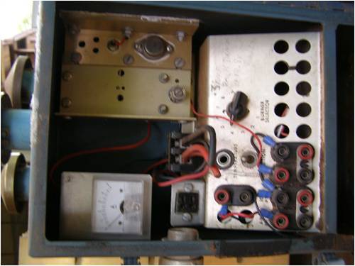

It is powerd by LP gas & according to the tech plate the output is 14.72 Volt,3.4 Amp, 50.04 watt with a .3 amp rack drain at 13.8 volt.
I havnt tested this as yet but my intention is to use it when we eventually move down south & when ive got the wood fire burning in the shed harness the heat from the fire & force it through the metallic conductors ( 4 off ).
Sorry about the one laying on its side.
