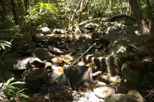

It is installed in one of our fastest flowing creeks here in Far North Queensland (FNQ), a view downstream from the road crossing.
and up stream, showing some of the difficulties anybody with a creek experiences.
Where the turbine is installed is actually a very tranquil place to sit and contemplate ones navel.

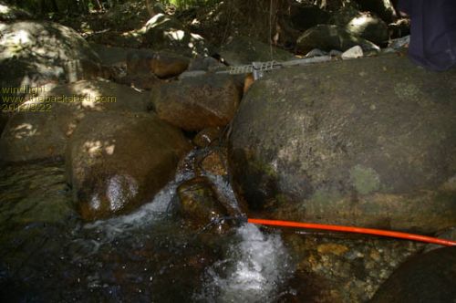

Yes that is a ram pump that supplies their water.

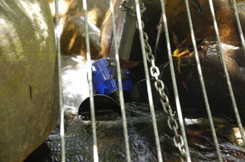

OK the Amp Air.
The velocity of the water flow in most of our creeks is something to be in awe of so I am not sure what it's survival rate is going to be. Frequently big boulders are swept downstream in the wet season, but we do our best to anchor it, clipping cable behind boulders.
The water source is off Thornton Peak Queensland's forth highest peak at 1374 meters,
most of us here live in the lee of this majestic rock.
Yes nearly always shrouded in mist.
Anyway the install is ongoing the unit is two phase, we will install a switch that will parallel or series these two phases so she can get some power during the low times (now).

It can be surprising just how much energy you can extract from a little creek. Not kilowatts, or even hundreds of watts, but a few watts 24 hours a day adds up.
I've been playing around with a home made hydralic ram in my creek, and its looks promising. I'm using a section of the creek with about 600mm drop, and the leadin pipe is about 9m long, and it pumping water up 4m, trickling into a bucket that fills up in about 20 minutes. Very encouraging and lots of room for improvement, but thats for another post on another day. I was inspired to build a ram when I visited a national park up near Cairns a few years ago. The ram was fed by a fast flowing stream about 50 meters below the camp, and it was pumping water up to the tanks to supply the public toilets.
Be interesting to see how the Amp Air survives the wet season.

Hi Glenn, yes the survival of the little Amp Air is debatable but we should not loose it completely, hopefully the cable will hang on to it.
We discussed inserting a joiner into the 25MM rural B poly that leads away from the ram pump so it could be removed in the wet season, but decided to tie the pump to a tree. If the PVC pipe gets smashed then it's no big problem but the pump washing out to the great barrier reef would be.
