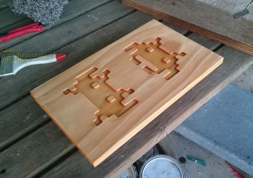

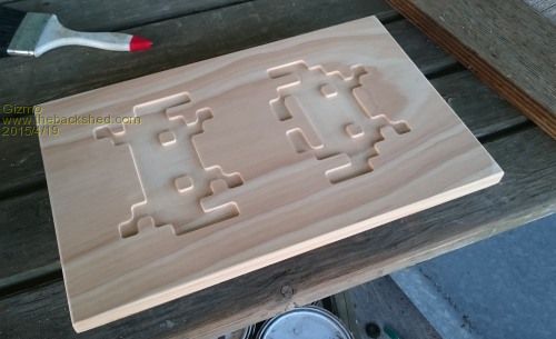

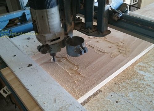

Only those of a certain age would quickly recognise the two characters. CNC'd from a piece of 230mm wide pine, sanded and varnished. The cut is 4mm deep, made in two 2mm passes, I find the router has trouble cutting anything deeper. One tip I learnt, if applying thick coats of varnish, allow a couple of day to dry between coats or the varnish will wrinkle.
There is a recess at the back to hang on a nail.

On picture it looks that some kind of dust removal would be good idea, as dust can be seen half way up the motor.
George
Posts: 5200
Posted: 10:03pm 23 Apr 2015
Yeah a dust removal system is on the to do list. I want something thats not going to draw a 1000 watts and make too much noise, so that rules out the workshop vac.
