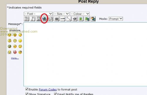

You really need to use the forum tools when you insert a web link, as the forum inserts false characters to the link making it broken, this is done to prevent spam on the forum.
Use the ............
Which is the forth button to the right on the top tool bar,
It will ask you 2 questions just post the link to both questions.
Pete.

archerpalms
Joined: 25/02/2016
Posts: 11
Posted: 05:35pm 27 Mar 2016
See if that works...
https://www.youtube.com/watch?v=PwCRZ0Q_TTo&ab_channel=archerpalms1
