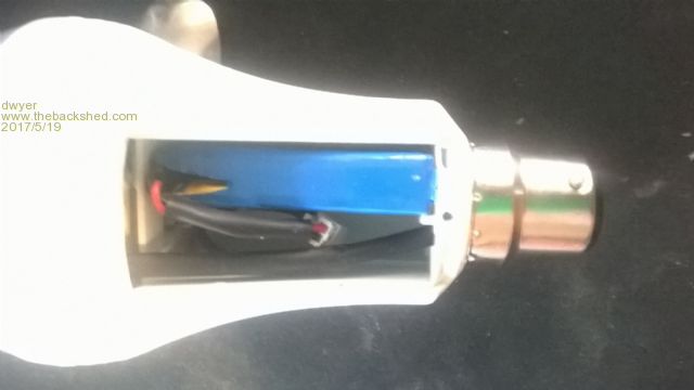

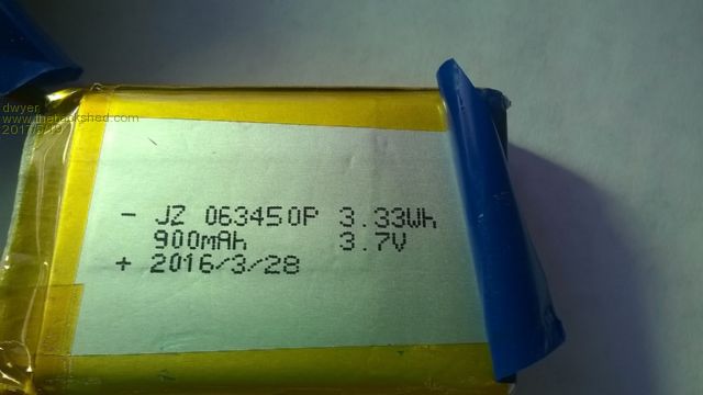

I am going to buy couple of Back-up with rechargeable included for power blackout and one off LED going to pull apart to see the how they set up with the battery, voltage and size of LED power as thinking may LED run somewhere between 2 to 3 volts anyway i will wait until Saturday sale

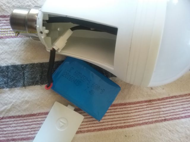

hi Georgen I will download pictures hopefully tonight depend how much time to to change photos size before go on to backshed
Dwyer the Bushman
dwyer
Joined: 19/09/2005
Posts: 575
Posted: 01:08pm 19 May 2017
Hi Georgen

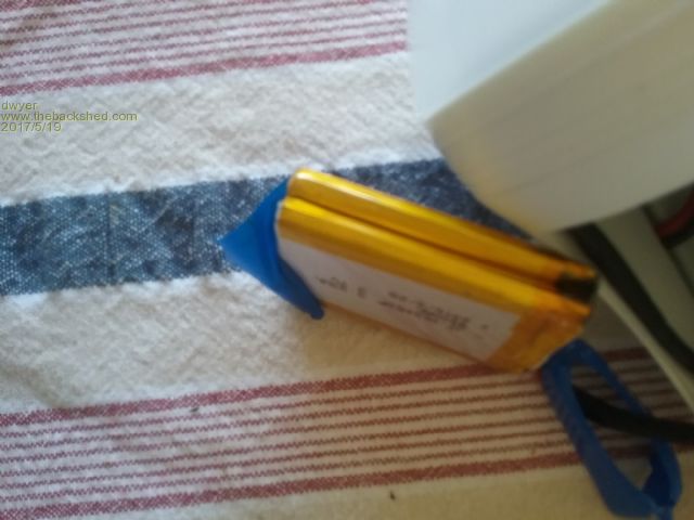

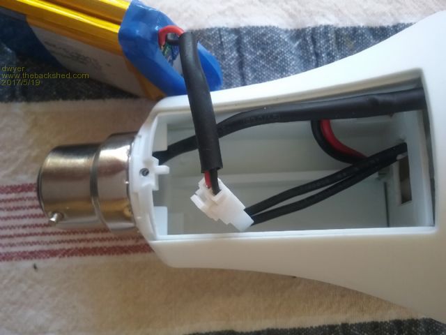

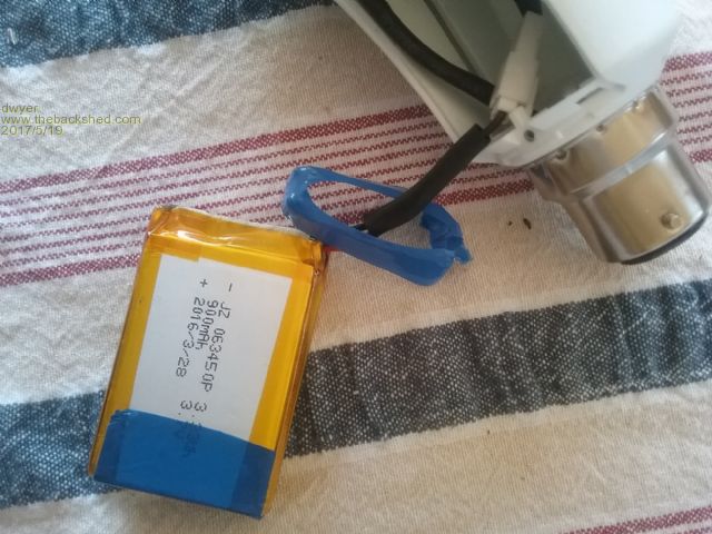

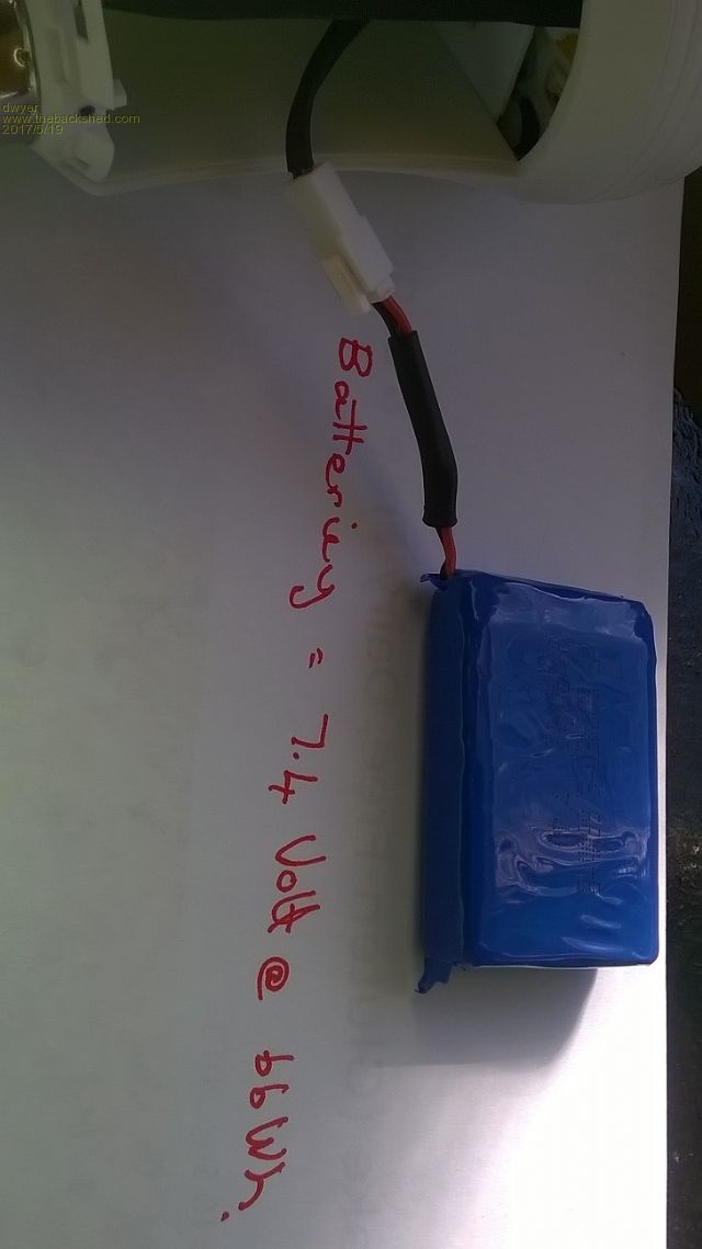

sorry for delay as i got had health problem for last couples of day anyway i have down load pictures for everyone to see however i haven't not pull the LED light apart completely at the monent but will soon and i havent plug the LED light or tested yet to how this work when the main power goes off.
i have just load picture for everyone to see
Cheers Dwyer the bushman

These would bel OK for a night time dim light in a hallway ,etc ,if you could replace battery with a larger capacity one to last all night. Fairly simple to just plug in and forget ..

Sady i didn't buy motion dection LED light mabe should brought one as well anyhow since i brought two LED backup light and i haven't spend much playing with it however i did try plug into light socket while main power on and then i turn main power off and backup LED light didn't not come on and i can't understand how it get working probably ever i remove the LED light from the socket while it LED light was on, it cut out about 1 second so i replaced back into light socket ever since so i might try search on Google later on. Any advices will help .

I would plug bulb in for at least several hours for internal battery to get topped up or charged if it was sold flat.
I have torch that turns on automatically after power goes off.
I could trigger it by simply switching off power point.
George
