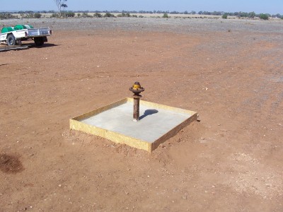

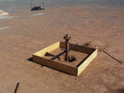

Hi all, thought I would try my hand at building a VWT, so far so good, 8 ft trailer axle ,16 ft x4in bore casing, 2 x 44 gal oil drums, and an idea that has been ratteling around in my head for a while now. Dug a deep hole and put the axle in it,
then spent the rest of the day filling it with cement

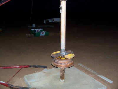

welded the pipe to the rim that came with the axle, and stood it up to see how true ot rotated, and as you can see ran out of light.half oil drums in background.
will continue when I get more time.

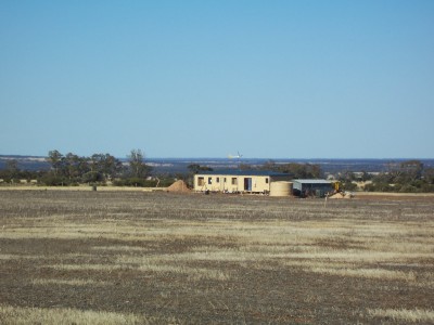

Hi Oztules, you are right, at the moment I have a house in the middle of what was a field of oats,
I have planted some trees, and they are all of half a mt tall, a way to go yet.

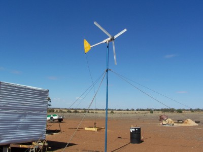

This is what happened to my 500 watt wind gen a few weeks ago,
It`s back up now with slightly shorter blades
still puts out good numbers, at the moment it is putting 4 to 12 amps into two 24 volt fork batteries (745 amphr each)as a dump,
`cos it`s blowing a gale here today, and FINALLY some rain, almost forgot what it was. Grolly

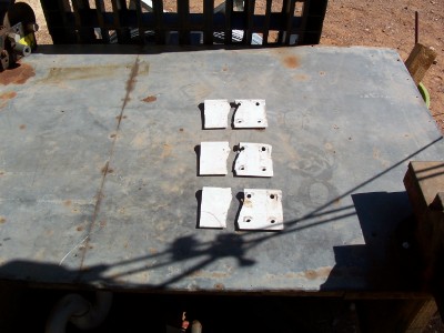

(((It is very windy here, already have broken all 3 blades off the wind gen, don`t know how hard it was blowing (back sliding glass door visibly bending, house rocking) but it was putting out 35 volt 16 amp full furl,, at 3.30 am all blades broke off at the hub.
more on this not very good wind gen later. )))
Hi gill, top bit from another post of mine, as you can see it was really blowing, the thing was swinging around so violently that I think the blades hit the tail or started to flutter, when on full furl it sounded like a turbo prop plane warming up.
Two of the breaks could have been cut with a profile cutter ,they are so identical, and the other blade was bent with a bit of yellow paint on it off the tail and a small dent in it, which makes me think a glancing blow.
This was while I had it at 6 mt high, I have now taken one section out of the pole, and is now a bit over 4 mt, still pushes the needles off the scale and trips the overload on the regulator.
I have had this wind gen to pieces about 5 or 6 times, the red plastic tips came off one at a time in the first blow, makeing it vibrate, and chewing out the rear bearing housing, had a lot of trouble getting it shimed, and balanced, finally used a coffee tin to shim it and a collar to hold the shims in, it is running smooth at the moment, for how long I dont know....the tail bearing is also choped out too, so before I got it running smooth, the tail assembly would bounce up and down, shaking the whole unit.
so as you can see the blades have had a lot of rough treatment,I would suggest a lot of atention to the balancing, and seeing that my blades flex about 4 to 5 inches at the tips, make sure that they cannot hit the tail.
