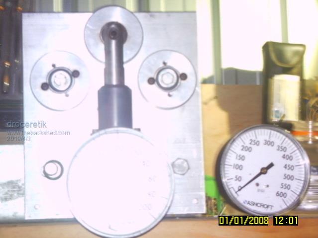

The line payout is measured with a modified land distance wheel which is calibrated with a digital cycle meter. It's accuracy is about 99.99%.
The winch is powered by a 1.1 Kw Teco AC motor through a TECO FM 50 inverter/controller. It is able to handle up to 150 lb line tension with a 40-1 reduction pulley set. The maximum line speed with this ratio is 12 kph but this is with the motor RPM at 6,000 which is not sustainable for more than 1 minute before the motor controller shuts off to protect the motor. After all, it is a 2850 motor. It does operate for extended periods at about 4,000 rpm. This TECO stuff is great. This is the 3rd motor. The first was under powered and burned out early in the record attempts. The second 0.72 kW motor met it's limit with 120 lb line tension. I will use it in tandem with the 1.1 kW motor during the upcoming train tests. It will be interesting to see how single pots and switches control 2 inverters and motors simultaneously.
Line tension is measured with a hydraulic gauge made by engineer, Doug La Rock in the USA. I have fiddled around with load cells lifted from digital scales but it is an unfinished project. If I were able to complete these I could measure line tension at the kite and make it part of enhanced data collection in real time via telemetry.

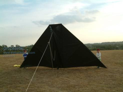

Hi Bob i love flying kite many years ago around the year 1958 as use to make kite out of news paper and homemade corn starch to make glue and only string i use Do you have any picture of your kite
droceretik
Joined: 24/01/2018
Posts: 17
Posted: 07:17am 01 Apr 2019
Yeah, kites are on my web site at http://kitesite.com.au/kiterecord/High_Flying.html
but here are the main kites used for the record attempts. They get a bit worn in that harsh environment and get a bit frayed in high altitude winds so we replace them in time.
Apart from one special larger kite, they are all 6.4 metre span, 2.8 metres tall and have an effective sail area of 12.34 sq. metres.
The original black kite on Rooty Hill in Western Sydney behind the red Nissan.
http://kitesite.com.au/kiterecord/Testing_2004.html
The same kite with my two young sons either side.
http://kitesite.com.au/kiterecord/April_2005.html
The black and blue kite was a one off at was 16 sq. metres
http://kitesite.com.au/kiterecord/Kites.html
The black kite was lost in the wilderness in October 2005. Here is the blue and yellow version in April 2007.
http://kitesite.com.au/kiterecord/April_2007.html
The blue and yellow kite was retired due to damage and the next was black and white kite which was snapped from an on-board camera on a smaller kite over the airstrip at Cable Downs.

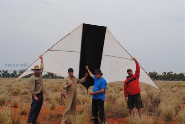

After our world record of 16,009 ft.

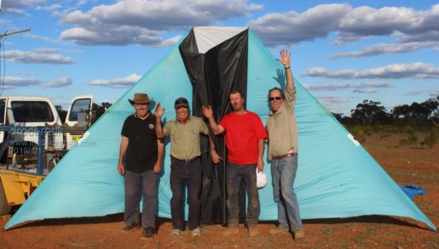

Cable Downs 2012, just before this kite was destroyed by gale force winds

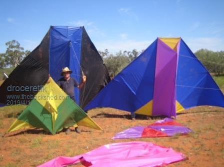

Cable Downs 2005 with the 16 sq. metre and 12 sq. metre DT Deltas plus a "small" delta.

On the top of Rooty Hill in Western Sydney with my two young sons, 7 & 5 in 2004 and it was the first version of our record kites. This one was lost in the wilderness in October 2005.

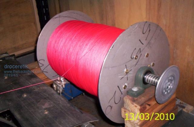

This my "ball of string" a 12,400 metre reel of UHMWPE braided line, otherwise known as Dyneema. I was sponsored by DSM Dyneema with 32,000 metres of various strength lines manufactured by Cousin-Trestec in France with fibre supplied by DSM in Holland. The value of the line is conservatively estimated at $15,000.
This is 300 lb line from Amika in Taiwan. The fibre was supplied by Toyobo in Japan, licenced by DSM Dyneema to produce fibre under the Dyneema brand. This line was 0.8 mm thick.
This was some of the line supplied by Cousin-Trestec and was 6,200 metres of pink line underlain with 6,000 metres of the above yellow line. It's 0.0.62 mm thick and hard to believe it is 180 lb breaking strength. These lines are the main reason for breaking the World record with a relatively small kite. The previous record was 2,500 ft lower with a kite 2.2 time bigger using Kevlar line triple the weight and double the thickness. There was even a guy in the USA who made his own line with a second hand industrial braiding machine. He made 2,000 metres of 410 lb braided Spectra for me. I contemplate purchasing my own machine but $20,000 was a bit much for my budget.

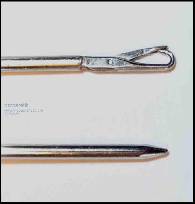

Lines never joined with knots which weaken the line. I always used splices and these Daho needles are expensive excellent. I learned so many new skills such as sewing, pattern making, splicing, soldering, welding, applique and numerous other things for this kite record. All up I accumulated about 50,000 metres of various line over 15 years. I had to build a 5 x 8 metre shed to house kites and kite building materials Then another shed to house my regular tools, then a work port to house all my big machines and trailer then I have my workshop. I have a front shed, side shed and a back shed plus a workshop. No wonder my wife just shakes her head sometimes. The one thing I can't quite get my head around is electronics and soldering.
