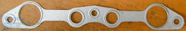

How the hell do METAL gaskets work?
The softer ones made from cardboard, gasket paper/card, or the manifold gaskets that are metal but with a compressible inner material I understand.
The all metal ones make me uneasy. Metal is not compressible when used as a gasket, so how the hell does it actually seal?
Take this metal gasket:
It is from a 1979 Vauxhall Chevette, but was also used in the Vauxhall Viva's, and the Holden Torana's(as they had the same engine).
I note the ridges around the holes. They squish down flat, as old ones taken off engines don't have those, they are just flat. That must be part of the thing.
This intake gasket makes me nervous, as the two big holes are the intake ports(which is fine), but the two medium sized holes in the middle are water-jacket holes for water from the cooling system to heat the intake manifold. How can metal seal against water? One would think that water would instantly leak from around those holes, and - God forbid - be sucked towards the intake ports. That would be REALLY bad, as trying to compress water in a cylinder will blow holes in things internally - not good.
I would love some mechanics on the forum to reassure me and explain to me how a metal gasket can possibly work as a seal where water is concerned. Edited by Grogster 2018-11-06

I know what you mean, they used to work most of the time, with good toque on the bolts.
Just recently had head gasket issues with the Mitsubitchy Maggot, The steal rings would not compress enough around the cylinders (on the new Gasket) and let the water out of the water jacket. I suspect the metal rings were not to the standard quality.
Anyway If one is worried about it leaking, what we used to do with the old ford XY when replacing the head gasket or other manifold gasket, we get an old tin of silver/aluminum paint that has not been shaken or stirred for years, get the thick stuff from the bottom and paint the gasket with it, always worked, just did the same thing with the Magna.

Never used silicon on these things, there is a multitude of goops that will do the job.
On the exhaust side use maniseal, comes in a tube and seals well in exhaust heat. I think it very slightly expands to fill all voids and eventually sets like concrete.
On inlets with water jackets we used something like "rolls royce????" gasket goo/compound.
It is blue, came in either a tube, spray can or tubs of varying sizes.
Paint or spray it on, wait a moment for it to almost go tacky and then assemble.
This one can be used on head gaskets. Never had a failure that wasn't broken bolts etc.

the way it works is the two mated surfaces are perfectly flat and parallel machined. they will also be quite stiff like cast alloy parts.
So the gasket is only compressing and conforming .00625 - 0.1 of a mm and the stud/nut tension clamps it tight. Pliable gaskets are used on sheetmetal parts that can flex but they are poor at holding high pressure liquids or gases.
Also metal gaskets dont decay over time with extreme heat.
hylomar is a non setting compound for machines that need to be disassembled and inspected regularly and the gasket needs to be reused. normally the gaskets with crush rings are supposed to be installed dry and not reused.

I don't understand how the crush-rings work.
When squished, they will flatten out - fine.
How does that help to seal?

The crush-ring fills in any deformities in the mating surfaces and provides a seal against gas etc.
From memory, the material of the crush-ring in your picture is bulked up by the ring making process. ie, when in the press they punch the holes then press the rings, slightly enlarging the port hole and providing a small amount of crush material to make the seal.
When bolted together the indented raised ring crushes, the inner port hole remains the same size.
new gasket 2cm hole, used gasket 2cm hole, crush ring now flat.
Some also used an etched soft copper layer or similar addition to the indented ring to enhance the seal.
Hope this helps

IIRC the metal gaskets had a "varnish" ie coating which created
the seal, as it became pliable under heat and pressure. They were not
reusable, and sometimes would not separate without a lot of grunt (and
damaged cylinder heads).

Maybe they do in fact crush (deform) but just the tiniest amount.
Where that amount is enough to fill in the gaps that otherwise would let gas (or liquid) out.

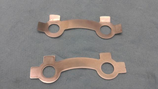

Hi Tony what sort of car you did on gasket as my ford territory tubro has replace casket fews time as 2 or 3 bolts come loose mosty on number 6 cylinder exhaust thinking drill hole on bolt head and wire up like use aircraft piston engine sometime i get mad thinling about weld the bolt on the mainfold but not yet
Posted: 08:09am 10 Apr 2019
Drilling high tensile bolt heads for safety wire is not going to be that easy, but if you can do it, its an excellent solution.
Something a bit easier might be home brewing some bolt locking tabs from thick gauge sheetmetal.
