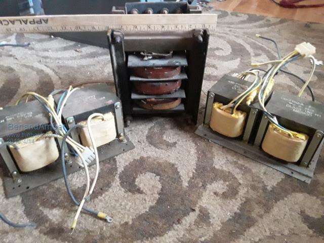

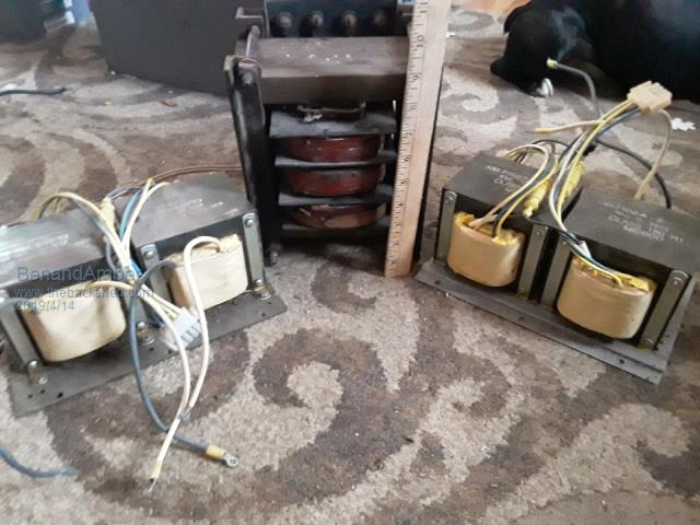

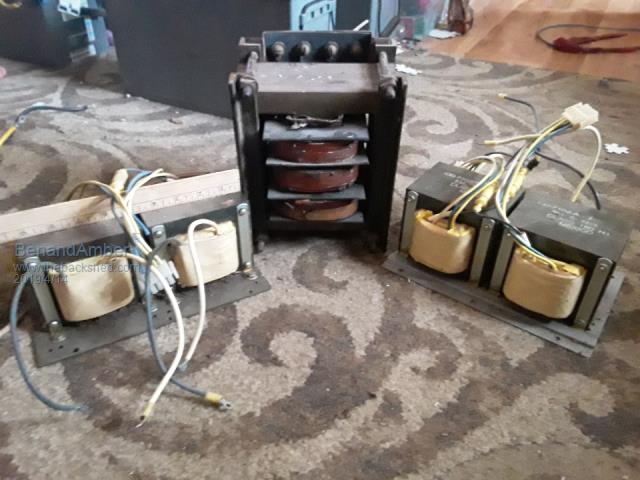

The ones on the right and the ones on the left are 3000va out of APC smart 3000 UPS
All of these Transformers are incredibly heavy you would not believe how heavy these APC Transformers are if I had to guess I would guess 40 to 50 lb but don't quote me on that
And the center ones even heavier
I'm not sure what the one in the center was originally for
you can plug it into the wall and leave it for days and it does not even get slightly warm with my clamp meter
the no load current when plugged into the wall was .07
The apc Transformers can be took apart and stacked in any way that you wanted
The Old Wire that is on the center one will be taken off
new wire will be used even though this wire that's on it has no problems at the moment
it's been setting out in a building and has gotten very dirty
If necessary one could stack and build 1 out of two or any other combination
I am hoping that some of the more experienced people on this form will comment on these Transformers for warpspeed inverter The Good The Bad and The Ugly lolEdited by BenandAmber 2019-04-15
Posted: 09:42am 14 Apr 2019
A few jobs for you;
1. measure the cross section area of the center leg (the one under the coil) of the core, in sq mm preferably so it makes sense non US persons . Write that down and report here also.
2. take the transformers apart, by that I mean remove the brackets and unleaven the E-I laminations so the coil can be taken out in one piece. If you cannot undo the laminations (because they are laquered or stuck together too firmly) then you cannot use that transformer.
Keep those laminations separate for each transformer so they can be re assembled to the same thickness.
3. if the existing coil wire comes off very easily without damage to the enamel coating then take it off. Straighten the wire gently by the methods you had read about on this forum.
4. if there is a sound bobbin under the wire, save that for your re wind job.
BTW, that post should have been in the electronics section. Perhaps under a new topic like: B&A warpinverter build
Posted: 10:24pm 14 Apr 2019
It looks like the higher voltage 230v winding is on the inside. It may only require the outer winding to be modified or replaced. The low idling current is ideal and the 3Kva rating perfect too.
What voltage are you measuring across primary and secondary when plugged into the mains ?

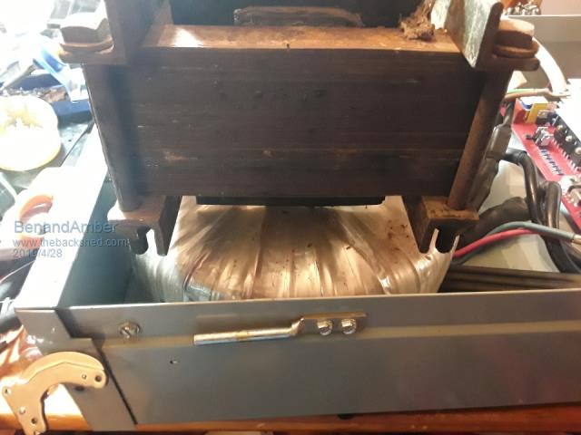

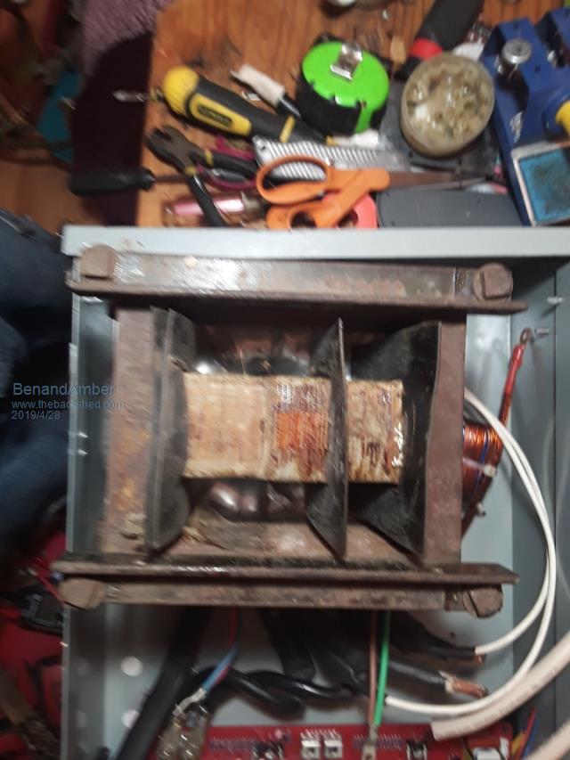

The bottom wire of the large Transformer is damaged
even though it still works it' pretty dangerous
the upper two seemed to be in good shape the upper two are hooked together and work as the primary
all three of the sets of wire are independent of each other but connect on connectors on the front of the Transformer
I'm not sure you guys know a lot more about this to me but I think it will have to be totally rewound
The new rewind would be instead of three separated windings
the primary on bottom taking up the whole I
then the secondary on top of that of course I could be wrong you guys know a lot more about this to me
The other 4 Transformers are APC UPS Transformers so I think they will be high quality also
All 4 of them are exactly the same as far as I can tellEdited by BenandAmber 2019-04-17

I did try to take the big one apart and the laminations don't seem to want to come apart
I didn't want to bend them I've always just wound them like you wind a toroid
I've never tried it with anything other than a battery charger or something very simple that way may not work well for an inverter I have no clue

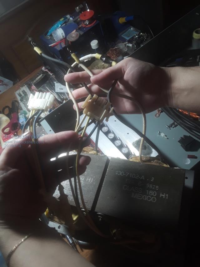

I did hook one of the four Transformers to Mains voltage
think if I remember correctly around 13 volts came out
the Lowe's sod are hooked in series I think that would be around 26 volt
the APC they came out of used a 48 volt battery pack
there are more than one inputs on the high side of these for Transformers I don't know if they were put there for different voltages or what
the side with the plugs is the high side both of these plugged into the PCB board I still have the board
I think they have that many wires for either different voltages or voltage sag from the grid

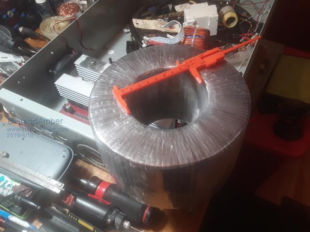

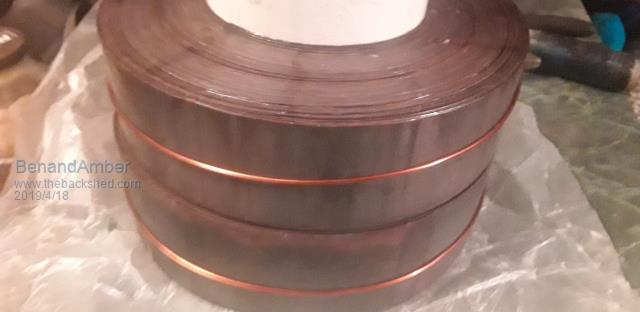

Me and Amber have made a homemade toroidal core
out of pretty easily scrounged up materials
For poor people like us that can't afford to buy a high-dollar toroidal core
we're getting ready to try out pretty soon I will let all you guys know how it goes
We also make our own liquid rosin
it is the best rosin I have ever used smells really good also
it is made out of dried up pine sap and alcohol
it doesn't burn away like normal rosin and it don't Clump up like lard when you clean up a board
Epoxied baked in the oven and taped ready to wind wire
This is the Silicon still wrapped around a sewer pipe while we was taking a break I wrapped copper wire around it so it didn't spring out like a Big Spring if you've ever rewind the spring in a small engines pull start then you'll know what I meanEdited by BenandAmber 2019-04-19

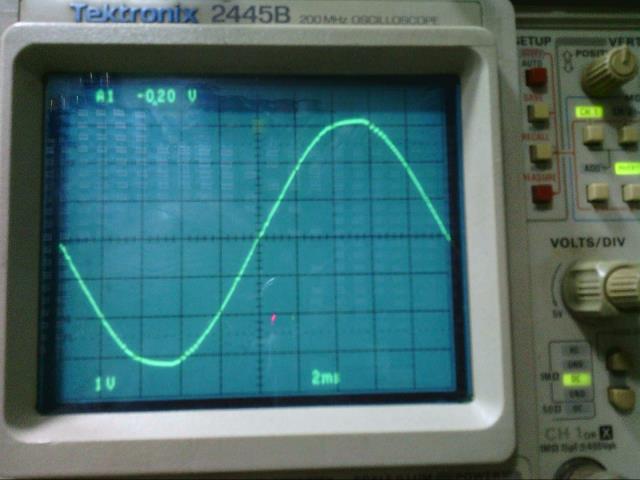

I'm not the best at measuring stuff but this is pretty close
The lacquer on the wires are not the best even though it has no shorts right now but the wire will most likely have to be replaced

How are you sourcing the Silicon Steel for the core?
