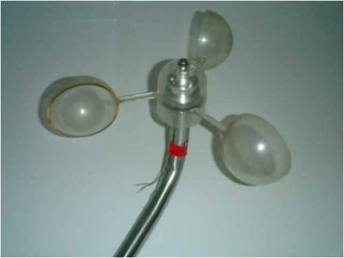

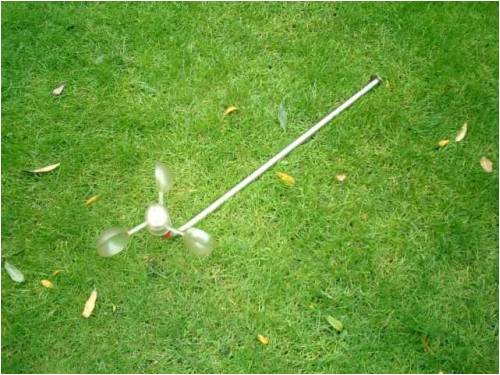

Just another anemometer project. Nothing fancy, but made entirely with scrounged parts.
The anemometer vane was bought 2nd hand a long time (~15 years ?) ago at a boat market. Don't think it cost me more than 1 guilder (0.50US$) at the time, brand 'Vetus'. Rather than trying to build something like the vane yourself I'd advise to buy it at a boating supplier, as it's a regular replacement item for anemometers (on boats pieces of rigging tend to quickly damage those fragile vanes).

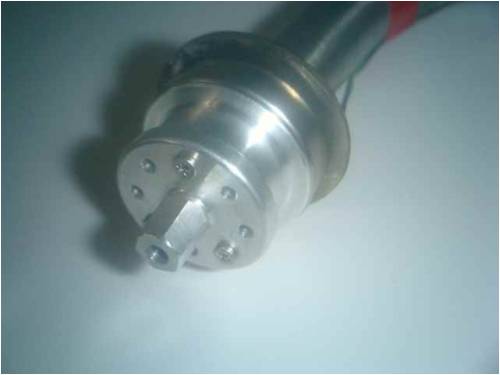

The motor is an old harddisk (HD) motor, 3-phase output, about 1Vac maximum at the normal anemometer speed range. The motor is installed in a piece of bent stainless steel pipe on a welded-on flange. The flange prevents too much rainwater 'creeping up' into the motor. Time will tell if this is enough moisture protection. The output is sent over 3 wires (yet to be installed; it has been tested, but still needs to be 'finished up') to a 3-phase rectifier made of germanium-diodes. I initially tried using just single phase rectification but the rectified AC is just to bumpy at these low frequencies, with the needle of the meter vibrating a lot. The 3-phase rectification solved that.
I made an aluminium adapter to attach the rotor vane to the HDD motor, filing a 6-sided outer-hex 'nut' to fit inside the vane. The adapter is attached to the motor using 3 stainless steel screws.
Still have to install the cable inside the steel arm and calibrate an analog meter (that way no external power supply is needed; the anemometer provides the power it needs for its own readout), but apart from that it's finished. Made entirely from scrap. And, another use for old PC parts... after the PSU, now the HDD motor can be put to good use too. Maybe it's time for a new 'scrapheap challenge': build a windturbine out of old PC parts...
I'll admit it's nothing too fancy and it can't log (I'll leave the logging to the lumberjacks... Hi Oztules!), but for my purposes plenty good enough. There's really no excuse anymore for anyone not having an anemometer. (the HDD motor idea was stolen from the Dans, but I like my model of motor much better than the thick, flat motors they used; the rotor vane now actually acts as weather-protection house for the small motor as well.)
Hopefully the above is of any use to others too.
Peter.

Good one Peter,
I like the idea of the anemometer providing its own power. I'm building another using old HDD motor and I've found there are quit a variety out there. I've found 6 magnetic pole, 8 pole and 12 pole and I haven't even started on the pile under the bench yet. I like the ones with the more poles best though they seem to use a smaller diameter which gives me less room for my hall effect sensor and iron block.
I must check out our local chandlers for those cup heads. Very neat and that'd save me a good bit of work if the price is right.
Out of curiosity, what's the voltage output range and is there a display circuit or a simple labelled millivoltmeter?
Nice project. Well done.
