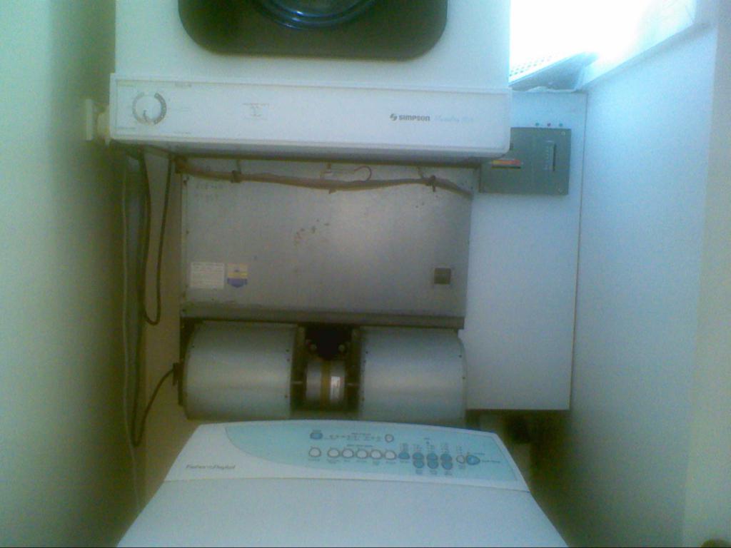

Posted: 12:11am 12 Mar 2021
Only fairly radical thing I can think of, was coupling up a Rinnai gas space heater to a tumble dryer.
In winter the 2Kw required to run an electric tumble dryer was a bit optimistic with my small solar system, and natural gas is relatively cheap here in Melbourne.
I bought a $50 e-bay victim tumble dryer, and an e-bay $20 Rinnai gas space heater, so nothing really expensive if the whole project fell on its face.
Anyhow, a standard Rinni room heater takes in cold room air at the back up near the top. There is a double ended centrifugal blower at the top that blows cold air downwards through the heat exchanger, and hot air comes out of the front near the bottom.
I removed the blower from the top, and bolted it where the hot air normally comes out, so the direction of airflow through the heat exchanger is reversed.
The hot air now spews out vertically directly from the top of the heat exchanger.
I bolted the Rinnai to the wall in the usual way, and mounted the tumble dryer on top, so the hot air blows upward into the inside of the tumble dryer cabinet. The hot air discharge from the tumble dryer exits through the wall in the normal way.
Its an odd looking device, but it works extremely well. Both the temperature and airflow ended up being perfect on the low burner and low blower speed setting, and its been working for the last five years drying my washing without a single problem.
Its a bit weird, and If I get a lot more solar panels, probably unnecessary.
But it may be of interest to someone as crazy as I am.
Edited 2021-03-12 10:30 by Warpspeed

That's Brilliant Tony!

I agree, amazing job there.
