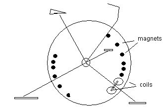

I have played around with a pedal generator and learned a few points among them the need to avoid friction as much as possible, to avoid gearing stages and to recognise that pedal power is not smooth.
So I came up with this concept:-
The generator consists of a wooden disc wheel, heavy MDF, or some such. This large diameter wheel provides an effective flywheel which is really necessary for a pedal machine. The generator consists of a few coils, four might be enough, arranged in pairs either side of the disk and connected together via a soft iron 'saddle' (i.e. 'U' shape) pole pieces. The magnets are mounted in holes in the wheel and pass between the coils.
Now the interesting bit is that magnets are not uniformly placed around the wheel but instead are grouped so that maximum generator effect occurs at the two points in the cycle where pedal pressure is highest and none, or very few, when the pedals are at top and bottom.

Thats downright cunning ....... I like it.

maybe another set of switchable coils for warm up/power runs or female/male share exersize generator via a double/tripple pole switch

.... I think the way to do that Matt would be to adjust the load.
