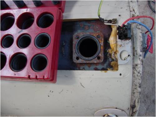

So... I had procured a small (50 liter) electric hot water unit with a still working element... whoppee... now what??
48 volts does not do much into a 240v element I=E/R. It is a 2kw element so W=ExI E=240 so I=8.3A .... R=240/8.3=28ohms So if the element is 28 ohms ExE/R= 48X48/28 = 82 watts at 48v...... not very impressive.... we need a plan B

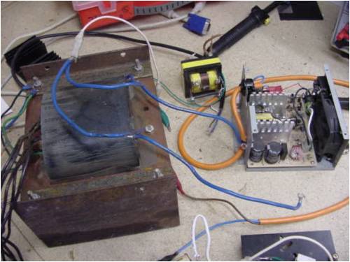

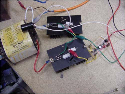

It is a cheap nasty but very effective 800W 240vac 50hz inverter. It eventually became 2kw by using a bunch (8 50A 120v 350W MJ11033): darlingtons and this monster 40lbs transformer:
I had it running nicely with this setup, until I dropped a screwdriver onto the rails of the transistors... killing one, and it managed to take out the other 7 at the same time.... 30 dollars of transistors out the window.... sigh clumsy clumsy oaf
So Plan B went to hell in a wheelbarrow... I'd run out of bipolar victims for the time being (I had a heap of 2sk1609 fets but at 900v the rds on was too high... even if I used 20 of em...curses), so it was on to a simpler PLAN C.

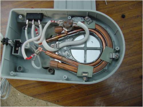

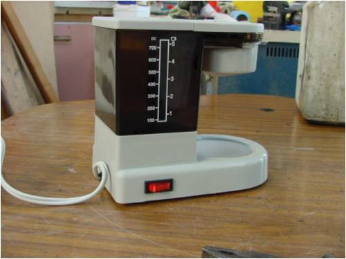

PLAN C consisted of rattling around in the shed for that car coffee maker I had purchased years earlier, and felt was useless.... but had kept it anyway. It had cost a princely 5 dollars, and for how it worked ... it was overpriced.
However... I had plans for it right now.... were going low tech this time.
It looks like this in it's native form:

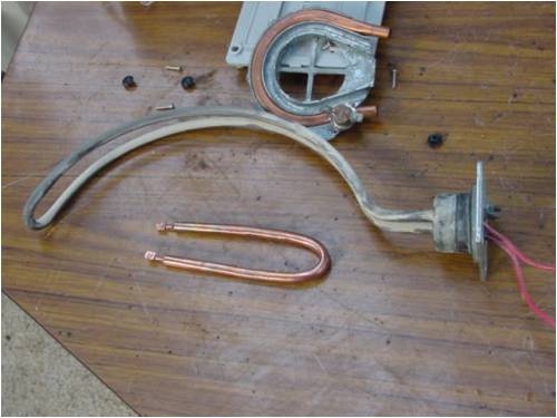

I know it doesn't look much, but look in here:
With some gentle persuasion, you get the good bits out like this:

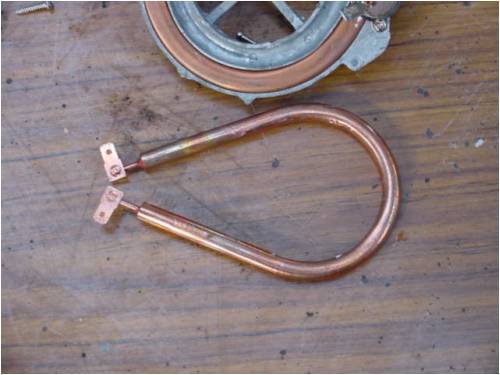

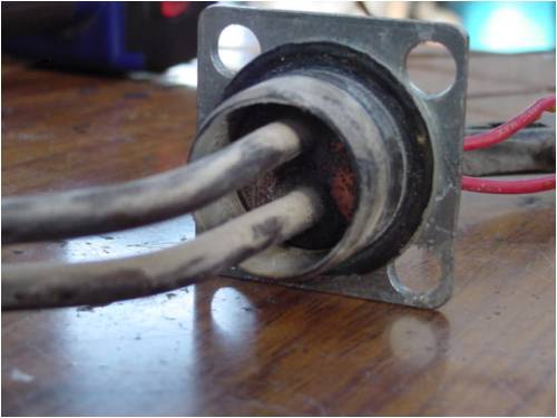

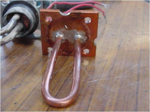

Here is a picture of the original element, with the new kid in town next to it and bent to shape.
And a picture of what we need it to fit into/look like:

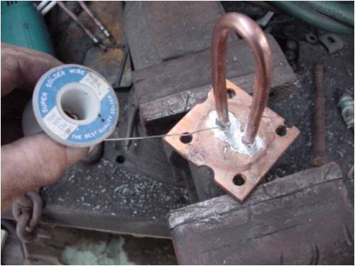

Ok now we need to cut out a piece of copper plate (1/4"thick mine was 65mm square with the outer 4 holes at 45mm centers), with the two holes in the middle area to accommodate the coil legs to come through.
Now we just need to solder the legs into the copper plate. Clean the copper plate with some sand paper, likewise the coil jacket.

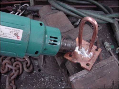

I don't have a torch, so I use a hot air gun to heat up the copper, like this:
And then run the solder into it like this:
And we are rewarded with this:

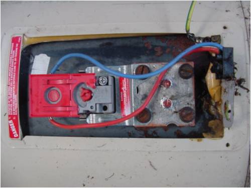

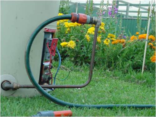

Now we screw it into the water heater and were good to go. The temperature control is integral with the fitting, and we will use that as well. An O ring is used to seal the plate to the housing like this:
Finished it looks like this:
So it is off to the hose to half fill the tank and check for leaks. As it fills, I close off the outlet with my finger and let the air pressure insdie build up against the water pressure so I can test for leaks.... there are none..... wonder where Murphy is hiding today....

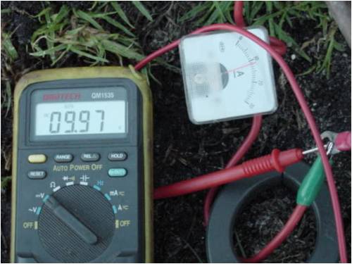

On 12v it drew 10 amps, on 24v it drew 25 amps. 36 was out of the question and 48 was looking for an explosion of some sort..... already had that with the transistors so didn't want another one.

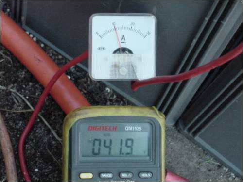

I had a DC motor controller I had built for a motor ( to grid drive a 10hp induction motor...... to watch the meter fly backwards... idle curiosity), and this looked like a good time to wheel it out.
So, driving with 42v into the controller, I dialled up 10 amps on the input amp meter so I was drawing 400 watts or so. like this:
I had an amp meter on the output and measured the voltage into the heater... it looked like this:
In my language, thats about 100 watts.... methinks Murphy has arrived and stolen the other 300 watts.
This is obviously some cause for some concern... 400 in, 100 out..... not good. I wound the control pot on the motor controller up to 25A@40v...... were talking about 1kw here. I could hear the element boiling the water in contact with it.....but the meter on the input said 25A@21v...only 500w or so, but the wire was hot... there was lots more than 500w going into it.
I backed it off to 7A input@42v... 280watts is plenty enough to do what I want..... but what happened to the other 4-500 watts.

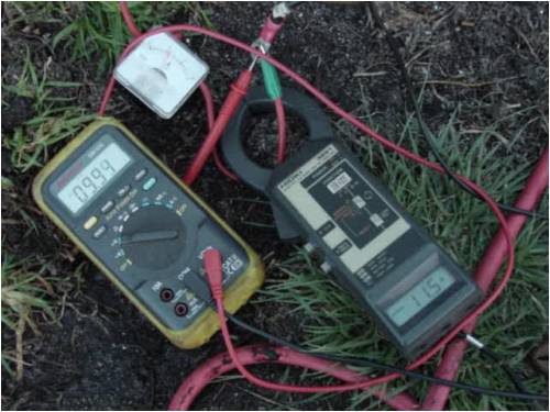

I had an AC clamp current meter. I put that on the dc line to the water heater... and there it was... my extra power was in AC form.
So the mystery was solved, because the motor controller was chopping the power, the current was going to the element measured as 11.5A on the ac current meter, 10 or so amps on the DC meter, 10vdc on the dc volt meter, and 17vac on the ac meter... funnily enough it roughly adds up to the input power. The chopping also caused a small deviation on the input readings, but not enough to take any notice of. If I had been only taking the output readings, I would have blown the element in a fairly short period of time.... just beat Murphy this time.
