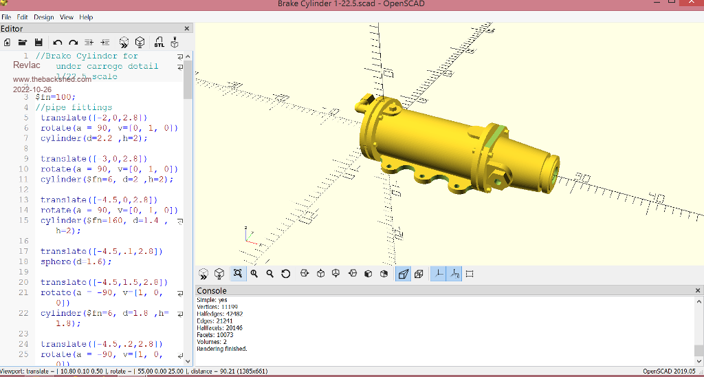

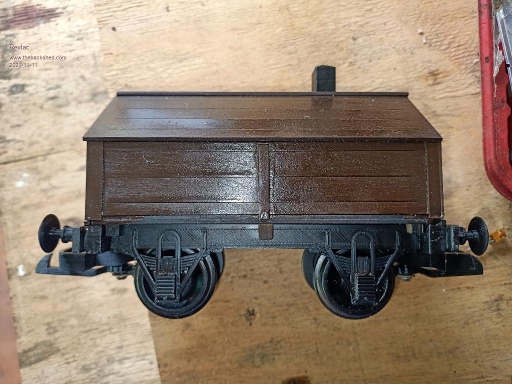

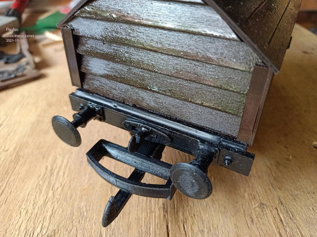

Thought I would post this here, don't really want to join some 3D printing forum just for the occasional object built.
There are a few sheds around that have these as a side hobby, bit of electronics involved in some builds and many have built some some pretty unique gear.
This might be of interest to someone, its a bit expensive to buy parts and things, so most build there own and that's more interesting, certainly learning a few things along the way.
The wagon body was initially build to fit onto a friends (HLW) flat car, to house a sound card for the loco sound, and it works a treat.
Since then I was told that HLW no longer build the Flat car, so I made one the way I wanted and happy with it.
The wagon body, wooden parts are 1.6mm ply wood.
K40 laser cutter 11.5% power for cutting at 10mm per second, engraving at 10.5% 20mm per second.
QR hub caps, raster engrave, power depends on the grain and type of ply, 10% power 1 or 2 passes.

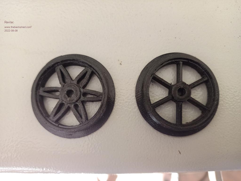

Currently there are 2 options low or high wooden sides/ends for the box, some sanding and fitting will be required, nothing is perfect

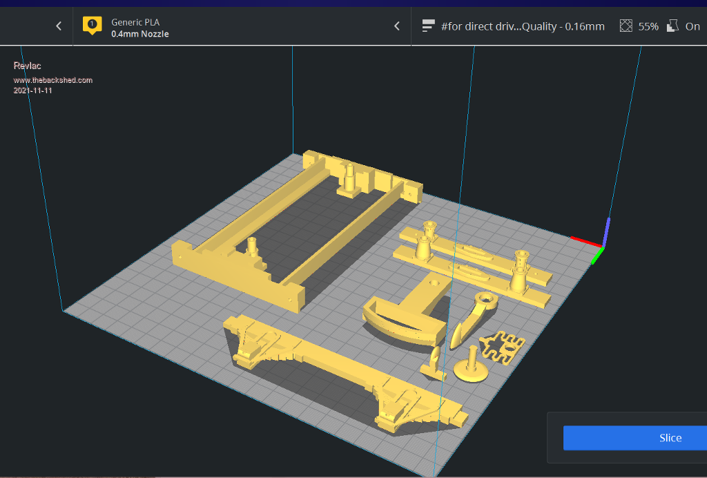

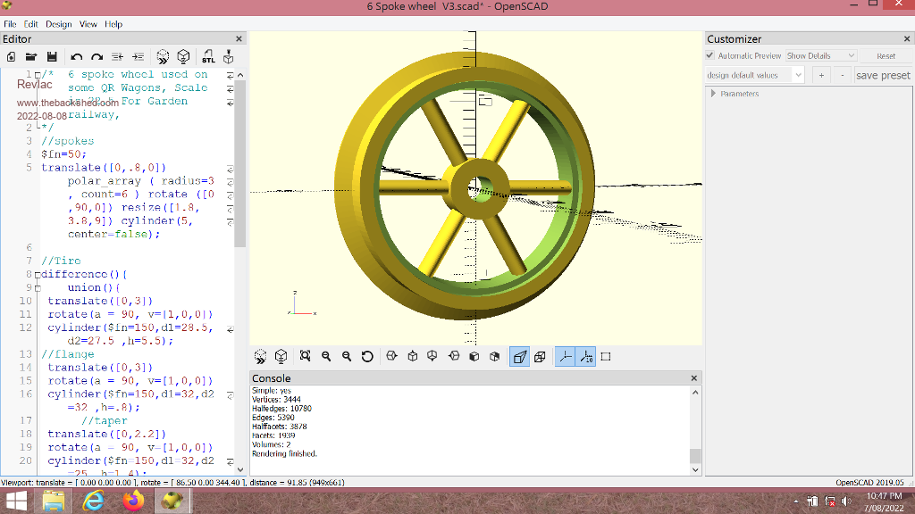

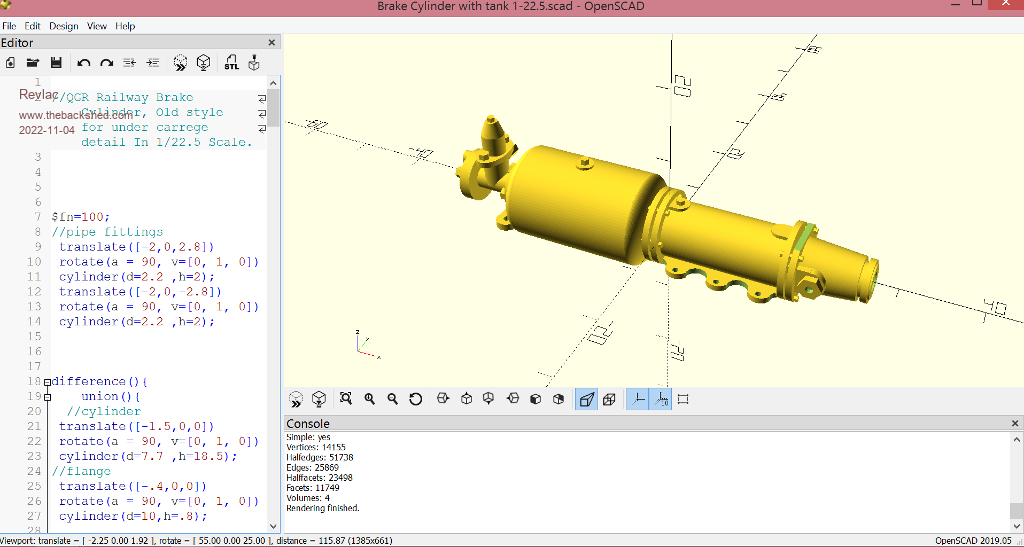

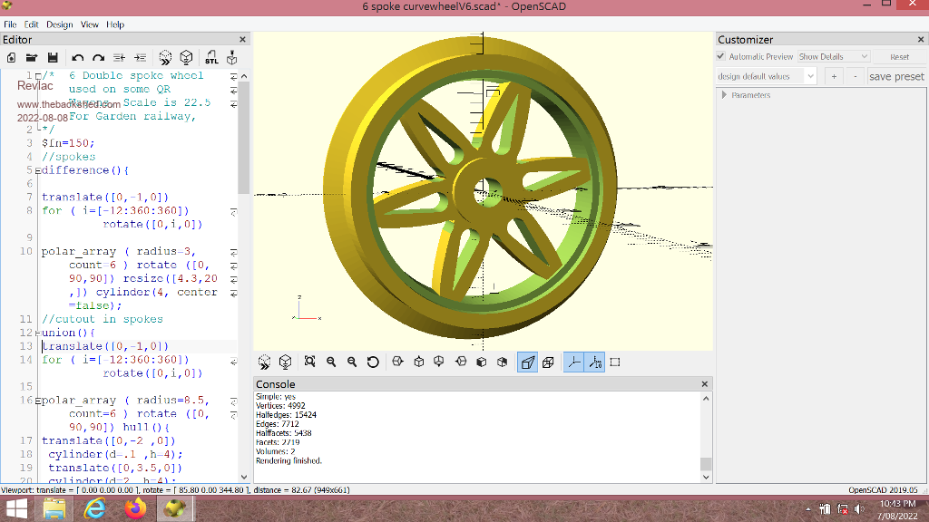

There are 8 different parts to be 3D printed, some parts you will need to print 2 off as you would expect.
2 wheel wagon G Scale 45mm track.zip
Zip contains,
4 svg files
9 openScad files
2 choices, wagon buffer beam or wagon buffer beam, cone shape.
And a folder with some screenshots of the STL loaded into
Wheels are generic, or make your own.
Feel free to modify.
And the STL files,
STL.zip
The frame can be printed with PLA, if you wish, the axle box sides where done with ABS and some of the smaller parts where done with ABS, some of it worked quite well, but other parts where brittle in places because I had trouble keeping the temperature differential low while printing with ABS.
Have since started using PETG for printing these and very happy with the results so far, print with what ever your happy with, the coupler spring remains springy with PETG, ABS is ok as well.
Now what have I forgotten.
Oh, on the corner's, used some small PVC angle, but it could me made out of something else.
Done another different style body, I might post some pictures later some time.

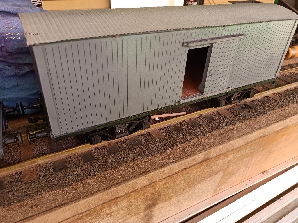

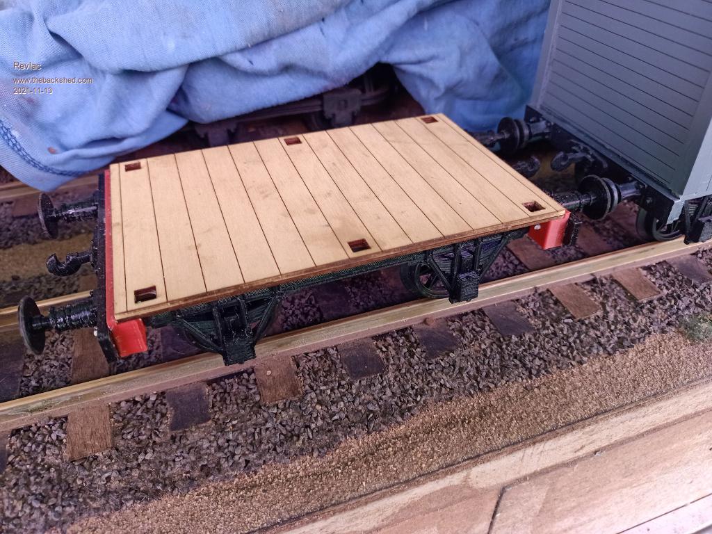

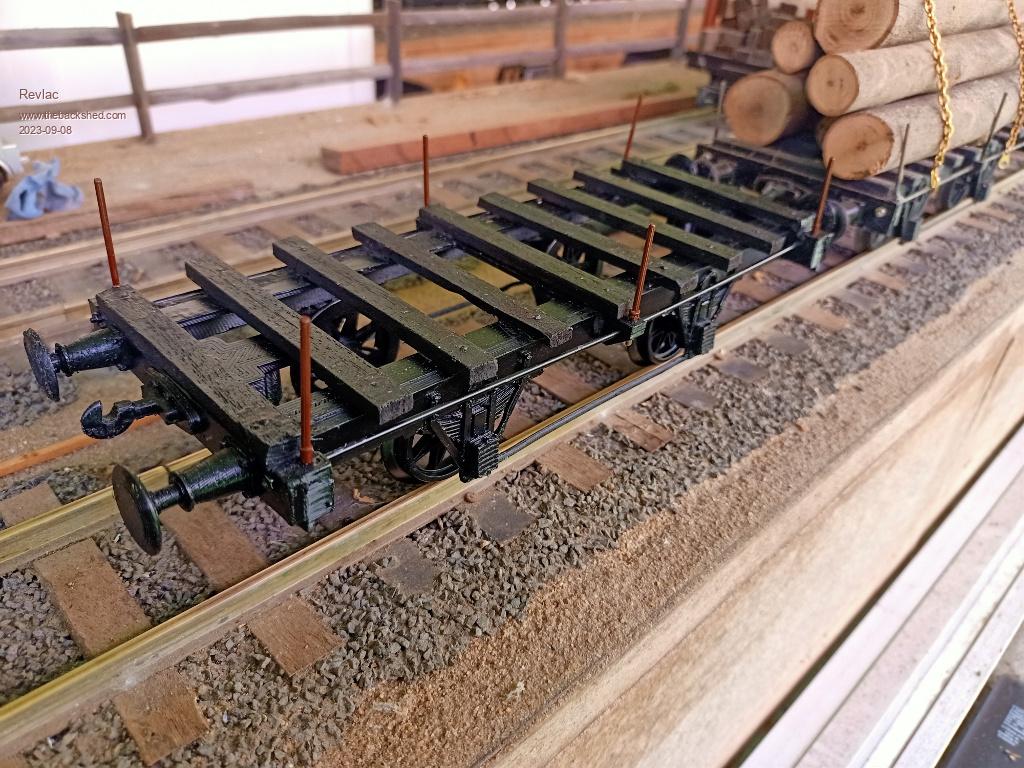

This is the same 4 wheel wagon, just as a flat top, can put something on it to give it a load.

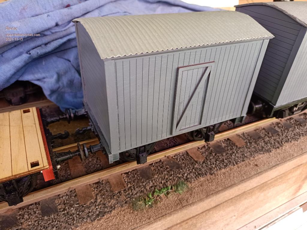

Another 4 wheel wagon, this one I made up into a box wagon, the door needs hinges still or I might even make up another door a bit different, the roof is (inside) is laser cut ply using the living hinge addon in Inkscape.
The roof is corrugated card board, looks ok but would like to build a proper corrugated iron roller and use aluminium instead, there would be several rollers in series to do the job, found coke cans will split if rolled in one pair of rollers...
Or find some softer aluminium sheet, will figure that out later, another job for the lathe.

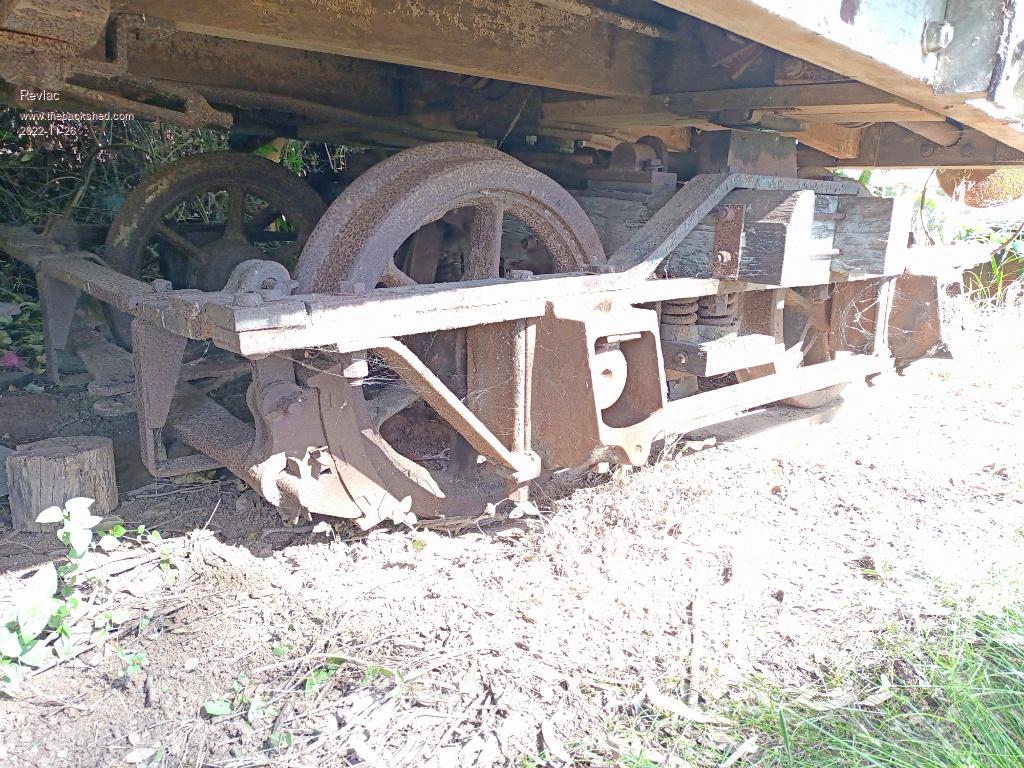

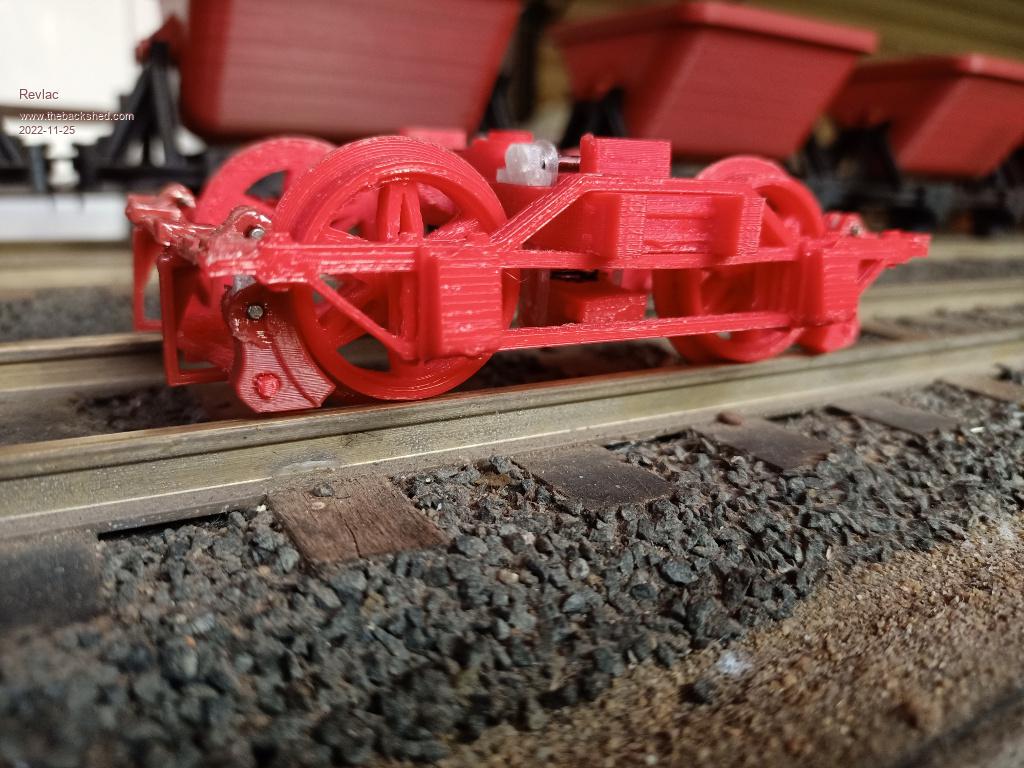

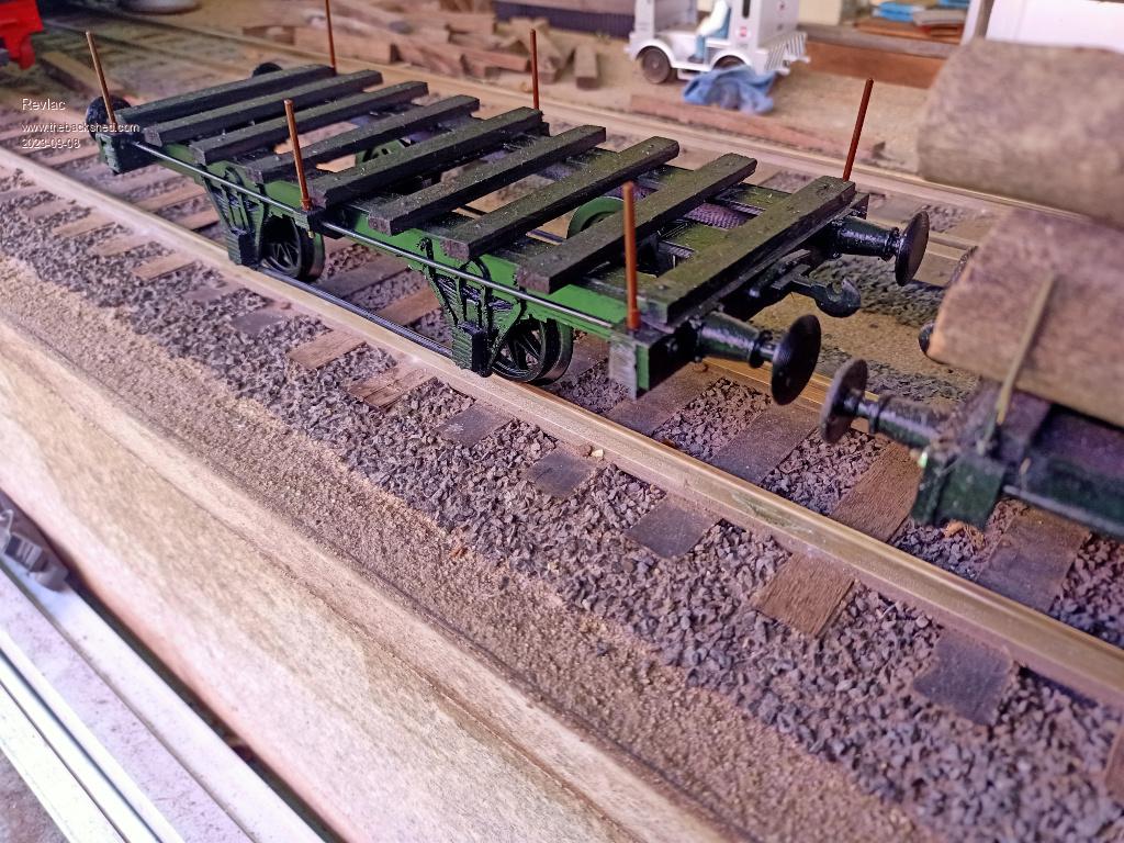

This is a larger wagon, still a work in progress, But I like the way its going, It has exceeded the length limits of the K40 laser cutter when I designed it, so the stepper motor skipped a few steps when it hit the stopper, will have to design it in 2 parts....or grind the stopper back at each end so there is more travel.
Not my bogie design, credit goes to the person that designed it,

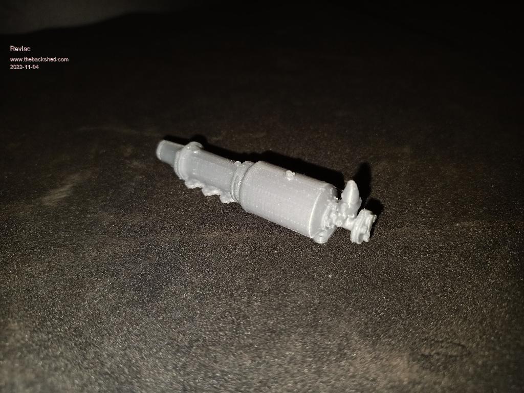

Definitely some really good expensive loco's about, saw a live steam model of 3801,c38-nswgr-3801-newcastle-flyer, when I was a kid we went out to see the real one when it was up in Queensland, coupled behind the Flying Scotsman, that was a day to remember.
There are a lot of ideas that have come to fruition through the use of 3d printers, the resin printers will produce a lot better detail than these filament printers.
Have also read that people have used the resin printers to moulds and parts so they can do aluminium castings of there own designed parts, I don't know the process but would certainly like do some of that for other projects at some stage.

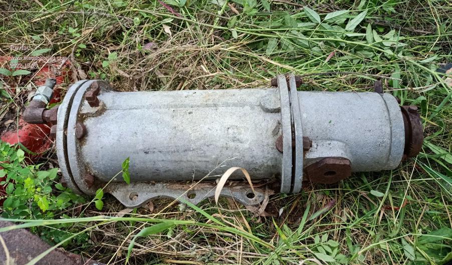

There where quite a few 7 1/4" gauge locos built between friends, one was build out of a old Yamaha 100, the wheels where machined on fathers lathe, had chain drive to front and back axle, the rest of it was built out of junk he had around the house, I think he built it about a week, it looked the part and the kids at the park loved it, it run for years and was one of the most reliable loco that was running at the club, it did a few more years at our own track, the only fix it needed was the exhaust port carbon up, cleaned that up and it went like a rocket also used to add some diesel to the fuel and it sounded and smelt more authentic.
The same bloke also built a Heidi steam loco, he was battling a health issue so built it in a hurry, he got a few runs around our track with it, before he passed.
2 Other friends built some nice Locos, one had a Honda powering his, built the clutch himself and had the linings bonded onto the plate, power driven through an outboard leg, the other had a B&S Motor.
Another fella built his loco around a Ford Prefect engine, AC compressor for air horn and air operated brakes, looked the part and worked really well very good work for someone who spent little time at school and didn't read or right, his loco is now somewhere around Toowoomba.
There is one getting built at the moment by a friend, 7 1/4" gauge loco its all electric, would like to see how he has ridged it all up, he has a bunch of G gauge locos he brought over for me to install sound cards and speakers into, in doing so have learnt a lot myself, some are easier than others, just did a sound card install in a USA Trains SD40-2, everything fit in the fuel tank.
Actually have some casting's in the shed to build a steam loco, boiler parts as well, job for I time when I have nothing else to do.

Made some wheels, mostly because I could not find this type anywhere and its a little more like the real ones that were used on early QGR carriages.
After a few different experiments in OpenScad, eventually I worked out how to do the spokes for these wheels, and I'm quite happy with the way they turned out.
They are modelled off real wheels, not perfect but they look the part.
Printed these in PETG so there is a few little strings still attached, perhaps some printer setting need a little adjustment.
wheels.zip

Made a Brake cylinder for under the carriages to ad a little detail.
Very handy to have real one on hand as an example.
It was fun to make this using Scad and can be added to if needed.
This is printed with a .2mm nozzle, easy to clean up the support material, I did an initial print with a .4mm nozzle and the detail is not as good but usable, however the support material was a real PITA to remove and clean up the model, worked out faster overall to use the .2mm nozzle this time.
The photo is blown up to get a full frame, the model in the picture is only 32mm long.
Scad and STL Brake cylinder.zip

Posted: 11:12am 04 Nov 2022
This cylinder has the Air Tank and the Triple valve included......Well some resemblance of the triple valve, I don't have much in the way of details on this setup to be able to replicate it.
Like the previous brake cylinder it printed well with the .2mm nozzle.
Scad and STL Brake cylinder with tank.zip
