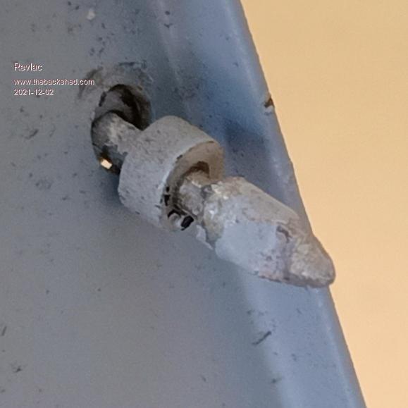

I have used a Erisson rectifier half rack unit that had small half turn clips on the front panel ....
I dismantled it to create my homebuilt inverter and now wonder how the clips were held in the cover when not-in-use.  They are a small (10mm long bolt looking stud that you engage with backplate and half turn it to engage and hold.
There are 4 (one on each corner) ,I'm wondering if I misplaced a spring or circle that holds this stud from falling out of the cover.....
If anyone has a similar cabinet , could you take a look at the clipped maybe photo it so I may be able to make the holding circle or whatever, thanks.

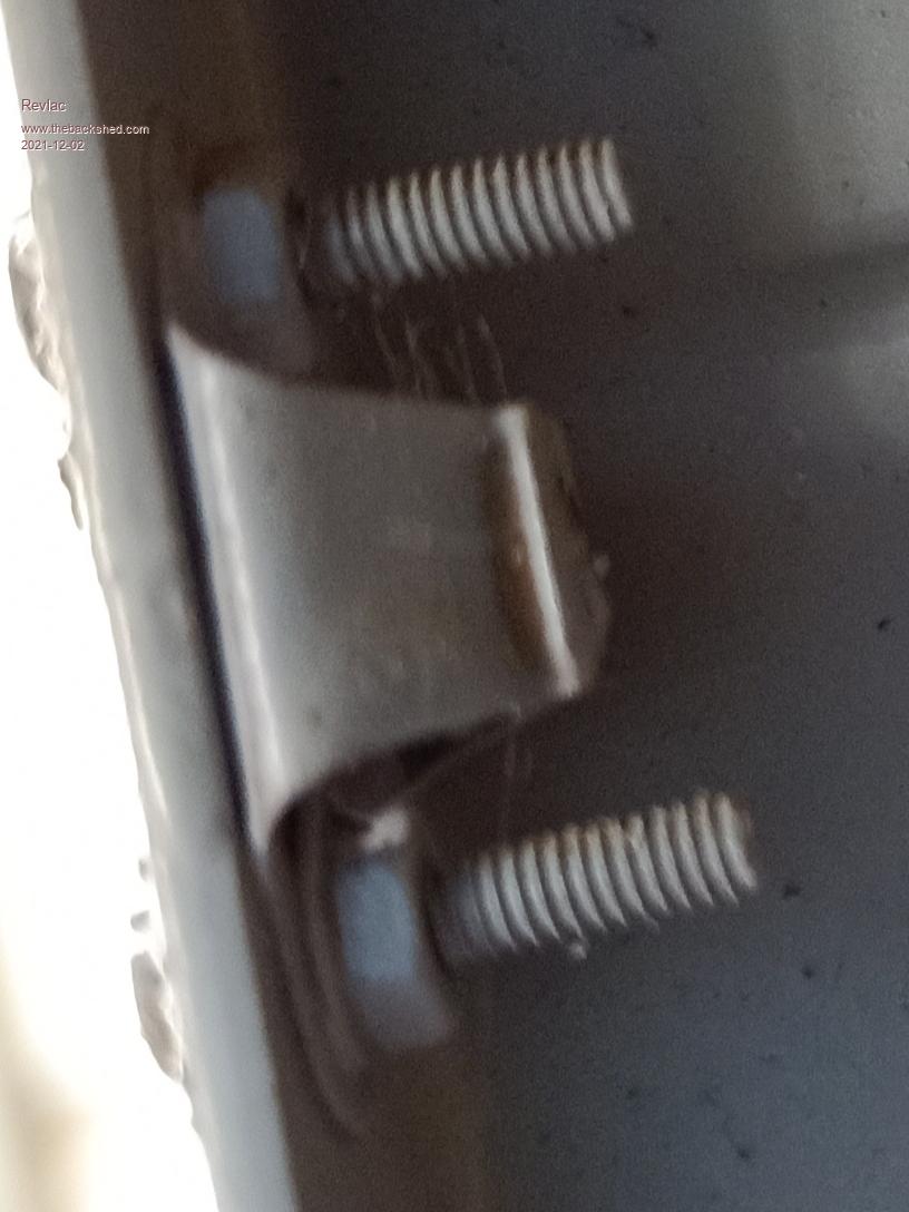

Think they are related to DZUS FASTENER or DZUS screws?
This is out of an Ericsson, has a rubber ring that stops the screw falling out, could use some small rubber fuel line, might do the job.
Inside the cabinet.

Thanks Aaron.
I thought you would know, .  I will cut a small piece of tube and slip it over the end..  I thought I may have misplaced whatever they had ,,, but thinking again --- maybe one ,,but not the 4 of them , so maybe there was nothing there.
