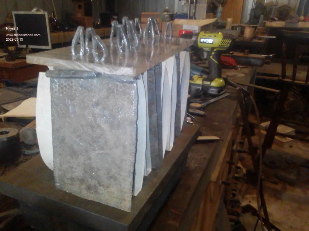

Ok for a bit of fun I made a single cell battery making 2 plates 170x270mm and used some 1/4" lead wire to go around the lead plate to support the plates and provide the connections.
For the electrolyte i used a pool floculant with a ph of 3, now i have converted old N70 batteries using this and they just keeping on.
To form these conversions first we have to use baking soda so we can neutralize the acid. Do this until when the baking soda doesn't produce bubbles which will prove the acid is totally gone. Then wash out several times to get all the baking soda and add a concentrated solution of the pool flocuent.
I just left the batteries with 20 watts of solar for 2 months where i found the voltage was 16 volts. So i put the battery in my tractor and it started it on the first kick. I now use the 2 batteries I converted to power the fan on my listeriod and after 4 hours of running they go down to 9 volts under load and when the load is removed they go backup to 14 volts. So to finish this converting old N70 batteries are a good option as they only last 5 years and with this conversion another 5 or more years can be had.
So back to this single cell battery this morning I drained the batteries then took them out and washed them in rain water and left them in the sun to dry.
Well when I reassembled the battery using 34% sulphuric acid I put  so i put that my meter across and found a voltage and when I put the reduction motor across it worked down to 0.4 volts. so I put a length of nichrome wire across and found the volt meter did get down to zero volts   took the wire and found the voltage went back up to 1.1 volts.
So with the new electrolyte added I'll leave it for a week to just see what voltage it gets to as this single cell is saying it has life.

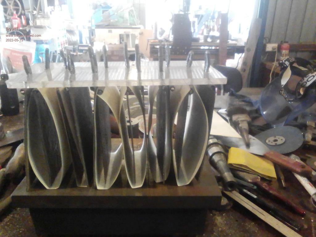

By forming cells in a mold to suit a certain size is matter of making a mold and using a pre heat so the lead flows to through the whole mold.
This would be an easy job on my cnc and hopefully a fixed 32 bit computer will turn up then the fun can begin.

Hi Bryan, just wondering if you have checked to see what ampere hour capacity the rebuilt batteries are?
Sounds like quite a bit of work to pull N70s apart and rebuild them.
Are you replacing the plates inside with home made plates?
Or are you just replacing the electrolyte.

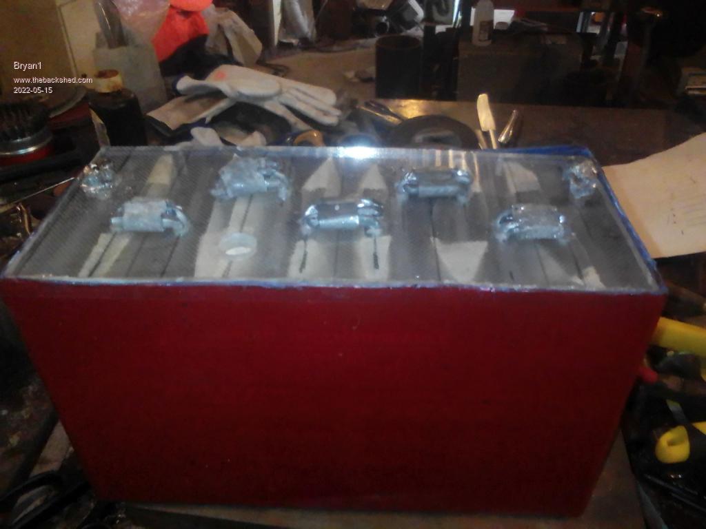

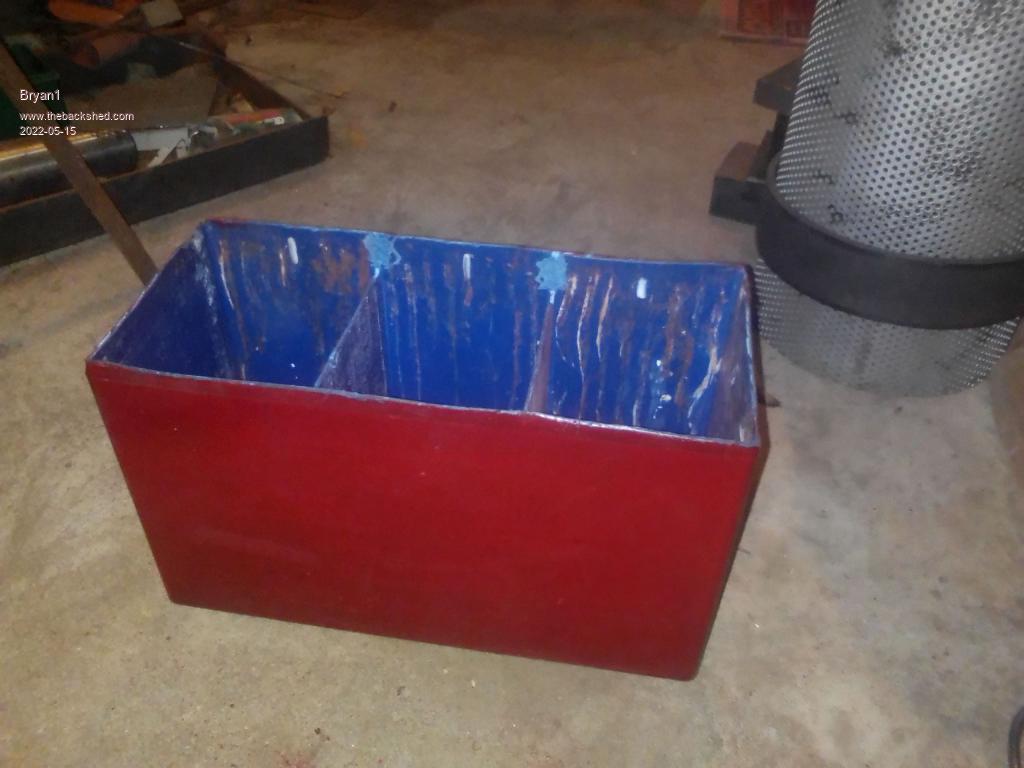

      I still need to source some MEK for making a bigger container so I can put more cells in to make a 12 volt battery then the main test will be my shed radio which I leave on 24/7.

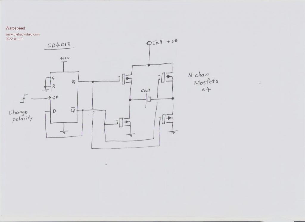

O/k Leslie, first part of the puzzle, a battery cell sex changer that swaps the cell around so we are always dealing with the positive end with respect to ground.
Its just a simple bridge circuit with four N channel mosfets. The mosfets can be as large and as many as necessary (perhaps with heatsinks), or really small for initial testing.
As the "cell" will always be at less than 2.5 volts, if we drive the mosfet gates with a much higher voltage such as +12v, we can connect all our gates directly to a flip flop which really simplifies things a lot.
The flip flop determines which end of the cell is grounded, and which end becomes positive, for the purposes of both charging and discharging.

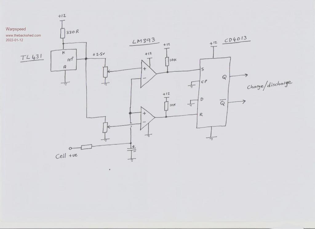

The next part consists of a stable 2.5 volt regulator using a TL431, and two potentiometers to set the max charging voltage and minimum discharge voltage. A multimeter direct onto the pot would be used to set the required voltages.
A couple of voltage comparators toggle another flip flop to either the "Charge" or "discharge" mode.  The discharge load could be a simple resistor or something a bit more complex such as a constant current load.
Charging circuit can also be simple or complex.
The charge/discharge flip flop just cycles back and forth between the two set voltages.
That can toggle the sex change flip flop so it goes through a charge discharge cycle, then changes sex before going through the next charge discharge cycle.
Its not a complete circuit, but just a concept. I think something quite simple would be well up to the job.

Posted: 05:26am 13 Jan 2022

One thing to note about the sex change circuit.
You must discharge the cell to less than 0.5 volts before inverting the polarity, if you don't the inverse diodes in the mosfets might be a problem.
Also when reconnecting a fully charged cell, it must go in the right way around or once again there might be a problem diode right across the cell that causes a high uncontrolled discharge current.
A simple fix would be to fit a couple of red leds connected to the flip flop to show which cell terminal is currently the (safe) positive side.

After a couple of weeks I changed to acid and if you go and read Clockmans details on making abattery you will learn by discharging the cell first is the key.
As the lead plates naturally hold a voltage it did take a couple of hours under charge for the voltage to reverse and on looking last Sunday they are back to 2.56 volts with the solar disconnected.
So this weekend the smae thing will happen, put my reduction motor and nichrome wire on as a load and leave it until under 0.4 volts is left. Then just before the sun hits the panels reverse the connectors and this will complete one full cycle.
I do have a lead sheet 450x900mm so I do need to workout what measurements to cut so I can make a 12 volt battery as the end goal is a battery replacement for my old Nife nicad batteries that are now more than likely over 50 years old and are too tired to run my shed radio 24/7.
To charge this 12 volt battery will be a 20+ year old 80 watt solar panel that still puts out the rated current so doing a bit more research and logging the dimensions, weight etc we can then workout the AH rating.
All good fun
Cheers Bryan

  Warpspeed said  I suppose it depends if you are paying for the power.
Costs nothing to heat up a resistor.
If you are sucking power from the grid to discharge your cell, it ain't free.
I'm a little dense, so bear with me... Isn't it the same thing? The total amount of energy is the same whether you discharge through a load or if you reverse the polarity against the charged cell.
Scenario 1): Put 10 joules into a cell. Disconnect power. Discharge 10 joules from cell. Apply reverse current. Put 10 joules into cell. Total energy from supply = 20 joules.
Scenario 2) Put 10 joules into cell. Reverse current. Current is doubled because cell and power supply are in series. 10 joules dissipated as heat in FETs. 10 joules absorbed by cell. Total energy = 20 joules.
