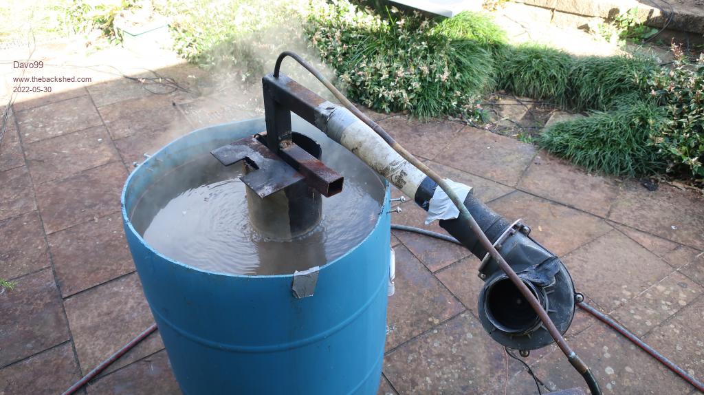

The idea is to sink the main 6" tube in a drum of water, probably a metal 44 or an IBC which will be insulated and circulate the water though a radiator in which the hot air is draw off and ducted into the house for heating.
The thing will run on waste oil so be nil cost.  It can get to -5 where I am and the place having more single panel glass than walls is a thermal efficiency nightmare.  Based on calculations I did last winter, I reckon I need around 10 Kwh to keep the whole place warm and heat soak it to keep the temp even and get everything in the place cosy.  This burner will do that easily and can be turned down as needed.
The upper limit with the little blower I have is about 30 Kw atm.

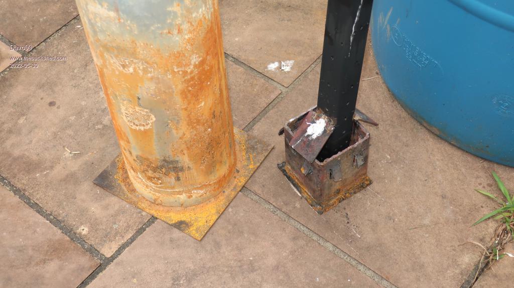

The burner is essentialy 3 parts. The main tube which acts as the heat exchanger, the flame holder which being isolated from the cooling effect the main tube experiences will get hot, hopefully glow red to burn off all the carbon deposits,  and the air/ Fuel tube which as name implies, takes the air and the fuel down into the burn chamber and spreads the air through the main tube for complete combustion.
Parts can be seen in the pics. There is also a pulse type fuel pump which is controlled by a cycle timer and a 12V Bilge blower.
I knew because the main tube would be cooled by the water and run way under the 600OC minimum I wanted, I would have to have an insert that was not cooled and tried a couple of different things like a stainless steel bowl and different configs of the burn chamber. I had the air holes in the down pipe a bit small in the lower region so opened them up for more air turbulance.
I finally cut the windows with the little flaps to direct flame back down onto itself and keep at a temp that would vaporise the oil and burn off the deposits.
This is critical because over a period of time, and not a long one with this small a chamber, the deposits  from the oil would build up and block it. About 600 is where the carbon burns off and a chamber self cleans.

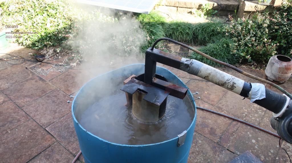

This morning in single digit temps I decided to give the thing another fire up ( most appropriate day so far this year here) and see how it went.  Surprisingly well would be an appropriate term.
Fired up easily and with previous fuel settings on the timer board running the pulse pump,  I had the 200L Drum of water boiling in just under 90 min!
That translates to more than 15Kw of energy being imparted into the water. That is with the drum uninsulated and the water evaporating on the boil which also takes a lot of heat energy away.
This tallys with the fuel burnt which was around 3L. It would take about 22Kwh of energy to boil the water without losses so I'm pretty happy with about a 50% efficiency ratio in this very rudimentary test setup . Even commercial wood fire heaters are lucky to get about 70% efficiency and I know I can probably get this up quite a bit more with some disruptor's in the chamber to swirl the air more  and maybe even a heat exchanger on the exhaust gasses.

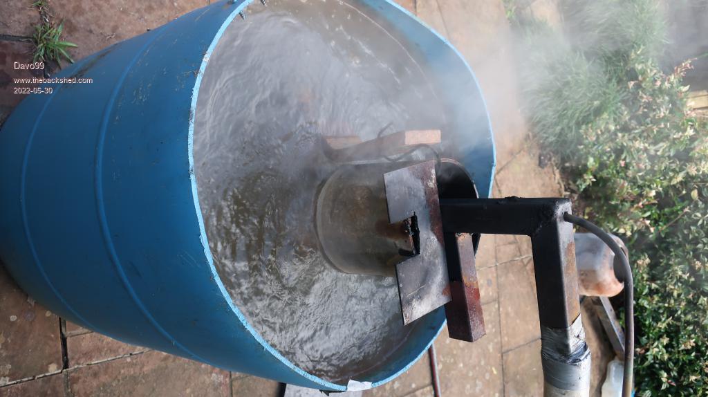

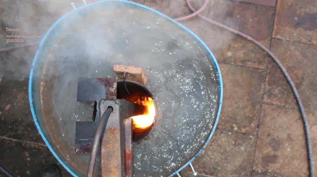

90 minj flat and I had a rolling boil on 200L of water. Perfect! could get it to an hour or less I think but old story, efficiency would go out the window.

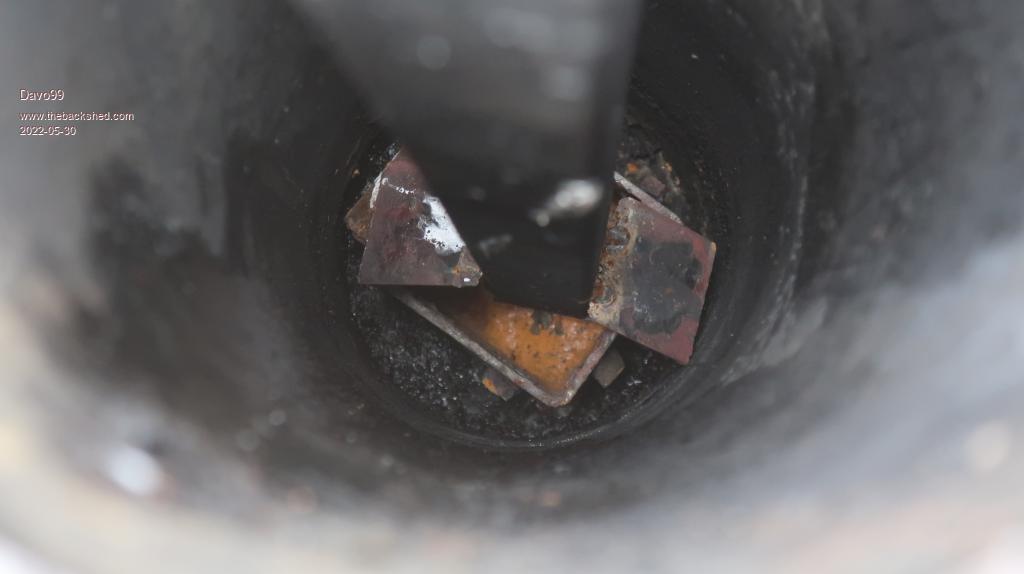

Quick shot before the camera fogged up looking into the burn chamber with teh flame at the bottom.  The heat transfer isn't bad because the bit of the tube that extends out the water flashed to steam any liquid it touches and soon recovers again.
version 2 I might get a bend and duct the exhaust through some smaller metal and back down again through the water to extract more heat.
The burner was a bit of a challenge to get right with the air holes, I was being too conservative trying to work off another design. Going back to what I thought and knew.

How do you start this burner Davo? throw a match down that hole ?
Also, what's the purpose of that 'thing' hanging from a S hook on top of the tube?

  Murphy's friend said  How do you start this burner Davo? throw a match down that hole ?
Almost!
I run the pump a bit to get some oil in the burn chamber.
I then get some metho and power that in there and then light it from dribbling it down the side of the air tube.  I think in the final setup I'll have gas in the fuel tube and could probably drop a match or a lit bit of paper and then turn on the gas and preheat that way.
It's an old tow hitch. It's just a counter weight  to keep the thing stable with the weight of the  blower hanging out there.
The thing has a bit too much buoyancy in water although sitting out the tank on some bricks it's fine... which it's also sitting on in the tank to stop it potential melting the plastic.
When I put it in the 44 which I was working on today, I will cut a hole in some metal and slip the tube through then tack weld so it is supported and can't go anywhere.

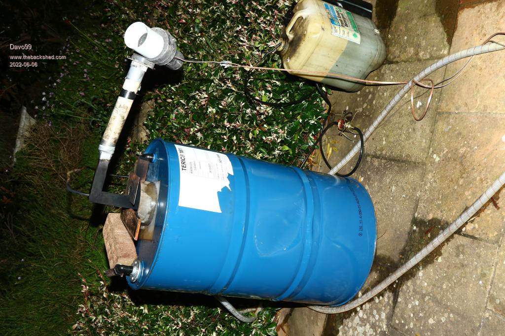

I intended that yesterday but despite having about 150 various plumbing fittings, of course I never have the ones I need for a particular Job.  I buy the things all the time in relation to my oil proclivities but I don't know where the hell they go? It's not like I'm selling things I make from them but no matter what I buy, always got to go get more. So many time I have bought the wrong sizes  and a heap of them and thought " I'll have them till I die" and then weeks later, I'm going back for more cause I ran out.  Does my head in but anyway.
I got a metal 44 and somehow managed one of my neatest plasma cutting jobs ever and cut a square in the top to drop the burner it.... which I forgot I actually made from a short piece of Pipe I had and is shorter than the drum but a couple of bricks under it which won't hurt and it was nicely just above the drum.  I will cut another plate and drop that tight over the burner to secure it and then won't need the towbar for Counter weight.
I was going to start on insulating the drum and thought no, I'll run the thing first, see what I missed and then to that. The grand idea was to do this in an IBC so I could heat that and have plenty of reserve capacity. I can run this to boiling and taking the water down to about 30 for reasons you found last year Roger of anything below feeling cold in blown air, I still should get around 15 KWh or so which might be OK given I'm now thinking more or less constant run time.
Back to the irrigation supplies this morning which turned into  lets drop into the shopping centre for a Coffee and we got home at after 4 with a load of stuff we never went for.
Anyway, got what I needed to finish off including some little short clear pieces of Vinyl hose to slip over the 5/8 Fittings on the heater core to make the 3/4 Hose I'm going to use a much tighter fit.
I was procrastinating what hose to use and looked on market place and in a great stroke of luck, someone not too far was giving away 20M of the reinforced hose with fire fittings on it.  Contacted them,  happy to give it away, didn't want anything for it, will leave it at the front gate.  The direct way was blocked by a land slide so we took the definite scenic route.  Not far from us but the terrain and landscape! Oh my! was worth the trip just to see whats in our own backyard we never knew of.

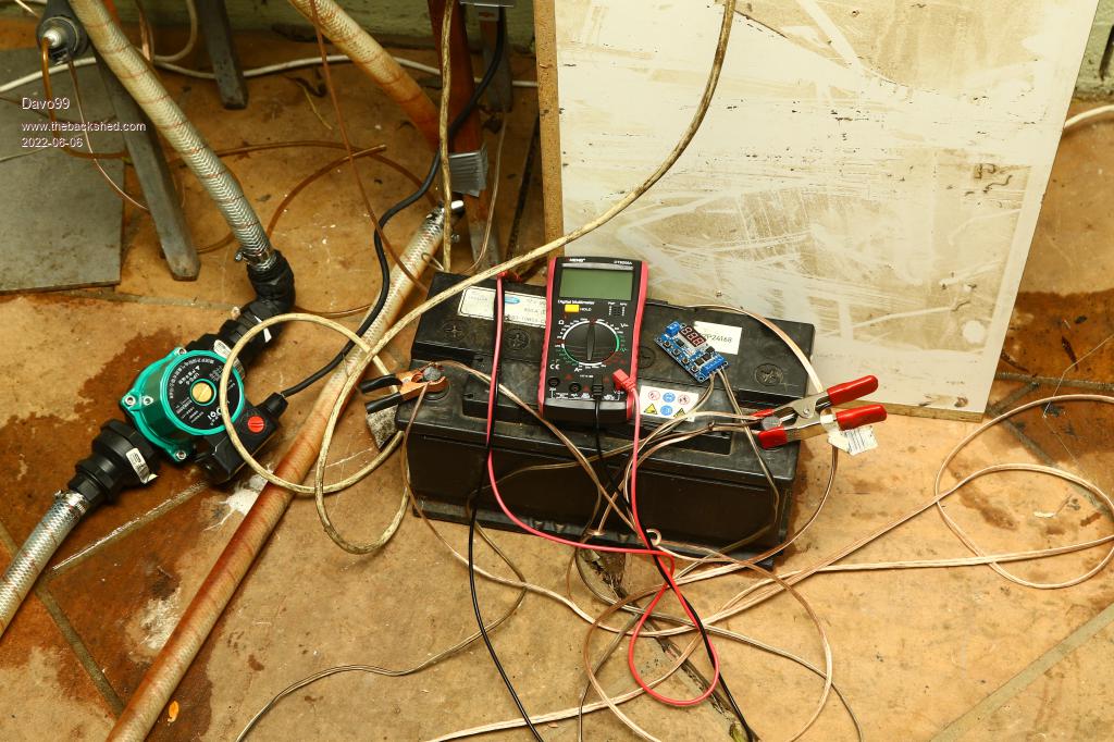

Came in this evening and was procrastinating if the blower and heater core I have will do  enough output. Spent some time looking on the net for heater units  that would look neat and I could just hook up the water and power to and be ready to go.
Was aiming for about 35K BTU or 10 KW and found a 30K BTU and a 40K but the price was very steep and of course have to be brought from the US.  The unit price I might even wear but the shipping is Effing ridiculous as is anything from America for whatever reason.
I then looked up motorcycle radiators and was doing the mental arithmetic of what the engines on those put out and aimed  high and found some suitable I could build into a box and would certainly dissipate the sort of energy I need.
I kept thinking back to all the times I have had a heater going flat out in a car and the heat they put out and thought they must be getting close and I want to get this thing running so I then went back up and got the core and the blower fan I have and Siliconed the 2 together so they will be ready to fit up tomorrow.
I decided to plumb in the pump just before the heater so it will be out the weather as I'm going to sit the burner  out away from the veranda and then run the wires and pipes out to it so everything is under cover although I will build a cover to keep the water out.
Exception might be the fuel Pump.
The other night when test running I changed from engine oil to veg and listening to the thing in the office here< I  could tell it was running lean. Went out and the veg being much thicker than the WMO and not processed at all was  very thick and the little pulse pump was having trouble with it.  Thinking I may bundle the fuel how with the water hose's so there is some heating of the oil and locate the pump that side so it's warm and thinner and easier to pump.
I added some more Tabs on the air tube further up spaced apart and cocked them at angles to try to induce more swirl  to brake up that boundary layer.  I think this will give some compression lower down in the burn area with the expanding heated gas  and just make the thing a bit more efficient as well.  I also enlarged the secondary air holes below so that should help too.
The burner ran like a demon straight off but took a little more heat retention than I anticipated when I submerged it.  I haven't seen anyone on YT or the net do this yet so another first.
So the plan is tomorrow to plumb it up Bring it down where I want it and set it up and see how she goes.  The only way I'll be able to measure efficiency is to see the inlet and outlet temps from the heater hoses and see how the temp in the tank drops and what fueling rate I'm giving it to sustain temps.

Well I was EXTREMELY frustrated today with the thing. Wanted to be the day I started heating with it but got unexpectedly undermined.
To keep it short for once, I underestimated how stiff the 3/4 Hoses are I have to take the water from the tank to the heater core.
Also, what I thought was my diligence and effort last night going back out in the cold to silicone the heater core to the blower, was more than a waste of time.
For whatever reason the silicone didn't go off so the core fell straight off the blower housing and I had silicone going everywhere.
Thought I'd wire it on and spent like an hour looking for my tie wire and couldn't find that, eventually found some other crap and sort of attached it with that but the hoses are so heave and stiff, I couldn't sit the thing where I wanted it like I naively thought.
I'm going to have to build a whole housing for this and  pretty much plumb it like Copper, made to fit .  Course I didn't have any joiner elbows to do it and a work around with the ducting using the 90mm PVC on the blower didn't work cause I couldn't find the box of connectors and elbows I know I have for them Either.
I really underestimated and dropped the ball on this part.
I was going to fire the thing up and just run it to see how much heat I could get out but by that time I was too tired physically and disappointing mentally and it was getting cold so I left it.
My ideas and ability to work things out are far better than actually constructing and practically allying things.... as usual.
be another trip to Bunnys or the irrigation stuff for MORE damn fittings.
I'm wondering if it wouldn't be better to do it in PVC because then at least I could make it so it sat in place where I wanted it and I wouldn't be fighting the weight and resistance of the hose. Wouldn't need to spend $50 in hose clamps and be stuffing with them either.
Anyway, let myself down with the simple plumbing that I should have given much more forethought to. Maybe spent too much time running wires and not thought enough about running pipes.

IT"S ALIVE!!!
After yesterdays Disappointment I managed to get out today and get the bits I needed both for a rough test and to make something more permanent.
The upshot is it's certainly going to be viable.
The back room is toast warm right now and in a few hours running I already know what I want to change.
The pump is good and flows plenty of water. The burner is keeping up although maybe obviously, needs bit of a head start to get up to heat.
The weak point appears to be the heater core and maybe the blower.
I don't feel like I'm getting enough temp drop in and out of the core but the whole core was not getting air pulled through it so that may be a part of the problem.
I started with the 12V blower for a car but that pulls fairly big amps and while warming up the water tank, realised that every decent 12V power supply I have has crapped out. As I was worried about the battery dieing, I placed my 240V tube han on top of the core to blow through the core and through the blower fan and got nearly the same output.
I'll modify that setup tomorrow and put the core in front of this blower and draw through it and I think I should get an even better result.  I'll need to make up some sort of flange to adapt the square core to the round fan but I may be able to get away with just manipulating some flexible Duct I have.
In the end I used the hard stiff hoses to hold the core in place and used a little square framework I built years ago and has been so handy for all sorts on mucking around and taped the hoses to the legs to hot everything in place.
I'll Undo all that tomorrow!  :0)
As I knew, once warmed up, the hose is soft and flexible and easy to manipulate. Maybe should have fired the burner and sank it in to work it in the first place.
I'm still not sure about the heater core.  It may be that I need to go to a motorcycle  radiator but I am suspect on the core density and if it will deliver hot enough air.  Seems the radiator core is thick so the air temps stays up, the bike core may not do that but OTOH, may just be a case of slowing the fan speed down and there should be loads of leeway.
It's all rougher than guts atm but it IS working and getting it running was the first criteria and I have learned from that already.  I think convert everything to 240 and probably run a 12V power supply for the burner blower and the timer/ fuel pump.
The main blower will be better off mains and I can always use an inverter in the event of a power outage although I'd have a genny for that anyway.
The heat output is good but I do want it better and the  tube fan I think will improve on that. How Much remains to be seen.
In writing this I had a rush of blood to the head. Went out and put on the tube fan and the blower.
Oh My! That did the trick! A HUGE amount of hot air that never backed off.
Seems like my problem is air flow though the core. The tube fan un restricted may cure that and going from a 90MM pipe to a 250 Won't hurt with the reduction in back pressure either.
The extra wings on the air tube I attached seem to be working as well.  Even with the uninsulated drum and the blower pulling a 25o temp  reduction out out of the water, the drum is at vigorous rolling boil now at lower fueling settings than before.
The place is definitely warmer. I have a spot on the wall I shoot temps for consistency. I try to aim to keep the place at 19. It's 22 Atm and I had the AC on fan to distribute the heat. My office here which I normally try to keep to 19 with a ban heater on a PWM controller outputting about 700 W is also sitting at 22 and no heater has been on all night. Happy with that as I know I'm not near full heat output and there is so much more I can do.
I'll do some mods and see what sort of output I can get tomorrow.   :0)
