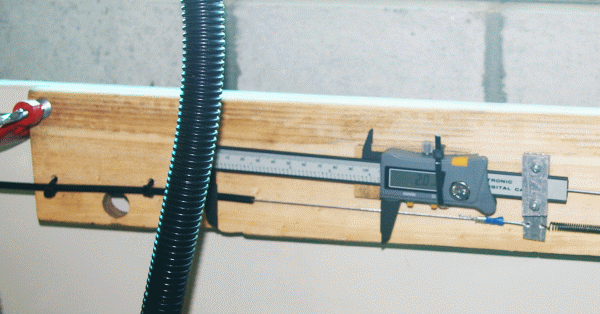

Seeing as so many BackShedders have lathes and are open to innovation.
I have just tested a concept for a poor man's DRO!
The "display" cheap plastic digital calipers from Duck Smuffs.
The business end! Two bike cables connected to the cross slide, one cable has the outer anchored to the front of the apron and the cable loops under the lathe to come up the back and connect to one side of the calipers. The second cable has its outer anchored at the back of the saddle beside the flexible chrome coolant tube and is routed to the other side of the calipers via a fairly tightly tensionsed spring.
So you can see what happens, as the cross slide moves one cable is "pulled" and the other relaxed which together move the calipers.
There is no discernable backlash when the spring tension is tight but the cross slide handle has a 'nicer' feel when the tension is relaxed a little.
I fully expected the flexing of the cable would cause an error, and it does, but only 0.1mm moving the carriage from one end to the other.
I tested it out by measuring the diameter of the work, setting the tool in contact and setting the calipers to zero, I then reduced the diameter of the work by 2.5mm according to the calipers and sure enough measuring the new diameter of the work showed it was precisely 5mm less than at the start. The calipers of course indicate a change in radius, not diameter. Winding the cross slide back and setting the tool against part of the original diameter showed zero, bonza!
OK, these are crappy calipers, but they are cheap! The cable system no doubt introduces some errors but these do not appear to be significant compared to the 0.1mm resolution of these calipers.
Stopping cable flex and increasing cable tension would make it more accurate, I think. Mounting the display on the saddle and using very short cables would also improve things.
[This really is proof of concept, I have some cheap DRO scales ordered and when they arrive I will probably mount them on a panel fixed to the saddle and right beside the black lighting fitting that shows in the pictures, they will be much happier there than screwed to the side of the cross slide getting swarf and coolant drips on them.]Edited by KiwiJohn 2009-01-25

                 very creative and practical.I usually use dial indicators but they have limited travel but good for incremental diameters.Your system could be further refined if a quick release was attached to the caliper clamp and the cable exposed for attachment of caliper was longer.It could then be engaged at any point along the cable.Having been the former proprieter of a cycle shop,used the gear cables that were designed for the index gearing systems produced by Shimano.The inner wires (Stainless steel) were very good at not stretching and the outer cable sheath had longditudinal wires as opposed to spiral wound ( brake cable) and a teflon sleeve that gave very low friction.An adjustable ferrule was also included for reducing any slack instead of the spring.This would be the next level of even greater accuracy.Well done and another project for the list.
Anthony.         Sorry Gordon I'll try and move it.Edited by Jarbar 2009-01-25

Anthony, thanks for the info on the Shimano cables, that could come in useful. When I do a permanent installation the instrument has 30cm travel so I wont need to change the cable attachment point for the cross slide but for the carriage position I am thinking of a friction attachment then if I forget to move it I wont break anything by running off the end of the scale.
Klaus, the indexing on the cross feed handle is 0.04mm (diameter).

Part of my problem may be that I dont exactly understand how to use the screw adjusters, they just have graduations, no vernier scale, the clutch is very stiff and I have not yet learned to accept the backlash as a characteristic not a fault in the machine!
For better or worse, I have ordered the El Cheapo DROs and I will be mounting them at the back of the saddle and to the right. They will be out of the way there and as they will move with the saddle the cables will be very short and I expect them to be more accurate than my concept proving with the plastic calipers.
