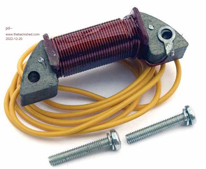

Many of the smaller motorcycles do exactly what you are trying to do.
Thea have a separate lighting coil opposite the coil used for the ignition.
many of them just have a rectifier and battery.
if the lights are not on then the battery gets an equalizing charge.
This is pritty typical of a lighting coil you would find mounted on the inside of a flywheel

Pretty sure it is possible Dave.
So from your description, the coil is on the outside of the flywheel.
Can you provide a few photos of the setup and the existing ignition pickup coil.
  Quote  If so I guess a substantial Cap would be needed to reduce flickering and if there would be enough magnetic Field to generate say 3-6W, what would be a ballpark winding for the coil? How many turns of what gauge wire or is there anything that could be easily adapted and Fitted?
It depends on the strength and number of the magnet/s.
Eg the coil that pd-- showed would be good for 6V 25W perhaps  ...  or maybe 12V 35W  ...  but would vary considerably depending on rpm. And it also would have some substantial magnets in the flywheel surrounding it.
