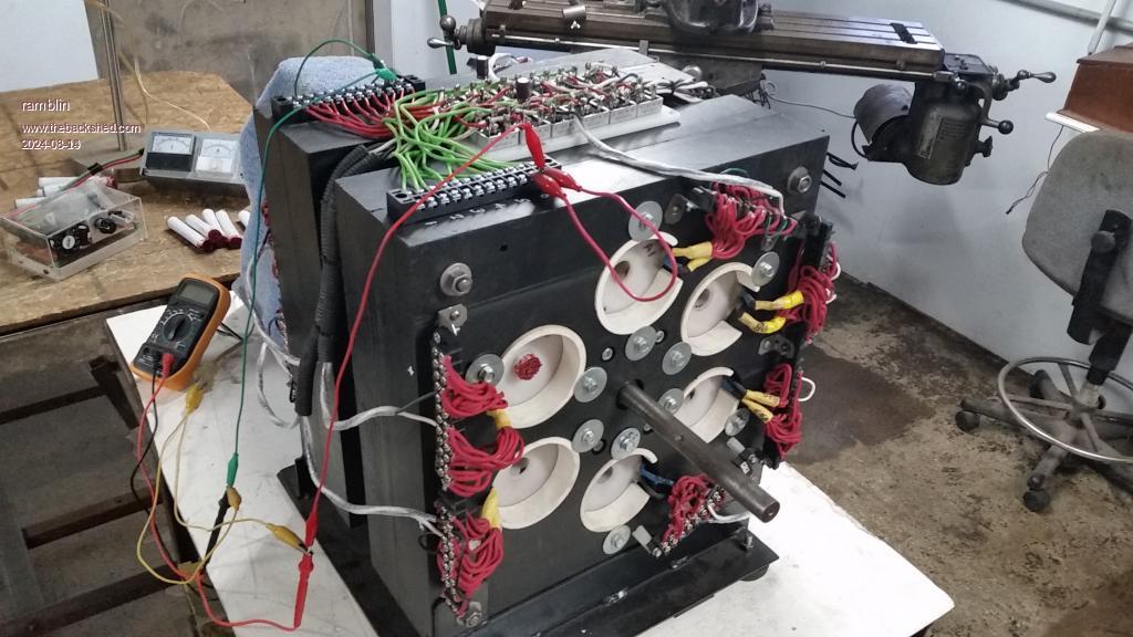

Many here know, with the help of forum members I built an inverter specific for my homemade, neo magnet generator. Works Great ...., having a blast with it ! Hopefully some can help me with another problem. In doing solar, many must be familiar with adding multiple power sources together and the associated headaches involved. I realize right off, this is comparing apples to oranges, but here is my problem in the nutshell. My neo mag "alternator" has 12 coil outputs. I have many coils/core selections to produce many different voltages. I`ll use these simple ones for discussion. A single coil will output 48vac @ approx. 1 amp. Normally I test 2 opposing coils together, as this greatly increases the output. So, ... (2) coils, in series and adding a 5uf run cap will output up to 135vac @ approx. 2 amps under a load of (2) 90 watt flood lights fully lite. Coils can be added in "series" to achieve the required voltage. In most cases they will add up accordingly with some loses. Depending on speed and cap size this can be anywhere from 300 to 500 Hz. So many variables can affect accurate measurements, especially amp readings and precise readings are difficult. So..., adding coils in series works pretty well with some loses,... but adding in parallel is a real issue. In theory, 12 coils should add up to 10 - 12 amps but in reality, I never gets much over 4 or 5 amps. So, while a single coil, (or pair) makes a beautiful sine wave on a scope, add in more and it becomes quite chaotic and always a problem with AC, as with the power grid being a fine example. Now you would think converting to DC and adding a Full Wave Bridge Rectifier to each coil might be an answer. For whatever reason, you can`t use a AC run caps any more before the bridges, so that's a really choppy output right off, but with a 1000uf DC cap at the inverter input you can make it work, which is how I run my inverter. But there is still great loses (amps) and the DC waveform, at the cap, on a scope can appear sawtooth and far from smooth.  Hoping some here can help me figure out how to combine my coil outputs without losing so many amps. I will provide answers to all questions any one has as this is getting pretty long. Not looking for anyone to solve my problems, just some ideas and things to try. Thanks

OK, lets talk about this. I`m happy to explain the inner working of my project. The rotor has 24 neo mags alternating North, South. All coils are precise lined up with the opposing coil on the other side and all coils hit at the same time, North then South, then North est. so in that respect it would be single phase, I guess ?? or 6 phase depending on how you look at it. (or maybe 12). All coils can be independent or as I usually test, 2 opposing each other as long as they are properly connected. Best output for 2 coils is always opposing each other. Otherwise, they can be connected together any way you like (I think I have tried them all) keeping in mind that while 6 coils on one side are being simultaneously hit with North the other side is being hit with South. If you just connect all coil outputs together it will show a perfect sine wave on a scope. It is just messy, fuzzy and hard to keep steady as you would expect it to be. Like I said earlier, there are so many variables to consider. Even a few RPMs will change it all, not to mention that all coils are not perfect, cores may vary a little. Rotor to core distance may vary slightly. This is a big one as this can greatly change the voltage output. Even if a core vibrates a little inside a coil it can cause a wild spike. Now consider that with neo magnets this machine creates a lot more "reactive" power than most gens. I said on my inverter thread that it is prone to wild mood swings. Thats because just about anything you add to the circuit causes unexpected effects. Especially caps. You have to watch caps. I have blown untold multimeters and light bulbs. Sorry to rant, but yes, I expect there is phase shift problems and lets not forget is all running at about 300 - 500 Hz. Help me sort it all out because it can be an incredibly efficient generator. Opps, alternator. Sorry

The alternator you have built seems very complicated. It seems to me that using a normal three phase electric motor and turning it into an induction generator would been much easier.
I don't understand how your alternator is producing sine wave outputs. Usually the pole pieces have to be shaped with a curve on the edges to produce a sinewave.
It is hard to see but it looks like the white cups with the bolts are where each coil sits.
So maybe you could try connecting the coils so that they alternate, so One coil north on one side connected to the next south coil in the direction of rotation
Then continue on like that.
Unfortunately I am used to working with electric motors and alternators that are designed totally differently.
Sorry I don't have the answers you are looking for
Pete

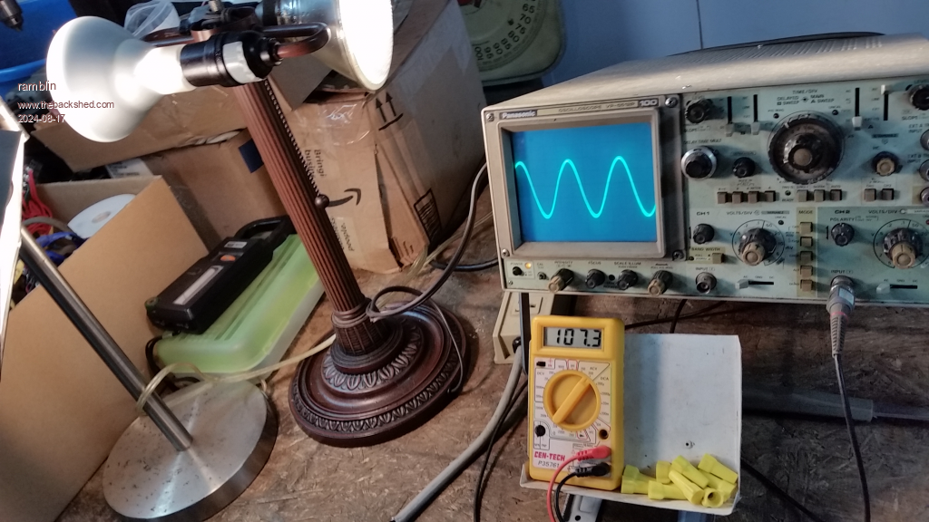

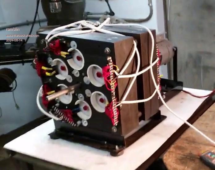

Maybe a few pics will help. Here 2 coils are connected as you describe and the resulting output and scope shot. Load is 195 watts. Also a few types of coils I use. Doubt you can see the settings on the scope but were approx. 550Hz.

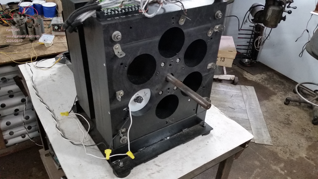

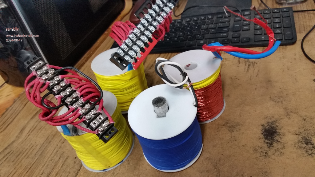

Sorry for the delay... We been having some internet problems . Try these..

The first question to ask what size motor are you driving with ? as reality really does bite as the output power will always be less than the input power.
Posts: 3417
Posted: 07:19am 17 Aug 2024
What material are the coil cores made of?
If solid iron the efficiency will be low, if powdered iron the cross-section seems too small compared to the diameter of the coil.
There doesn't appear to be a laminated iron yoke to complete the magnetic circuit between the free ends of the cores.
Conventional generator designs are the result of almost 150 years scientific research and engineering development by many thousands of people. This has resulted in reliable, predictable and energy efficient machines (98.7% for the biggest ones).
I think it will be difficult to achieve stability and efficiency with this design.

You are correct, iron is not efficient and causes a lot of drag. Core material is what we have researched the most and is a key factor. I have experimented with the iron yoke with little results on this machine. It played a larger roll in my early designs when rotor mags were all N on one side and S on the other. Now you are correct, stability has always been a big issue to overcome. Efficiency, however, I would argue can be very high. Conventional it is not and one of the reasons I picked up the project. Neo mags are remarkable things and are becoming stronger and more affordable. Many experimenters are playing with smaller, slower versions of this and having great results. I`m told this is has been employed in experimental windmills (might be why I see so many burn to the ground). I thought this project might be of some interest to the windmill guys here. My biggest issue lately has been combining the inputs and getting all the available amp out of it. Really need some guidance there.
And besides, wheres all the fun in conventional !

OK, here is a test I just did based on phil99s reply:
I have 6 low power coils that are all the same. Each one produce about 53-54VAC @ about an 1 amp. Connected a FWBR to each and then connected all in Series and installed in the machine. Now I can add/remove each "core" while running and effectively stop output. Now all 6 coils are connected in series so there is some resistance. But a single core placed in ANY coil will output approx. 33-34vdc. When a core is added to each coil it will add up accordingly to approx. 210-215vdc, slightly more than you might expect. NOW, add a 500watt heat lamp as a load. With 1 output and a DC amp meter will show 1.2 amps. Add in all 6 outputs will show only 1.6-1.7 amps. The bulb will only glow slightly more orange with all 6 outputs. This test was done without any DC caps added but from experience, this would greatly increase the voltage. I would expect the 500watt halogen would light brightly (even DC) or maybe even blow. This is what I am seeing.

Looking at the photos I can see a shaft
I assume inside the box is a disc with magnets attached
If this is correct and you connect all the coils in series the induced currents will all be out of phase'
re 2nd para If you have two coils in the machine and they are correctly polarised you will get 120 v on each ie 240 v but still 4 amps
When you put the other 4 coils in the machine you will get the same voltages but out of phase by 120 deg each This does not matter when you rectify the 3 outputs
I am surprised that you get 4 amps as the magnetic field is not closed.
If you look inside any induction motor or alternator you will see that the stator has a magnetic core and so has the rotor and a small air gap between the two .
To get this to work you need to close the magnetic path to approx 1 mm
If you try mild steel you will have a lot of losses due to eddy currents generated by the ac and put a lot of load on the driver . In motors and generators the magnetic field comprise of laminations of electrical steel. these are 12 thou thick and insulated on each surface to block eddy currents

Ok, things that might help:
If it's a single phase alternator:
* Check magnets alternating N/S
* A little shifted angle is to be expected, so this can lead to voltage loss.
* Match your load, it might be to heavy causing the voltage to collapse, little bit like a solar panel or current source. Put some resistors in series with the lamp to search for a maximum powerpoint. Idealy you could do this with one coil and a variable resistor for example. Then you should look at the voltage and current meter not at the brightness of the lamp.
* Wire your phases in series, but keep in mind the polarity, you can put them in series and in theory they give 0V. Winding direction need to be the same, otherwise turn around or swap cables! But you might know this already
* The biggest point, others already pointed out, is the magnetic field is not closed, and while this works for relatively flat coils and low power, your coils are really big/high, only a limited part of the coil will induce the strong magnetic field and create power, so you loose a lot of potential their, the rest of the coil more acts as resistor.
(edit: ok, forgot you put some kind of material in the coils as well, but still...)
You can experiment with a less high coil to verify/test find the optimum point. You can add an extra plate/rotor with magnets wich would greatly improve your design and close up the magnetic field.

Thanks again nick for some very important info. You seem to have a good understanding of what I`m doing here. The points mentioned are all high priority and must be followed exactly. Polarity and especially winding direction must be adhered to or everything fails. I had an early machine with a different rotor configuration with all north on one side and all south on the other. Closing the magnetic loop was critical to getting any real output. Very difficult to build and never got around to making it out of laminated. This machine however, with alternating North and South design on the rotor has made very little if any difference so I gave up on the difficult idea. During construction attention was give to "perfect alignment" and all coils are struck at precisely the same instant so being in phase has not been an issue.
The main point you hit ..."the coil acts more like a resistor" seems to be exactly what I am experiencing. Its worth noting since I started this post that I have been able to somewhat overcome the problem by adding a small isolation transformer to each pair of coils. This had indeed produced a full 4 amp output from 2 pairs of coils !  Seems like a long way to go but results were truly amazing. There must be an easier way to address this and I can`t be the only one that ever run up on this problem. After many yrs. of testing various core materials and coil designs and connections I have concluded that 1.2 amps per coil is max to expect so I am very satisfied to get 2 amps per pair and can do a lot with that. Now getting them to all play well together has been the real challenge. I`ll be sure and check out  the link. Seems like a lot are working outside the box over there. Thanks !
