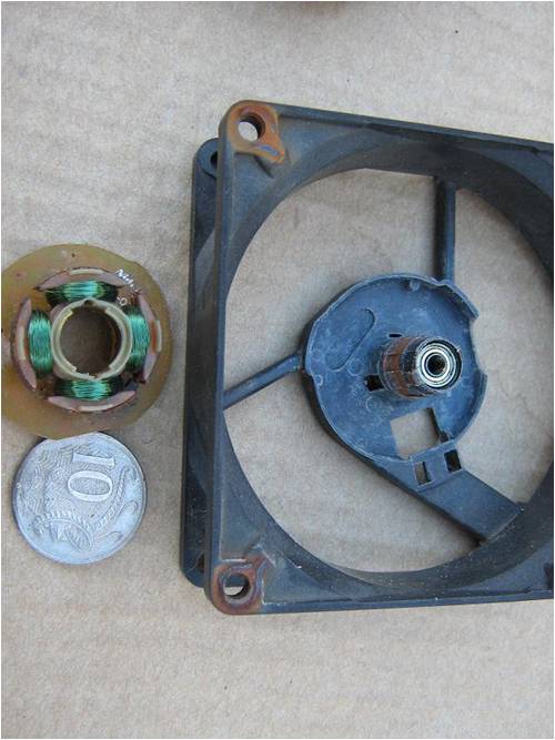

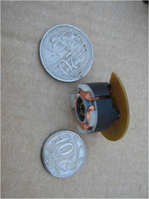

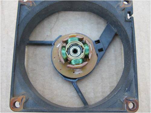

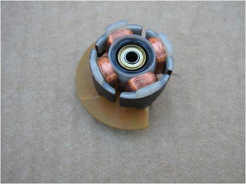

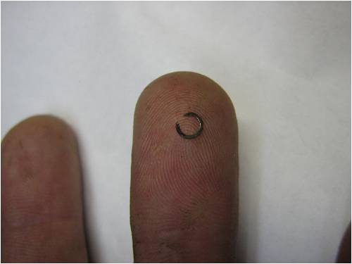

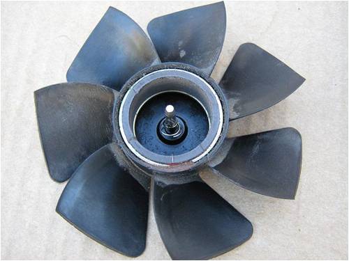

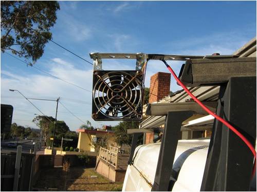

Over the last few days when i had a spare hour or so i had a play with a fan from a computer power supply, 75 mm dia. fan. 80mm overall case size.
They are a difficult little thing to get apart without destroying them.
The first 2 i tried, i wrecked them getting them apart, by the 3rd one i had worked out how to disassemble them, but still not an easy task.
Once all disassembled the circuit board was removed leaving the 3 pins that the phase windings are attached to.
3 wires was soldered to the pins and the fan reassembled.
2 diodes were attached to each phase wire to form a 3 phase rectifier.
Holding the fan out the window and driving at 100 kph the fan produced around 20 volts unloaded.
With the dc leads shorted it produced around 220 mA and 0 volts.
With a 27 ohm resistor as load it produced about 180 mA at 5.5 volts
At 80 kph it produced about 150 mA at 4.5 volts (27 ohm load)
With a 4 diode shunt i got about 3.2 volt output. (5-6 diodes would be better)
The fan ran better when held backwards to the wind but would not recommend running it this way as all the thrust is on a tiny cir-clip and not the wear plate on the shaft.
In first tests i had the wire mesh grill on the front of the fan but removed this thinking it might have been interfering with the air flow.
It made little difference and was a mistake to remove it as the fan then bit a chunk out of my finger.
All figures are approximate as it is hard to drive, hold a fan and read 2 meters on your lap, hence finger damage.

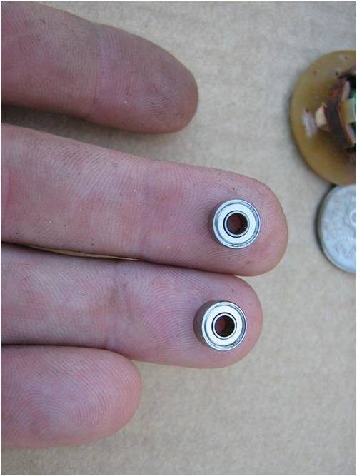

As they are almost free (junk) the bearings probably wouldnt matter that much as you would throw it away every week!

I dont think the bearings would give too much trouble as they have 2 good sets of roller bearings on the shaft.
But then again travelling at warp speed anything could happen.
Over all quite well made little units for what they are.

Karl, some of the earlier ones used ball bearings.... I have never seen such little ball races.

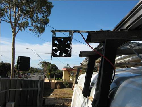

I done some more testing with the pc fan set up as a generator
This time mounted to the roof rack on a van.
This more than likely caused some error in the results as it is like a brick travelling through the air to start with.
Also noticed the turbulent air from any vehicle travelling in front also effected the readings.
The speed was taken from a GPS within +/- 1 kph.
It would have been better to conduct the tests on an open road in a vehicle that had cruise control.
Then repeat the test travelling in the opposite direction to eliminate any wind speed differences. But it wasn’t done this way!!
Rather a brick belting around suburban roads, while trying to read 2 meters and record results switching between open and closed circuits. (room for error)
The wind speed at time of testing was about 10 kph, and I changed direction of travel so many times I can not say how the wind played into results.
The load used was a 27 ohm 5 watt resistor.
The fan was facing forward.
2 sets of test were done one without the wire guard fitted and one with the guard fitted.
It took around 20 kph to get the fan to start. (over come cogging)
The mA reading is only when load was connected (closed circuit) otherwise it was a zero mA reading (open circuit)

A few photos of this monster we are dealing with here.
Great little roller bearings
The retaining circlip to show why i say not to run the fan backwards
