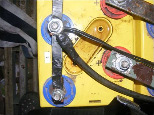

Chris, How about a picture of your batteries, looking down on the top of 'em?
I would think 'fixing' a wet battery's inside is well beyond DIY range.

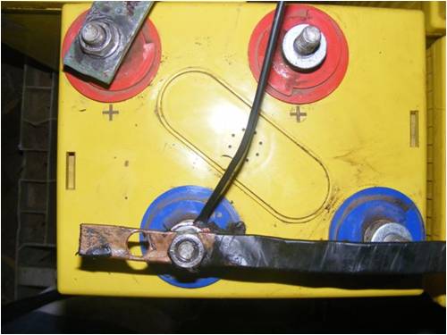

I have never seen iron used for cell interconnects on a battery. I don't see joiners between the parallel strings either.
iron forms a high resistance joint quite quickly. These cells are not designed for cyclic discharge applications. More like a big UPS. Flooded cells need the electrolyte to be able to be gassed, to allow mixing to prevent stratification.
Sounds like you have some problems to sort out.

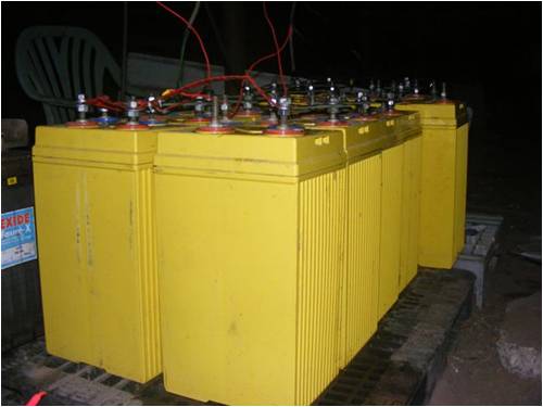

Rippa, as Gordon mentioned above, there is something very odd about your battery connections.
Can you post a picture that shows the whole top of your battery bank so we can see just how you have connected them.
There should be no unused terminals.
With the heavy currents that can flow at a battery bank its bad economy to skimp with the connecting links and wire size/ terminations. Do it well once or fiddle forever with poor connections

i will take a photo for you so you can see how they are connected.
as seen in the previous photo they sit side by side. each row was connected in series with the metal strips and then connected in parralel at either end of the row using copper strip. some of the cells cant be used as the ones that have lost capacity to hold charge and wont make up 12v for charging. (unless i hook them up similar to the way karl has) which looks to be a better set up then mine

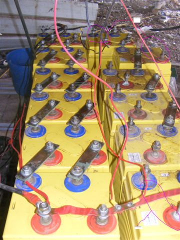

ps. here is the photo of how i have the batteries hooked up

I think you will need to read the plasmatronics manual, on how to set the various parameters. It is available online, if you don't have a paper copy.
You should spend a little more time framing your photo, to give all the connections. We still have to guess how it is wired. The lack of cell interconnects will resusult in potential for cell imbalance, with poor connections in a series string.
This is a 12V setup, so is really only good for a max 300-500W, given the wiring you have shown.
Gordon.
PS: If you think over a 1000W is possible, then you would need the inverter right next to the battery, and it is not shown that way.
