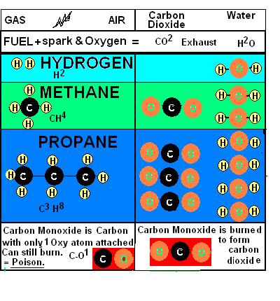

To begin with;
Here is a little show and tell pictorial for various fuels and what the end products contain after the fuel is burnt.
You will notice that Methane(natural gas) contains 1 carbon atom and four hydrogen atoms. Wood, Gas and Oil are the natural fuels of earth, all contain carbon and hydrogen, all must have oxygen to burn and all create (carbon monoxide,carbon dioxide) and Water when burned. The one exception is hydrogen Gas which only forms Water.
Carbon Monoxide is poison. Will give you a Headache and dizziness, will kill you.
Carbon monoxide is formed when fuel burns in a atmosphere containing very little oxygen such as an Engine cylinder with limited volume.C-O. contains 1 Oxygen atom.
A fuel rich carburetor will generate C-O. It is flammable and will burn when oxygen is present. Water gas is a mix of C-O and Hydrogen.
Carbon Dioxide is generally harmless. it is a large part of what we call air, and is only harmful to the planet because it acts like a thermal insulator or blanket surrounding the earth, at night when the sky is clear, the Earth is a giant Stove radiating its heat into empty space, when the quantity of CO=2 increases this thermal blanket prevents the Earth from giving up the heat that the sun has poured up on it. The oddity of this is, only infra red light is blocked, the light from the sun penetrates this easily but the radiant infra red cannot get out( Global Warming).
Now, Instead of burning more Methane from the Gas Wells and making more CO=2 we take the CO=2 that already exists and water that already exists then make a gas that is equal to Methane and burn that to Water and CO=2 Replacing what we used but not adding to it.
