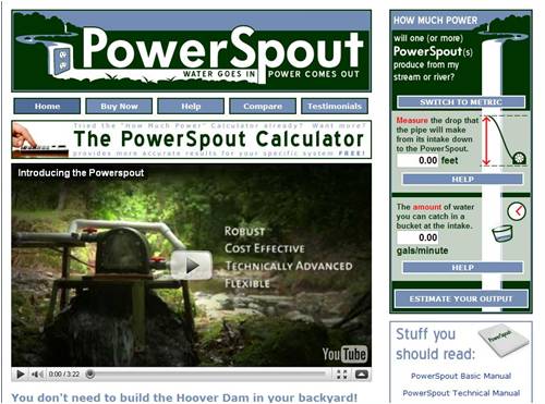

EcoInnovation Powerspout Web site.
http://www.powerspout.com/[/URL]

Incidentally guys, I did not know the Powerspout site existed and did all my initial enquiries through their ecoinnovation site.
I was eventually referred to the Powrspout site.
The Powerspout site has since been amended to add the advanced calculator.
They have since modified the page as I suggested to point out that the Powerspout is shipped as parts. Which included in my case, a lot of iron filings in the rotor magnets.Edited by kingull 2010-06-26
