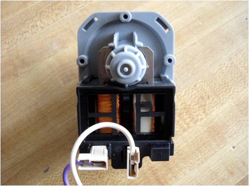

I was cruising down the road last week and spied a dishwasher in someone's trash. Excited to recover the copper coils from the motor, I asked the homeowner if I could snag the motor and he gave permission.
When I took a closer look, the motor was nothing like I expected, rather this is what I found:
It's about the size of three packs of cigarettes stacked together.
On closer examination, I found out it was a PM (permanent magnet) motor, so I was less disappointed, cause this is a ready-made generator, if you don't mind the fact that it "cogs". Cogging is the term used to describe the beat or vibration the magnets make working against the iron core on each revolution. This puppy beats twice per revolution, but it was free, so who's complaining?

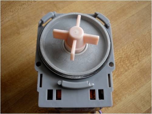

I yanked off the pump cover and found this:
It turned ever-so-freely, I didn't want to tear it apart, so I decided to
"improvise" and make a coupling that would fit over the pump impeller
and merely attach it to an arbor to which I will eventually attach blades.

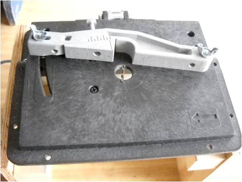

The problem is, this requires a mill with enough travel to make a decent slot. I have an end-mill milling attachment for my lathe, but it's nearly useless. By the time I get it set up, there's nearly no working room left. That's one disadvantage to using tiny machinery, but I still like small stuff, so I had to find another way around this.

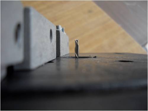

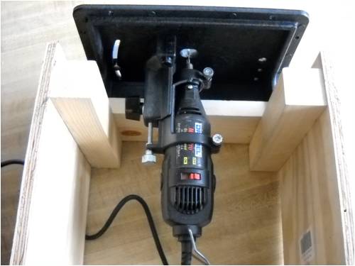

Here's what I came up with. It's a "Dremel" router table. I picked it up from Amazon.com for $30 including shipping. It's all plastic (except for screws) and it holds my 110 vac electric Dremel high-speed drill thingy.
Here's a shot of the Dremel tool mounted to the router table. It just clamps in with a couple special clamps that you hand-tighten in place and it's made to fit the Dremel tool EXACTLY. There's a depth-of-feed adjustment and a lock-down thing so you can choose the depth of the cut you want and lock that dimension into place whilst you whittle away topside.
Here's the "quill" sticking through the top side at the business end of
things. That side guard is a moveable "fence" which allows you to slide
your work against to maintain the proper distance from the cutting quill.
I said all that to show you this:

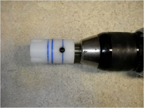

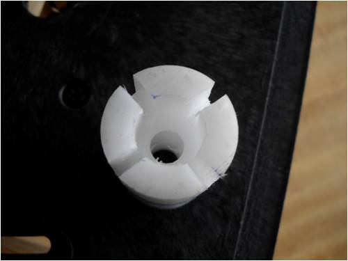

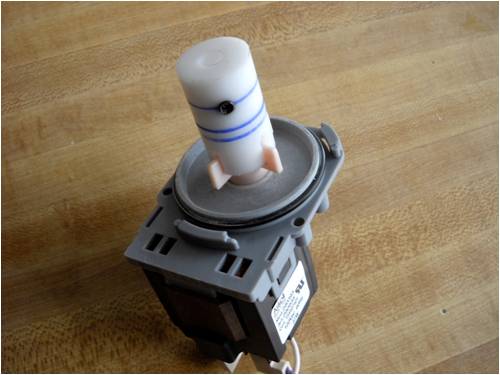

This is the slotted coupler I manufactured out of Acetate rod. It will fit
onto an arbor (the windmill's main shaft) and couple to the little pump
impeller and everyone will be happy as a clam without my having to tear
things all apart and probably botch everything up doing so.
Here's the finished product sitting atop the little PM motor that used to be a dishwasher water pump:
I tapped in a 1/4-20 set screw into the side to hold it to the windmill
shaft. The blue lines are layout lines I used to cut things the proper
length and to measure hole depths with accurately.

Yup, it is! Good to know this: "Just about all washing machines use this type of pump now." for two reasons. First off, I'll stop looking to get copper motor windings out of junked dishwashers. Secondly, if this little thing makes anywhere near a 'good' alternator, I'll build more. The coupler I made yesterday works like a champ.

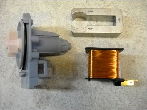

Took that pump apart today and here are the major players.

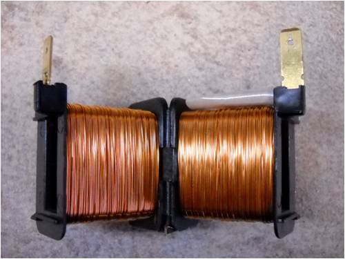

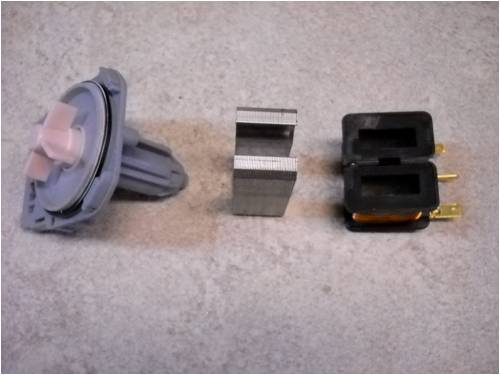

Here's a closer look at the PM (left) iron laminates (center) coil (right).
The plastic thing the coils are would around folds, so to rewind this
would be fairly easy, if one were of that intention.

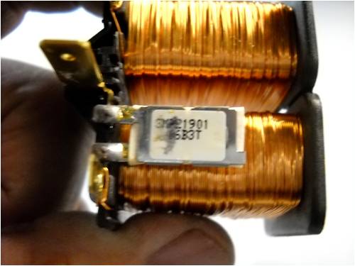

Not too sure what this little magic part is. It looks like tiny coils inside
a plastic housing; maybe a sensor of some sort?
Anyhoo . . . here's that finished coupler I made with my new Dremel
table toy. I have it chucked up in my 18-volt high-speed drill motor.

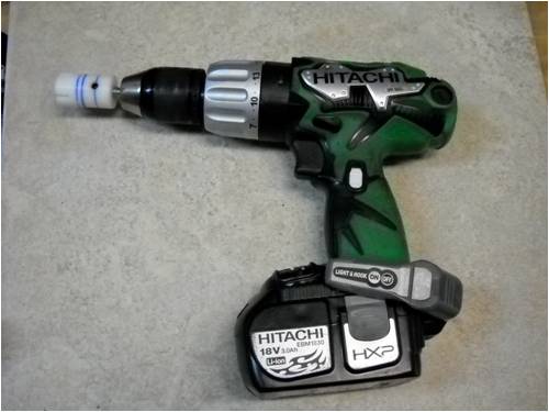

Here's what I used to spin the pump motor. I ran it as fast as it goes and
I'm thinking that's around 2,000 rpm or so. At that speed, the little
"generator" was able to make a 12-volt (d.c.) automobile running light
bulb just barely glow. I hooked it to my volt meter and I think it said
22 vac, but my meter has only two a.c. settings; 200v & 750v. I don't
own an ammeter (don't need one for plumbing) so that's why I did the
bulb test. My opinion of this pump being converted to a windmill
electric generator is: Don't bother! The results I got were dismal at best!
. . . . . Mac

As for the little magic thing, i am guessing its a thermal fuse so if there is a fault the coil wont go into meltdown and the fuse will go open circuit.
I dont think it would be worth a rewind and would keep the coils for the copper wire on another project.

I have a couple of those little motors. Its a clever idea, the permanent magnet armature is inside the plastic case, where the water is, behind the impeller. The coils and laminations are on the outside, where the water isn't. The design means there are no drive shafts through water tight seals to worry about, it cant leak. The down side it the armature rides in plastic bearings that use water to keep them cool and lubricated. Take away the water and it wont last very long.
The little magic part is a thermal overload circuit breaker. If the pump runs dry or is jammed ( usually with dead frogs ),it starts to overheat and the breaker will cut in and out to stop it having a melt down.
