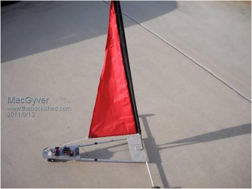

This is my little R/C sail car from the top view.

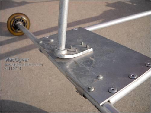

This shot shows how I "stepped" the mast. It's a pin hooked to a bent
piece of aluminum plate, which is in turn screwed to another plate that
holds the two outboard rails together. The mast is a 3 or 4 foot section
of aluminum tubing slipped over that pin on the deck. The outhaull
holds everything down when underway.

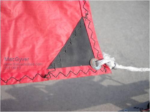

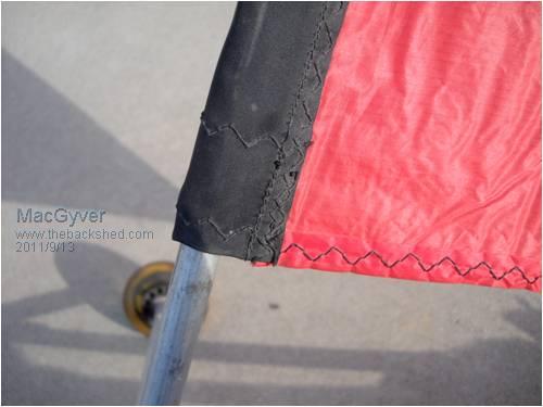

A friend who is a professional sail maker stitched me up a sail made
out of Dacron-polyester material. This is the "outhaul" where the sail
is tied down.
Here is more of that professional stitching. The sail slips onto the mast
using a pocket sewed into the front of the sail.

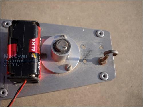

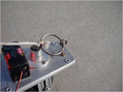

Using a threaded eye, I untwisted the eye and attached the threaded end
to the rear deck with a nut on each side to hold it firmly. The piece of
nylon shock cord (from a parachute) has a key ring attached. When I want
to run closer to the wind, I put my finger through that key ring and wind
up the outhaul, making it effectively shorter. It's like pulling in the main
sheet on a real boat. Then I let the opened eye hold the key ring and
cord and we're sailing!

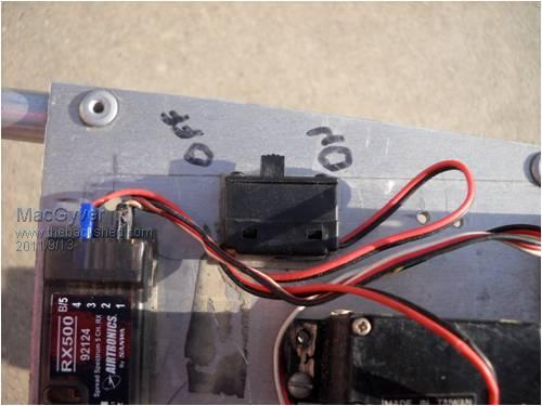

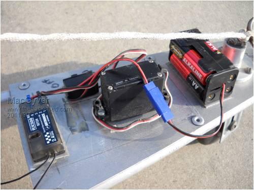

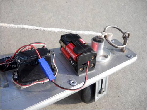

This is the electronics package attached to the stern deck with double-
sided tape. This one uses 4 "AA" cells. The other two black boxes are
a standard "servo" and the ON - OFF switch.
Here's a better shot. That little itty-bitty box is an ON - OFF switch.

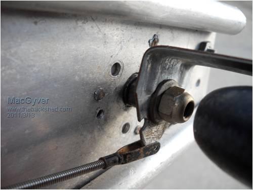

The single standard servo is mounted upside-down on the stern deck.
The working arm passes through a hole in the deck and is attached
with a model airplane's threaded toggle. The toggle has a little pin
that is held in place inside the hole in the servo's working arm by tension
in the clip's metal. The other end of the threaded rod attaches to another
pin and a piece of aluminum angle onto which the rear "steering" wheel
is attached. I tried making this the front of the thing when I first put it
together years ago, but it would topple end for end in a high-speed turn!

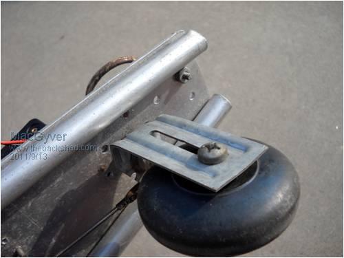

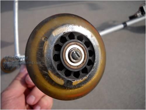

Here's a tight shot of the front end from underneath. I made (turned) my
own axle bearing on the lathe and used a bolt with a long shoulder as my
stearing pin. It works like a champ and is so robust, even a 360* spin on
asphault doesn't screw it up!
The steerage wheel (like a rudder on a boat) is mounted in a slot so I can
adjust its height as the wheel wears.

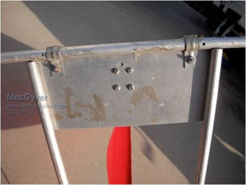

Here we see the front deck, which holds the side rails as well as the front
axle rail and mast mount. I just cut holes and threaded them to accept
store-bought screws.

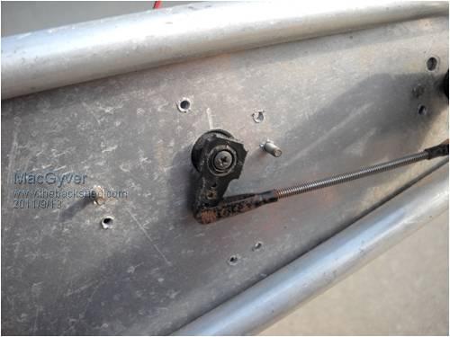

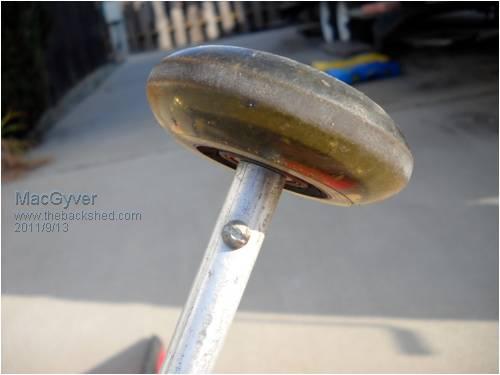

Here's a picture showing how I "pinned" the axles to the frame tubes.
This is the top side of the steering wheel mount. It's just a simple turning.
Here's that on and off switch. You MUST have a way to turn things off
or the batteries will be done in while you're walking to the playground
or parking lot.

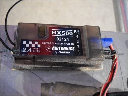

I "borrowed" this receiver out of one of my R/C gliders. This is the kind
of receiver that must be "paired" with the transmitter. My transmitter
has a 50-plane memory. I guess that means I have permission to build
48 more planes, eh? :O)

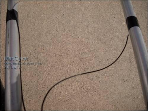

This is how I ran the two receiver antenna wires. They're not supposed
to be close to metal, but when the entire craft is metal, that's not on the
to-do list.
