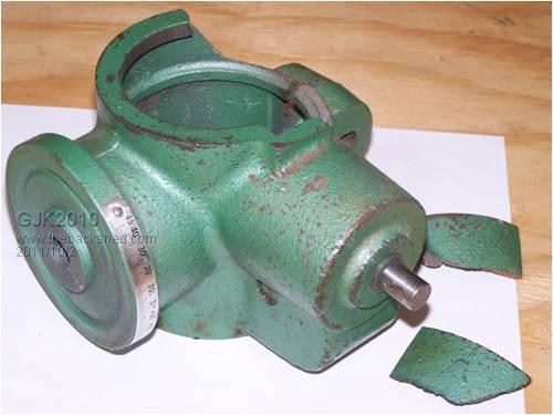

Does anyone here have a floor model drill press? Is what I have is a Sanchin drill press and the table evelator bracket that rides on the main column, that bracket broke and I would like to know if anyone could help me by measuring the colunm's so maybe I can find one that may work for my press. The colunm needs to be 2.441".

You could get that one brazed back together and re machine the column hole as it doesn't seem to badly broken.

Think braze would be strong enough? Im not too sure.. I thought about maybe welding but not so sure. Some guys say heating the object up to 500 Deg. weld it then put it back in the oven for a while then slowly lower the heat by 100 Deg. until cool enough to handle. Guess I never done it before so maybe i'll try the welding process first. Just worried that its gonna cause iron in-brittlement.....only one way to find out Right

In my experience brazing has a better bond than welding as the cast iron in these Chinese machines is very low quality and does not take arc welding well, even with all the preheat and special rods, Just to buy the correct rods will cost heaps.
With brazing you can build a fillet to reinforce the weld and get a greater surface area of brass contact, preheat is still important, I used a small gas burner on an old stove and preheat till when you sprinkle Borax (Flux) on the weld it melts and goes glassy, cool slowly by turning the gas right down, Use an old saucepan inverted over the piece to prevent the wind cooling the piece to quickly.

It looks from the pic that the ring inside where its parted doesn't touch the post that gives more area to build up weld.

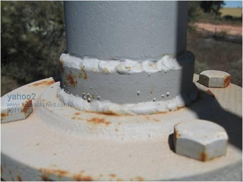

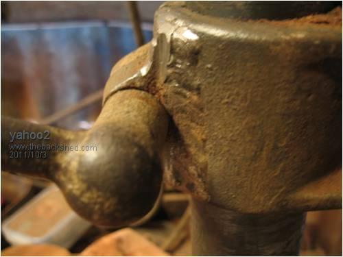

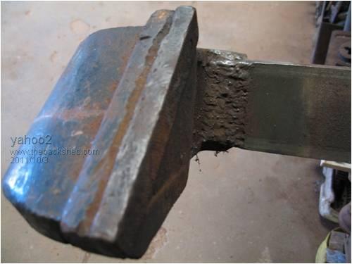

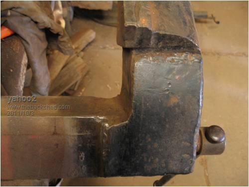

Heres a couple of photos of stuff that has stood the test of time and broken most of the rules
this was arc cast weld with steel plates welded to the sides I was a school so 30+ years ago
This is zinc coated steel to sh#t cast done with a mig welder and standard steel wire (not recommended) it holds a 4 metre satellite dish.there are cracks but it will handle about 5 tonne side load, the test one did anyway.
