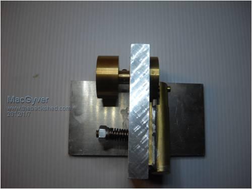

I have retired and once again have begun building little projects. First up is a small aluminum and brass air engine. It's what is called an "oscillator". I'm waiting on some micro-millimute (really small) fittings to arrive and be installed in the inlet and outlet ports on its back side. When they arrive and I've got them installed, I'll run it on air and shoot a video for Youtube. For now here's what I've accomplished:
This shows the cylinder and piston connected to the crank pin. The
piston / cylinder slides on the vertical body of the engine as the crank
pin throws the cylinder up and down as it changes direction at TDC
and BDC.

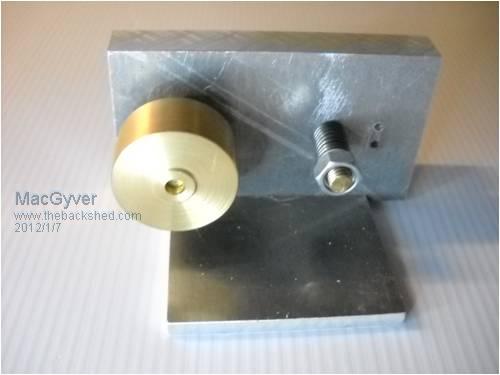

This shot shows the base plate and vertical wall (aluminum) and the
crank pin assembly, piston and cylinder as well as the brass flywheel.

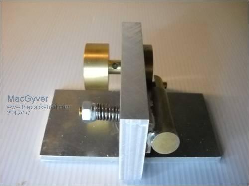

Here we see the outboard side of the flywheel and the spring tensioner,
which regulates the pressure the sylinder sliding base contacts the
vertical wall, which houses the inlet and outet ports (two little holes).
As the piston arrives at either TDC or BDC, the inertia of the flywheel
causes the crank pin to toss the bottom of the cylinder and piston to
the opposite side which covers/uncovers either an inlet or exhaust
port.

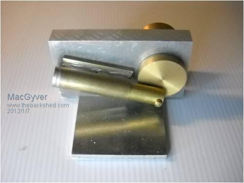

Continuing around the engine, this shows the back side. The only
part that doesn't show is the brass backing plate, which is welded to
the cylinder. It slides on the vertical wall and its motion exposes
ports to let air into or out of the cylinder to make it run.

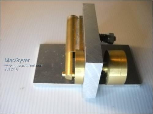

Here it is from the top side. All the cuts in the base plate as well as
the squaring of the vertical mounting wall were done on a 3-axis
milling machine. The wall fits so tightly in the slot, it does not need
any screws to hold it there.
