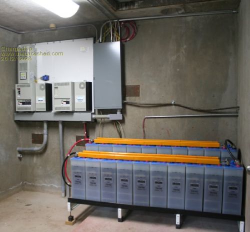

Posted: 08:04am 28 Dec 2012
Hi, I'm interested in answering any specific questions you may have about the Nickel Iron batteries.
I have a lot of experience working with, installing, and servicing Ni-Fe cells.
There is a ton of great information around, especially when looking back at Edison's original documents.
(Short document on Ni-Fe Chemistry)
2012-12-28_180325_The_Chemistry_of_the_Edison_Storage_Batter y.pdf
