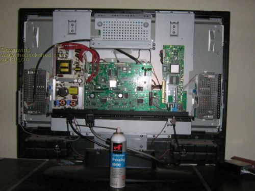

Its a Shaub Lorenz LCD TV that doubles as my computer screen, at 4 weeks from new it was in for a 8 week wait on warranty repairs, then 2 years later and about 2 years after that again, now i had decided to repair it myself, that way i should know what fails and can fix it quicker than in 8 weeks.
Here several months back it decided to take a holiday (the TV) and refuse to work, it just kept cycling the On/Off led, red, blue, red, blue..........repair time ......... so after 10 zillion screws to remove the back cover and 1 zillion screws to remove the sheet metal shrouds, i accessed the power supply board.
Knowing from previous repairs it was a power supply cap problem (well other then the first repair that required a new main board replacement that was shipped from France)
Ok...so this time i changed 2 x 470uf, 16v, 105C caps on the power supply board and it all worked fine again, while doing surgery on the power board i had noticed 2 x 680uf caps slightly bulged on their tops, but i had no replacements handy at the time.
A month passed and all worked fine, then it ("it" is a new word for TV) threw a hissy fit and refused to work on the IR remote (lets face it in today' era if the remote dont work you shoot it, and place it out for council rubbish) With turning the power off for a minute and back on it would work on the remote for a few minutes, then refuse to listen to any IR command i used, even verbal abuse made no difference.
Well! it has been faithful for many years in between its need for a little time in Rehab every so often, so i again removed the 11 zillion screws and replaced the 680uf caps that was bulged, and again it worked without a problem.
Then over the past couple of weeks it has developed a rash of a graph pad view on the screen with dotted green lines vertical and horizontal, and again only when it when it feels like it, and refuses any remote commands while the allergic reaction is present.
Yesterday being very hot it came out in more spots then a TV with chicken spots, it became almost not viewable, so again i removed the 22 zillion screws to access the power board, then armed myself with a can of component freeze, with intended to wait for the green graph chicken spots to show, then freeze each power cap to see if i could locate the problem.
Now this is why im sure its a female TV ( other than the odd need for a visit to rehab, or some personal time of fiddling with its moods and other bits)
I powered it up backless (back all exposed) and waited for the green chicken spots, and waited, and waited, and its been 2 days that have now passed without a glitch................Hmmm Bugger!!!!!
Im sure its female and just wanted a change ??? and it thinks going backless is the in way to go!!
All i can say sweet heart, is next time you throw a hissy fit im ready to freeze your bits. ( i bet she is reading this as i type ........ So be WARNED, precious!)

Posted: 05:45pm 25 Jan 2013
Just an update on "she"
Since armed with a can of nipple freeze spray handy, and the removal of the back covers, along with the pre warning of council trash should "it" have a hissy fit and malfunction again, for several weeks now "she" has not failed in any way, a pure faultless operation.
It might be time to start putting the clothes/covers back on her.
Sometimes it just works

Posted: 10:41pm 25 Jan 2013
Hi Pete
While you leave the back off it will work OK due to better ventilation as soon as you put it back together same again, if you want to find whats wrong use your heat gun on each board to warm it up and then the freeze to find the faulty bit.
All the best
Bob
