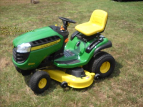

Here's mine:
Here's an out-of-focus picture of my "expensive-green-paint" (John Deere) ride-on mower.
I have every good intention of building an electric ride-on mower out of a golf cart chassis. The 'cutters' will be high-speed motors direct-driving braided-wire weed-eater strings. I plan on recharging things with one of my VAWT windmills, which I intend building very, very soon!
. . . . . MACEdited by MacGyver 2013-11-05

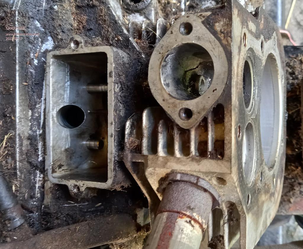

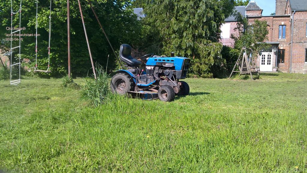

Here is my 46 year old Roper 16t, made in the USA, probably see me out. haha!.
Lots and lots of solid thick steel, great but very heavy machine.
Oh bloody hell! I thought the front cylinder was losing compression.

Posted: 09:04am 16 Apr 2022
Yep that will sure reduce the compression alright! Never seen that happen before, how do you replace or re affix the valve seat or is it time for a replacement head ?  It otherwise looks in pretty good nick for 46 years old.
Cheers Mike
Posts: 3432
Posted: 12:44pm 16 Apr 2022
Another head won't fix it, its a side valve engine. That's the barrel. Could be expensive to fix. The usual method is to weld up the port so it can be re-machined then shrink a new seat in liquid nitrogen and slap it in before it expands.
The soot marks show the head gasket was leaking prior to the seat failing. Perhaps the engine was seriously overheated at some point in its life.

Thanks Phil, when I first looked at the engine I did think old engine side-valve type (Ford Prefect came to mind), then I focused on the valve seats and of course all the engines I have actually worked on over ~ 40+ years have all been overhead valves so my brain inverted it and I asked the dumb question.......
Great analysis of the leaking head gasket, I registered all the soot but didnt register the leakage outwards by the exhaust valve - I think you can read engines the way I can usually read a circuit board lol.

Dropped valve seats do occur on these old Briggs & Stratton side valve engines.
Here is a vid, there are more like this to be found on the Utub..... https://www.youtube.com/watch?v=7wsBj7qwlPMhttps://www.youtube.com/watch?v=7wsBj7qwlPM
I dont fully recomend this peening process and it should be done more neatly. But you get the picture.  Note, practice on a small bit of the cylinder ally to see how the metal behaves, it should be workable and mould nicely as most modern engines the ally is brittle, so carefull.
Ordered a new valve, a new valve guide and a new seat. The intake is okay but needs the valve stem grinding down a very small bit. ie to give valve follower and valve stem expansion clearance,
Its the exuhast that has fallen out, probably 46 years of getting just to hot. However being a side valve there is plenty of ally to peen around and over the new valve seat to keep the valve seat in position. It seems that even a few swaging/peening points do work well. The valve seat is hard and very brittle so dont hit that.
Getting every thing to act true and the valve to seal correctly when working will take some precise work, especially with the Valve guide which is well worn, so the new guide will require trueing up on its intallation and reaming out.
Nice thing with this side valve is that it can all be done as is, no need to take the engine down.

Posted: 10:04am 17 Apr 2022
Good day All
When we repaired valve seat insert faults, we machined the valve seat where the insert fitted. then  fitted oversized valve seats.
Penning around the old valve never works because the heat transfer to the cylinder block is very poor and the seat will again drop out.
It is not that expensive to get it repaired by a engine repair shop.
Or if you have access  a lathe make your own cast iron valve seat,  fly cutter to cut the seat, a guide to fit the oversize seat insert and some liquid nitrogen to freeze the insert, or heat the cylinder block and freeze the insert in the house freezer.
The seat guide is to make sure that the seat is fitted with one hammer blow, before there is time,  for the heat of the block to transfers  the insert.
