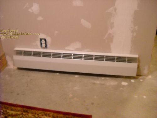

That would be me. My hydronic heater core arrived today by UPS, so I decided to take advantage of some FREE HEAT as soon as I could.
Where I live in Texas, the electricity provider, TXU, has a plan that sets your charge per kilowatt hour about half a cent higher, BUT lets you use all the electricity you can between the hours of 10 p.m. and 6 a.m. Electricity usage during that time slot is absolutely FREE and there's NO LIMIT to the amount you can use.
Enter one larger-than-life retired plumber. That' would again be me.
Anyway, "water" has a very high specific heat. The amount of heat it takes to raise one mole (a micro-millimute amount of water) one degree is 540 thousand! calories (540 KCal). That's a bunch.
So what; who cares, you ask?
Well, here's what: with FREE electricity for 8 hours a day and AT NIGHT no less, I can cook up a bunch of hot water and the water stores heat like almost no other common liquid (except oil maybe). I being a retired professional plumber, was able to design and install a "loop" system within my existing potable hot-water system and merely, with the flick of a switch (actually a timer), let the water heater cook while all the time, scalding hot water shuttles through my baseboard fin-'n-tube hydronic heater and my bedroom stays toasty warm with no muss, fuss or noisy fans.

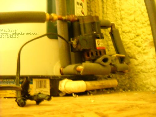

The only physical pump is the little one that makes the magic happen. It is on the return line right up against the base of the water heater in the attic space above my laundry room. You can't hear it run even if you're sitting right next to it!

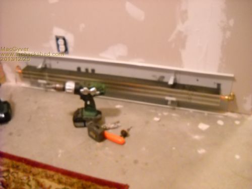

As the scalding-hot water passes through the central tube of the heater, the heat is collected by about a gerzillion aluminum fins. Once the fins are hot, the air between them heats up and as if by magic, becomes less dense and rises against gravity (hot air rises). This is called 'convection' and it "pumps" the air in my bedroom around and around, heating it on each cycle, whilst Teddy (my stuffed animal bed partner) and I snuggle warm as toast in bed.
It doesn't get any better than this!
:O)
This is the "before" shot showing initial installation. All pipes are
insulated within the walls and attic with closed-cell foam insulation.
Voila'! This is the finished product mounted on an as-yet unpainted
wall. It works like a champ!
Here's that little pump. It's on a timer and cuts off a half hour before
my free-electriity window ends. That gives the water heater time enough
to recover and I get a free hot shower when I get up iin the morning.
