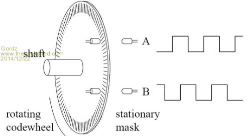

The most common type of quadrature encoder uses two output channels (A and B) to sense position. By using two sensors (often LED / PT combinations in optical versions) mounted 90 degrees out of phase, the two output channels of the quadrature encoder outputs a 2 bit representation of both position and direction of rotation. If A leads B, for example, the disk is rotating in a clockwise direction. If B leads A, then the disk is rotating in a counter-clockwise direction. The pulse duration gives an indication of speed. This means that by monitoring the number of pulses and the relative phase of signals A and B, you can track both the position and direction of rotation. Some quadrature encoders also include a third output channel, this is often called a zero, home or index signal, which supplies one single pulse per revolution. This single pulse is used for a precise determination of the reference position. Old ink jet printers are a great source for precision optical quadrature encoder sensors, disks and strips.
