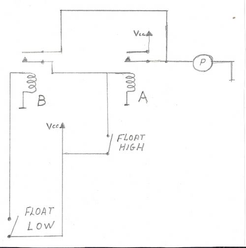

Here is a circuit that uses 2 by $1.85 Floats
This will cycle as the level rises and falls. 24/365
Explanation; When the water level is high, both floats will have risen, closing both switches and therefore both relays --- pump runs.
As the level drops float "High" will switch off BUT the relay "A" will be latched "ON" by relay "B" ---- so pump continues to run.
When the level drops below float "low" then relay "B" is deactivated thereby cutting the power to relay "A" ----- pump stops.
When the water rises float "low" closes energizing relay "B" closing it's contacts so waiting for float "high" to switch on relay "A" and the pump on again.
The floats could be screwed to different lengths of small pvc pipe to suspend them at the required depth.
Sample of relays voltage --- to suit the voltage.

RE Gizmo's "Pump controller" I think I could make it work on 24 volts by changing resistors 15k and 22k that sense the voltages, BUT come on where do I connect the sensor rods or even the floats (pins 9 and 10, oops it doesn't have any?)
