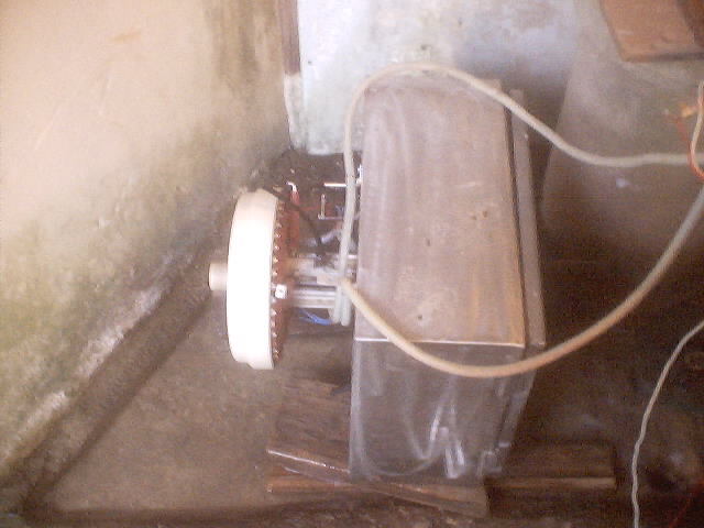

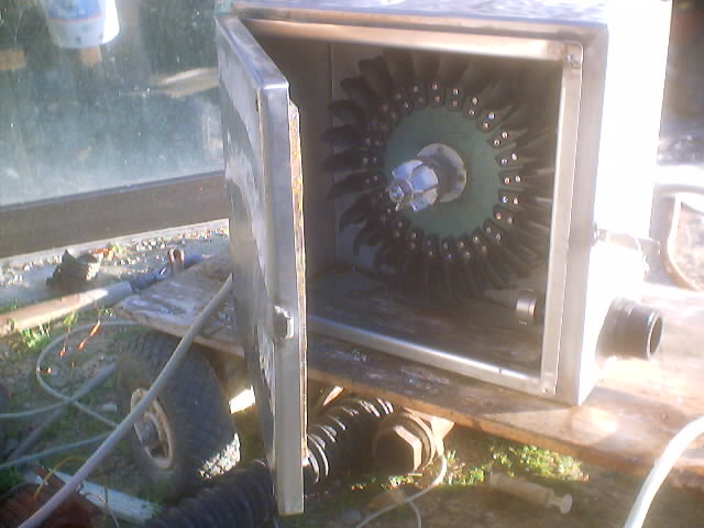

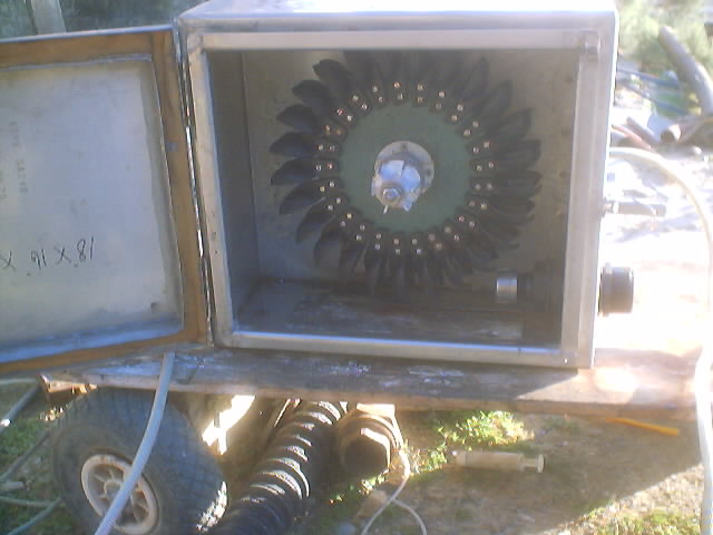

I also manufacture units for neighbours etc a sort hobby business. I will include some photos of units.

Sorry about confusion yes its a pelton I call it a Pelton wheel I get blank looks if I say runner. Cups are ones eco produces. He used to source from states identical but heavier cups.
