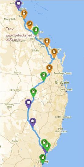

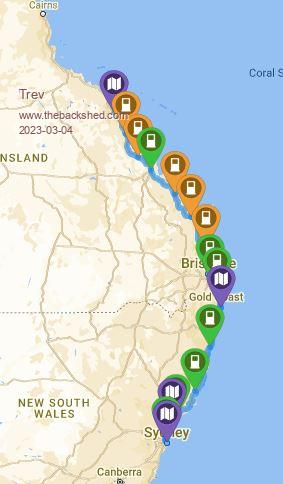

Here is the plan for driving to Sydney.
Use https://www.plugshare.com/ to find the charge stations you need.

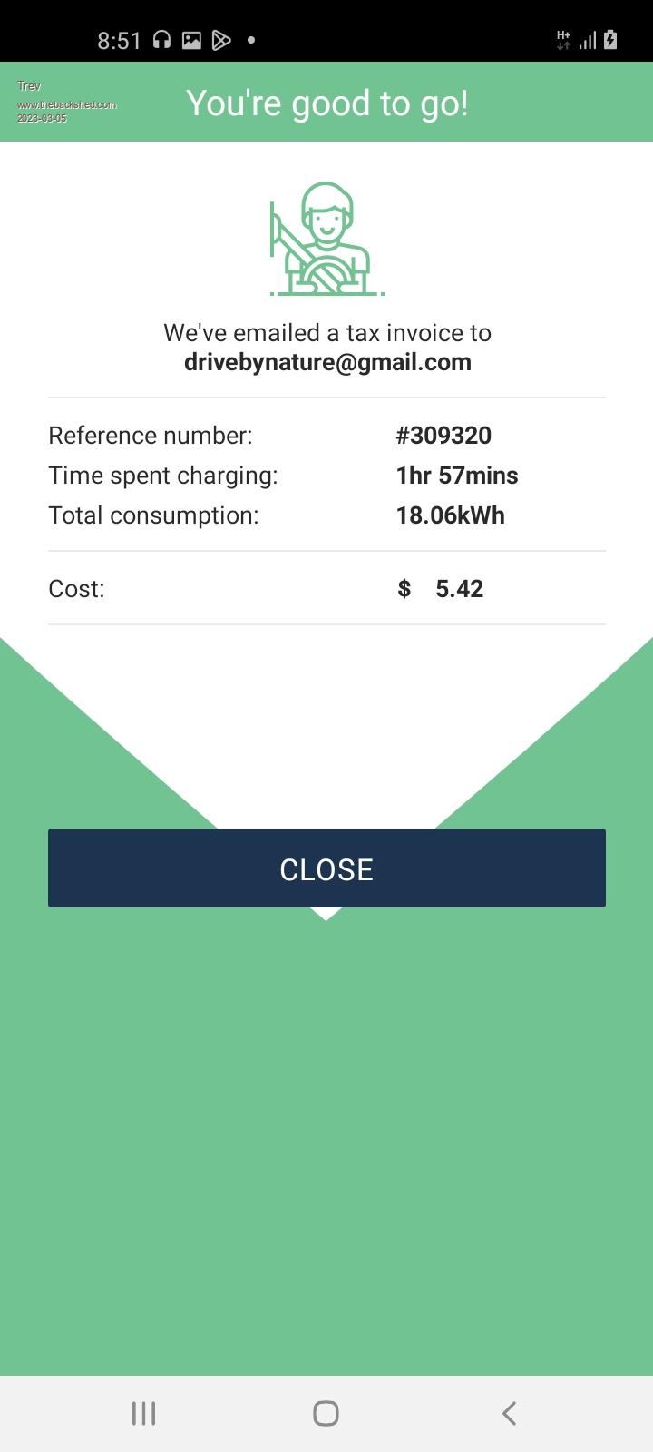

Posted: 04:26am 05 Mar 2023
Speedo reading.

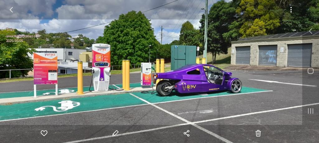

Left home this morning at 4.42am.
Arrived at Carmila 6.48am.
Drove 129km.
Started out at 95% and got down to 43%
Charged 1hr 57min back to around 97%.
Cost $5.42
Trev @ drivebynature.com

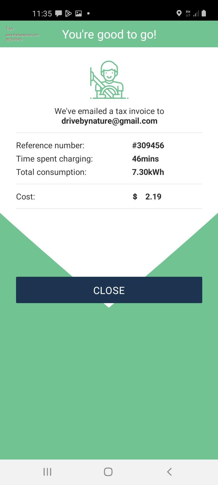

Posted: 04:46am 05 Mar 2023

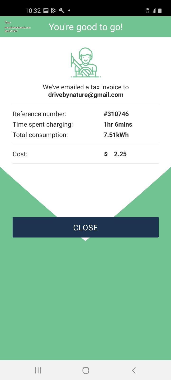

Left Carmila at 8.52am
Arrived at Marlborough 10.48am.
Drove 136km.
Got down to 45% remaining.
Charged 46min back to around 70%. Not full.
Cost $2.19

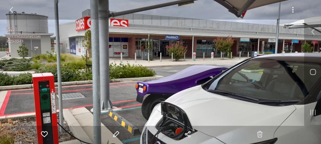

Arrived at Rockhampton Stockland shopping centre 1.06pm.
Drove 97km.
Used 70% to 30%
Only 2 phases connected but 32A, so still got 60A charge rate, just with 2 chargers on one phase.
Charged to full. Approx. 3hrs 20min
Cost $ free and no record of how many kW.

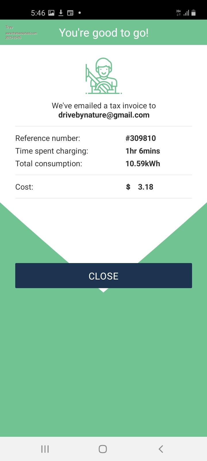

Posted: 06:55am 05 Mar 2023
Left Rockhampton at 3.24pm
Decided to stop at Mt Larcom. I saw on plugshare website, 2 Tesla's at Miriam Vale requiring the Type 2 AC outlet (the outlet I use) because the fast DC was broken.
Drove 79km.
Used down to 70%
Again only 2 phases connected but 32A, so still got 60A charge rate, 2 chargers on one phase.
Charged to full. 1hr 6min
Cost $3.18

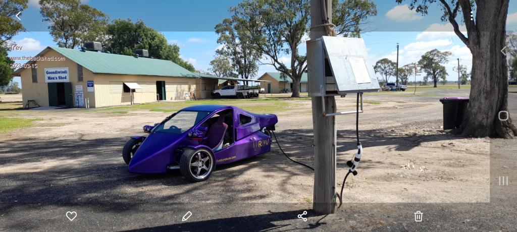

Trev
Joined: 15/07/2006
Posts: 676
Posted: 12:04am 06 Mar 2023

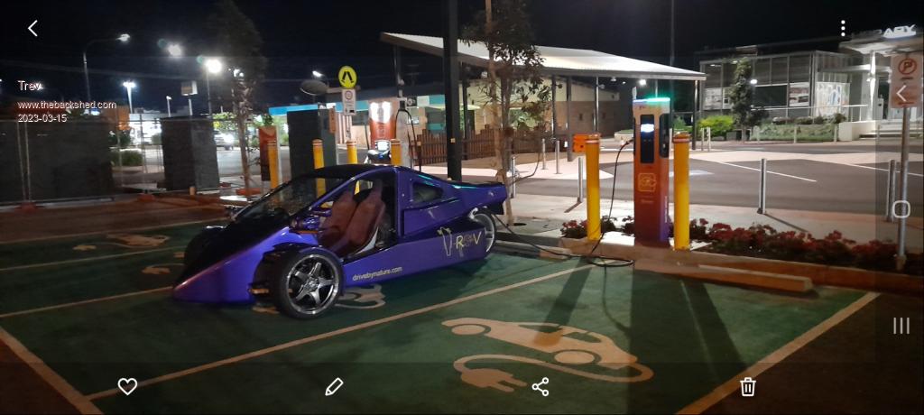

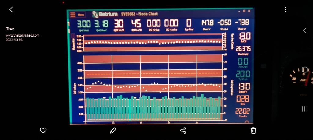

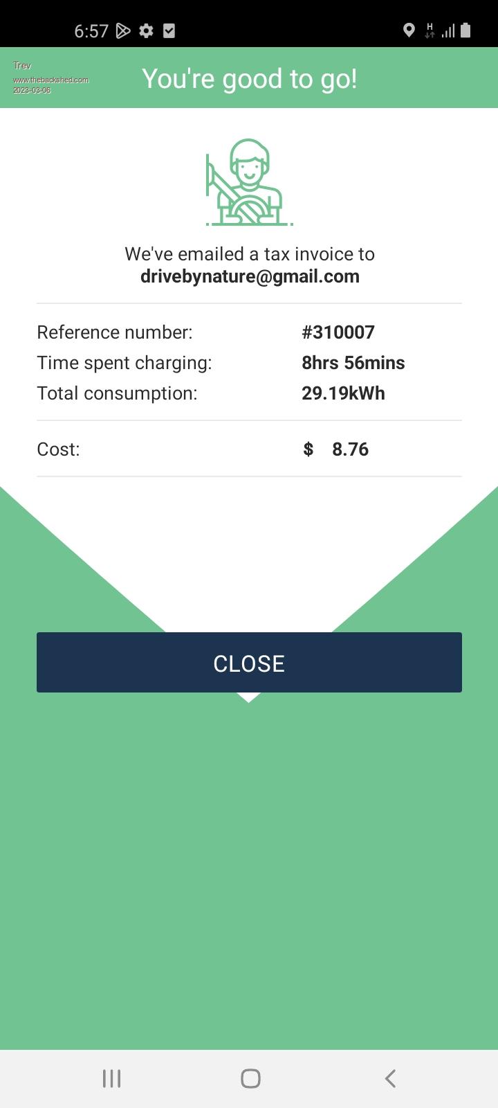

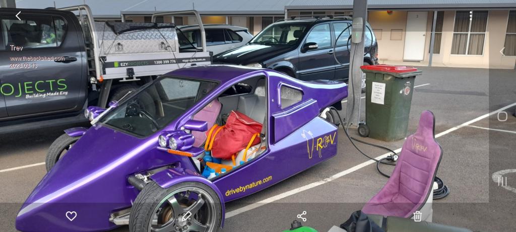

Arrived at Childers 9.54pm. Got plugged in and set up swag for a sleep. Strange, only 2 chargers working, but no big deal, it was plugged in for the night.
Battery voltage was quite low. Down to 13%. Not to be done on a regular basis.
Drove much slower to make 248km.
Better timing than Canberra trip, getting in at 11.08pm
It was plugged in for 8hrs 56mins, but I got up around 2am to check the end of charge - all was good. Cell balancing functioning.
Cost $8.76
Picture taken this morning, day2.

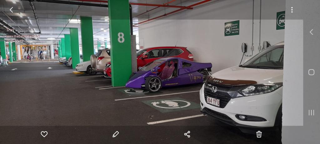

Sometimes there are car issues. Here at Gympie for the first 1/2 hr I unloaded the gear to remove the cover over my chargers. One didn't work from Rockhampton. I thought it was the outlet, then again at Mt Larcom, but last night at Childers I knew it had to be in the vehicle. The CAN charger wasn't working just now but this morning at Childers it was working - that's the charger that does the balancing.

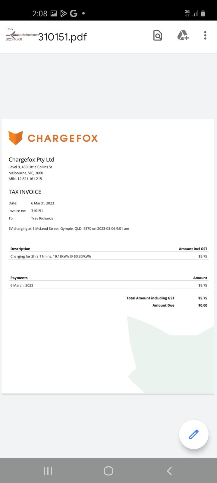

Left Childers at 7.12am.
Arrived at Gympie 9.00am.
Drove 144km.

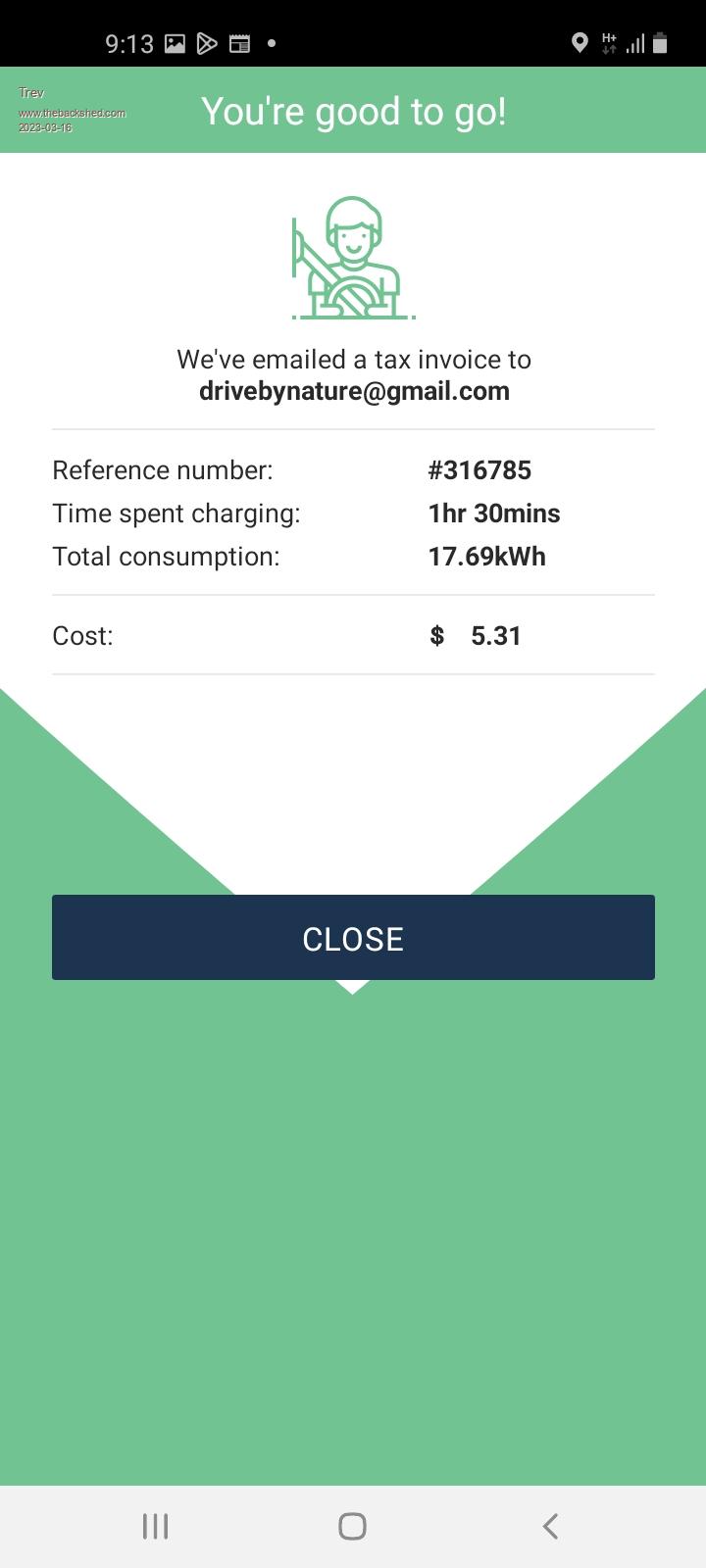

Batteries down to 37%. Too much traffic to drive steady, must go with the flow. Lots of roadworks. Roadworks driving to Childers as well last night. Red stop lights!
Charged 2hrs 11min
Cost $5.75
Somehow I lost the screen when I went to disconnect, so this is the invoice Chargefox emailed.

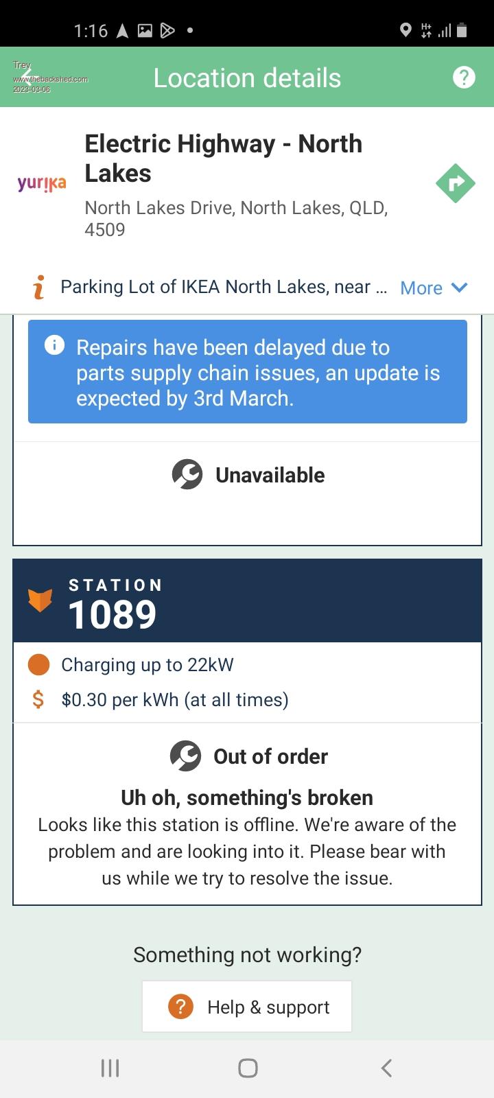

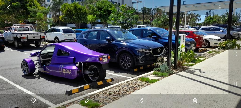

Went to IKEA North Lakes, but it is out of action
Currently charging at IGA Redcliffe.
Cost $Free (there will be no record either)
32A
See the Type 2 outlet in the garden in front of the 2 dark coloured cars. The one directly beside T-Rev is an ICE car.
After here I am going to have a catch up with a long time friend who lives in the area.

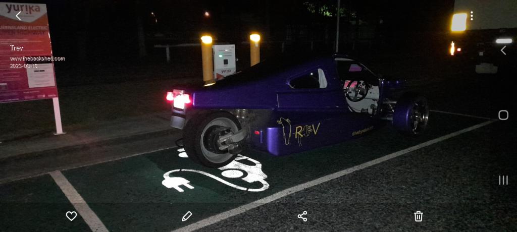

Posted: 05:29am 06 Mar 2023

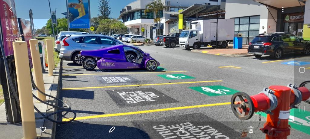

Of all the parks in this carpark (IGA Redcliffe) this is the most commonly used spot, where the silver car is. All ICE cars.
Right next to the EV charge outlet.

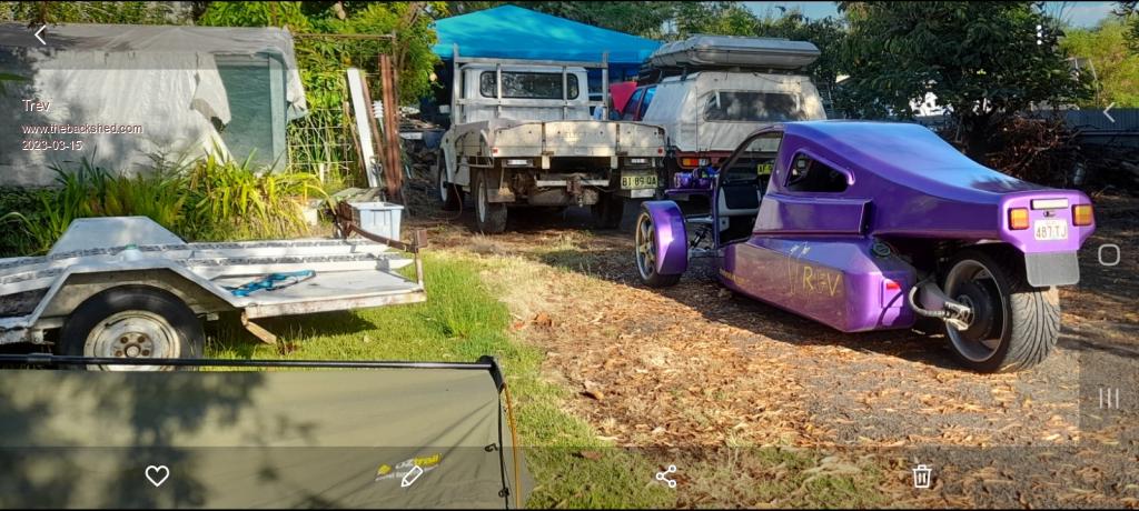

Day 3.

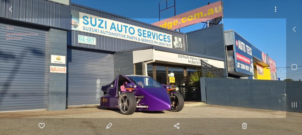

Left Redcliffe at 5.30am. Forgot to look at the clock, but arrived at Suzi auto/ OZ-DIY maybe around 6.40am.
CAN control charger working again this morning.
Charged approx. 1hr.
Another free charge. Thanks Graeme. Graeme also does EV Conversion. We see ourselves as friends in business, not opposition.

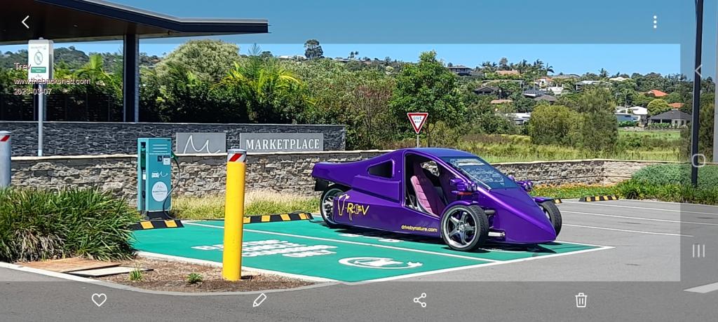

Posted: 02:19am 07 Mar 2023
Had a re-think about charge stations. Decided to miss the free power on the pole at Burleigh Heads and stop at Gold Coast Airport. That way, if the next station at Epic shopping centre down at Lennox Head doesn't work, then I have enough power to make it to Grafton.
I am glad I don't live in the Gold Coast part of the world. The traffic is terrible. Traffic jams and crawling on a 5 lane freeway is not for me.
Arrived at Gold Coast Airport charge station at 9.23am
Used 24% of battery (down to 76%)
Drove 80km. Some of that at extremely low speed.
80km for 1/4 of the battery, makes 320km range in those (not normal) conditions.

Posts: 676
Posted: 02:53am 07 Mar 2023
Arrived at Epic shopping centre Lennox Head at 12.52pm.
Drove 88km
Used 27% (down to 73%)
Charge station works so can bypass Grafton.
