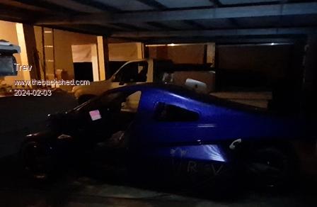

All packed up and ready to go.
T-Rev and EV Hilux
Trailer with Electric Quad and Electric outboard motors

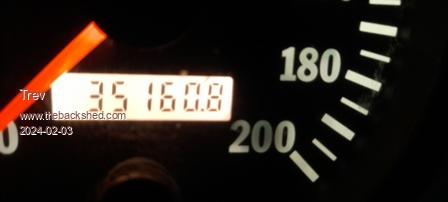

T-Rev speedo
EV Hilux speedo

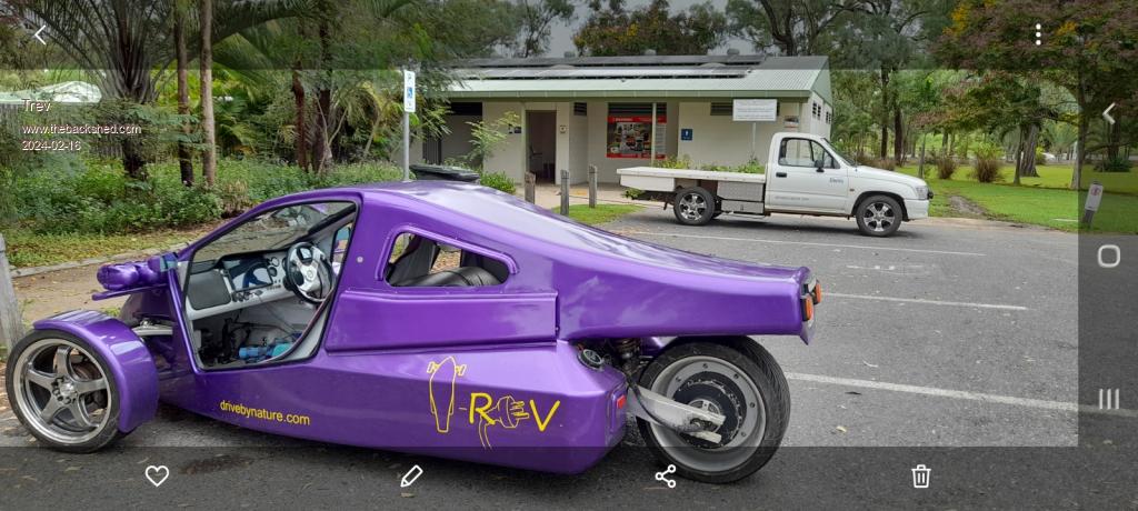

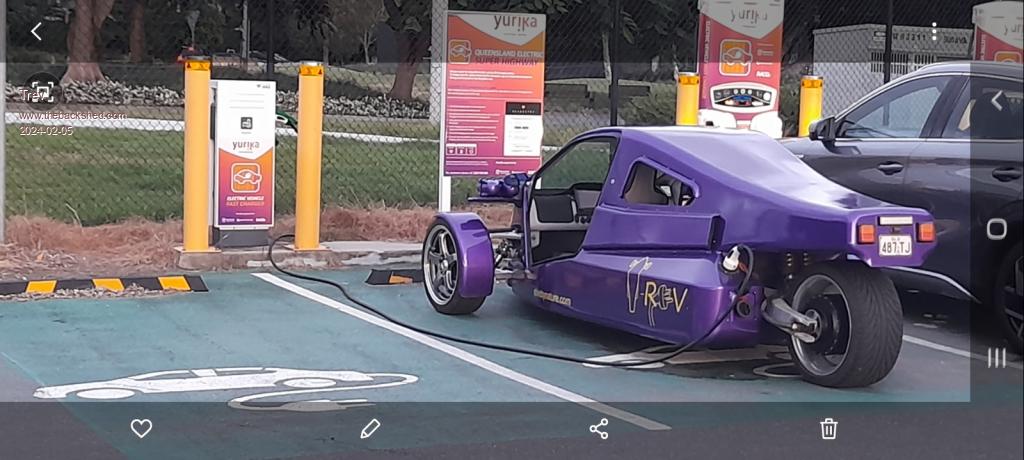

Left home this morning at 5.14am. Just starting to get light
Drove 139km to Carmila. Only 1 type outlet working. I have reported this not working numerous times before. Anyhow got EV Hilux plugged in to the good outlet. Connected orange jumper cable from EV Hilux to charge T-Rev.

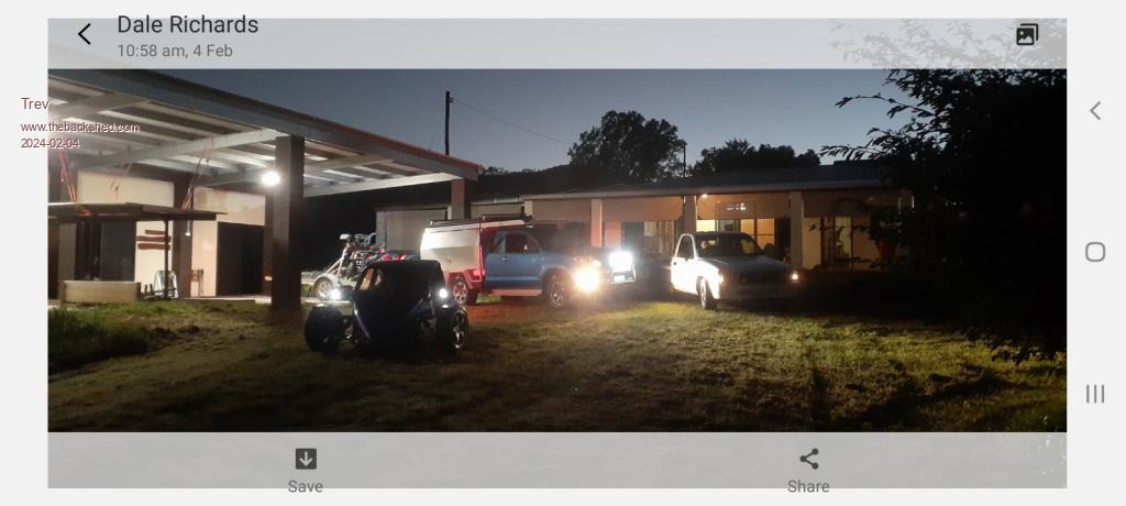

Not long charging, I got out breakfast. I heard a bang. Everything went out. I talked to chargefox and they could not reset the station. No more charging.

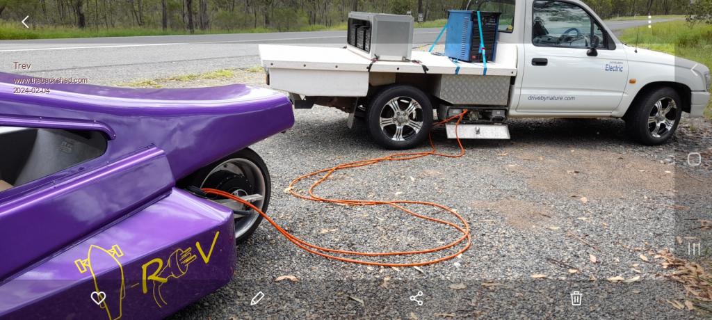

Plan B. Kaitlyn in EV Hilux, run the genny's to get enough. I thought I had enough power in T-Rev to make it, but 14km short. The battery was way too low to risk trying to make it. EV Hilux went ahead and picked up some charge and returned to dump power to T-Rev.

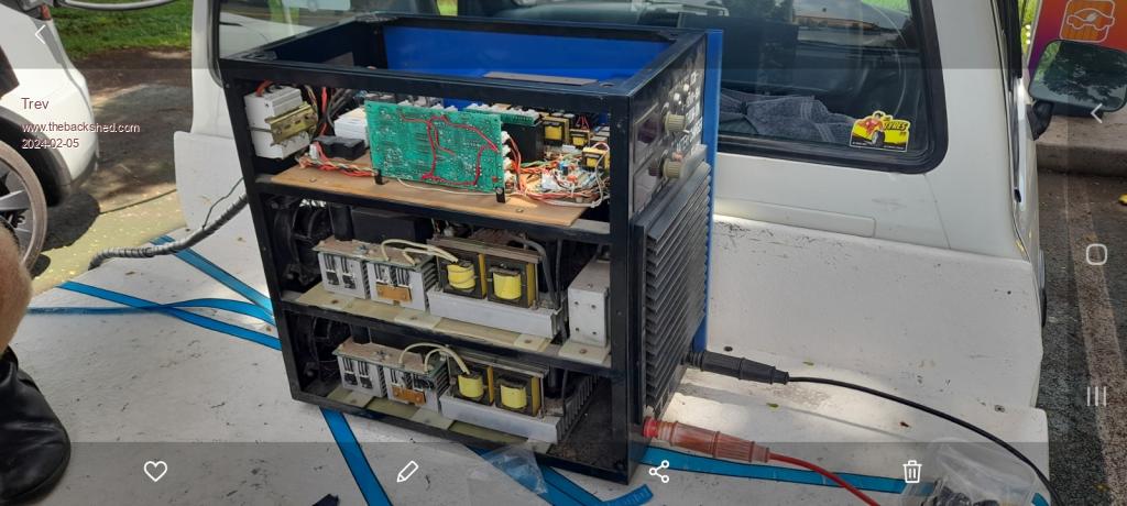

Dale found that the 3ph charger (blue box on EV Hilux) was blown. So that means down 60A charge capability. The trip will be longer.
It was way too hot at Marlborough so only charged enough to get to Rockhampton.
Found blown resisters in the blue  charger and so Dale went ahead to get some from Jaycar Rockhampton.
Charging at Rockhampton. The shadows are getting longer.
We had another look, fitted a resister that was obviously blown and tried the power. Smoke out of another place we has not seen before.

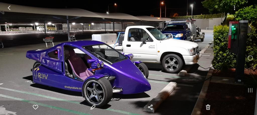

Now just doing a little charging at Mt Larcom. Only 1 outlet working, so EV Hilux  gets it. T-Rev will make it through to Miriam Vale

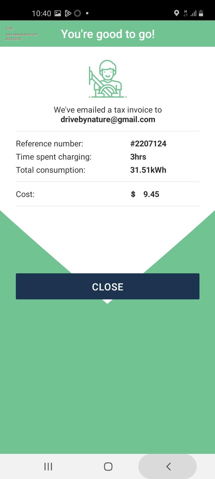

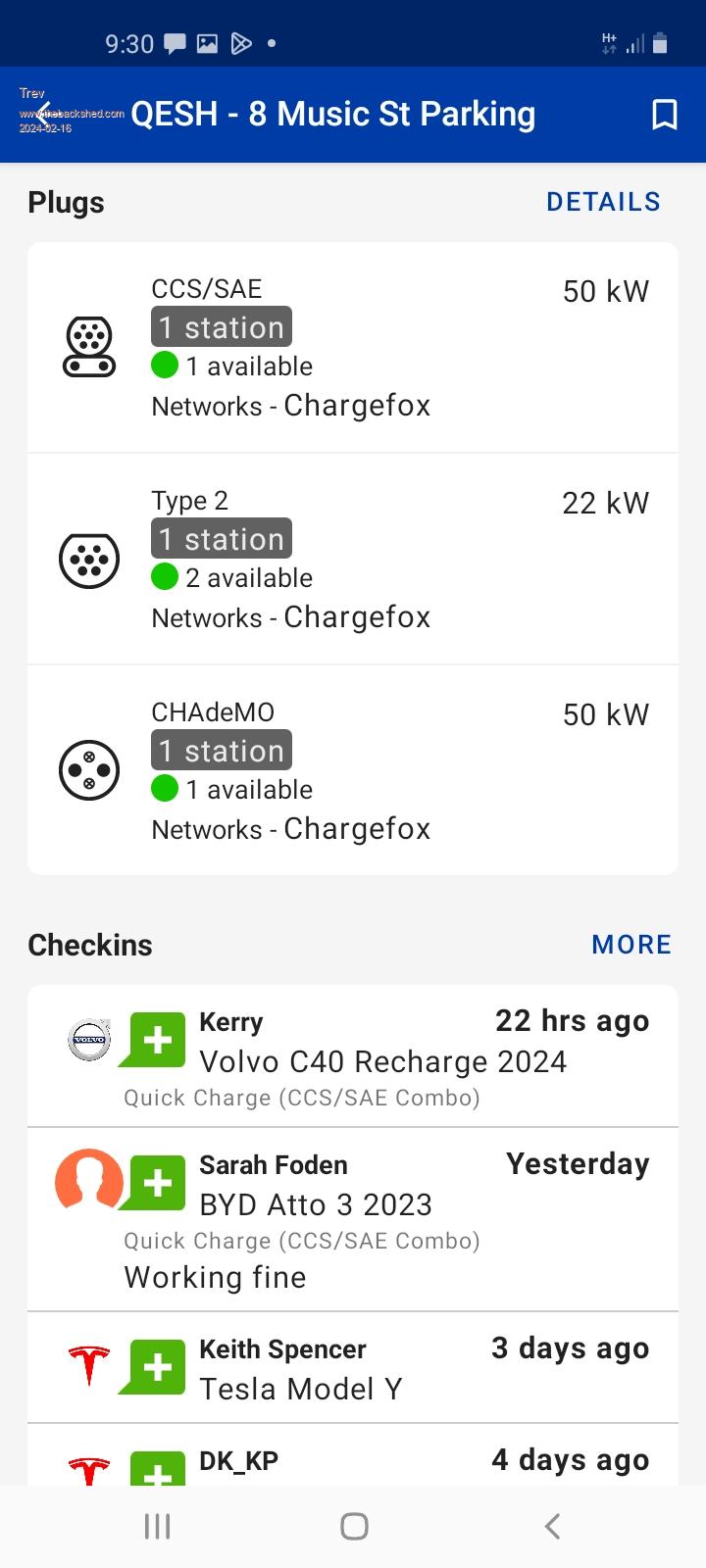

Screen shot of Chargefox
EV Hilux
T-Rev
We had them connected longer than needed for charging. Dale arrived and we changed some more components in the big blue charger. Got more smoke from other areas.

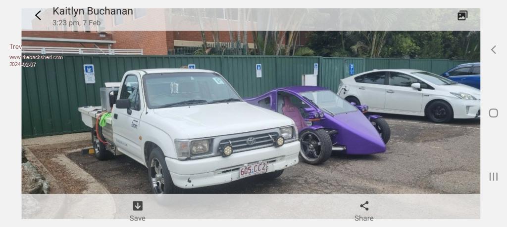

After getting enough power from that wall outlet at the shopping plaza in Coffs Harbour, we went to Nambucca Heads. There were 2 Tesla outlets at a shopping centre there. Free charging.
Day 3
Drove to Port Macquarie and charged. Free to charge. Had to wait for another EV to vacate, to get T-Rev in. EV Hilux took the only bay left, when we got there.

Currently charging in Newcastle. I was here in 2019 with Glen George and the electric MG. This roof is solar panels.

  Quote   This roof is solar panels.
Someone's got to mention that it seems to be nighttime in the the last pic

Part of the reason for the extra challenge is the big blue charger died and we spent time searching for components and in which town and the logistics of being able to get those components. Then there is the time to fit them and try it without destroying the charge outlet. We need the outlet to continue working to charge the vehicles.

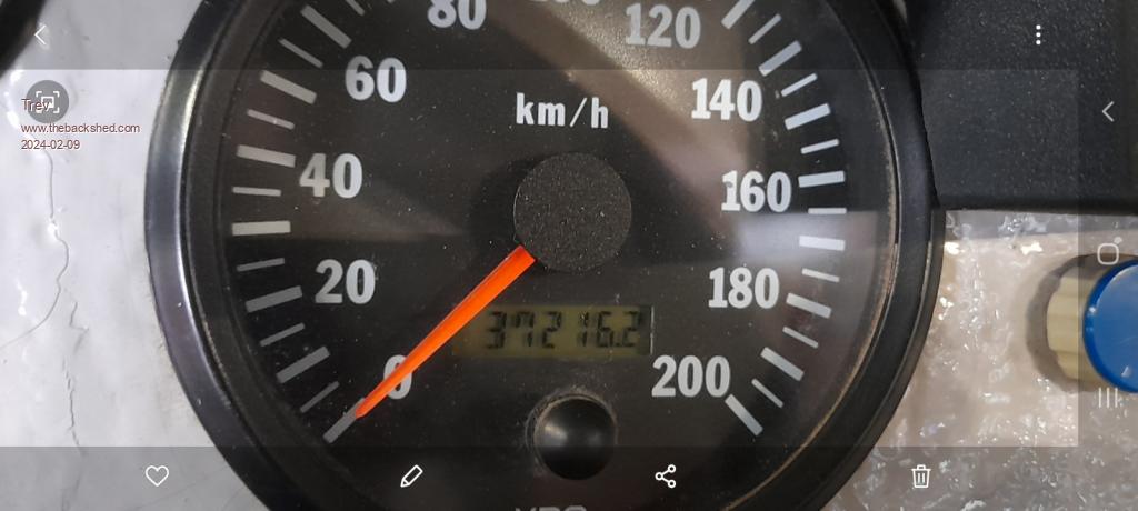

Speedo reading for EV Hilux 150736km.
Speedo reading for T-Rev 37216
