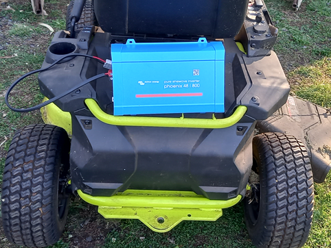

I also have a Ryobi ride on powered by a 48V 75Ah battery.
Tack on a Victron 800VA inverter and we have the Ryobi power bank,
I still have to mount the inverter on the rear rail. It will be just hooked on so it can be stored safely in the shed when the Ryobi is doing it's primary role.

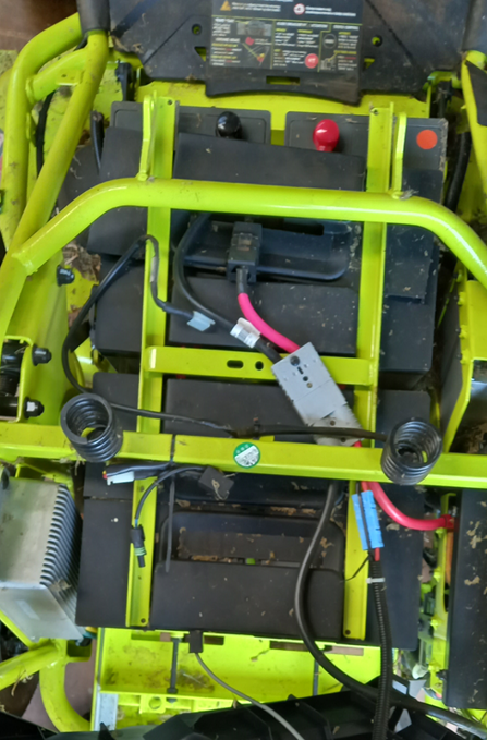

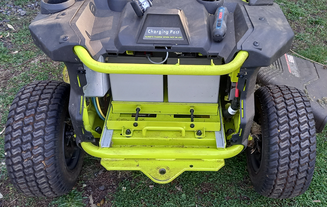

In theory, it was a simple task to slide the battery bank out so I could attach the new leads.
The terminals were in the front so not easy to get to. I ended up removing the body work to do the modification. Much easier to see what I was doing.
The next time there is a 6 hour power outage, I drive the Ryobi onto the verandah and plug in.
It also has the advantage that I can run the big electric drill in the paddock instead of relying on the cordless drill to bore fence posts or use the auger attachment. The 800VA inverter runs the 750W drill easily.

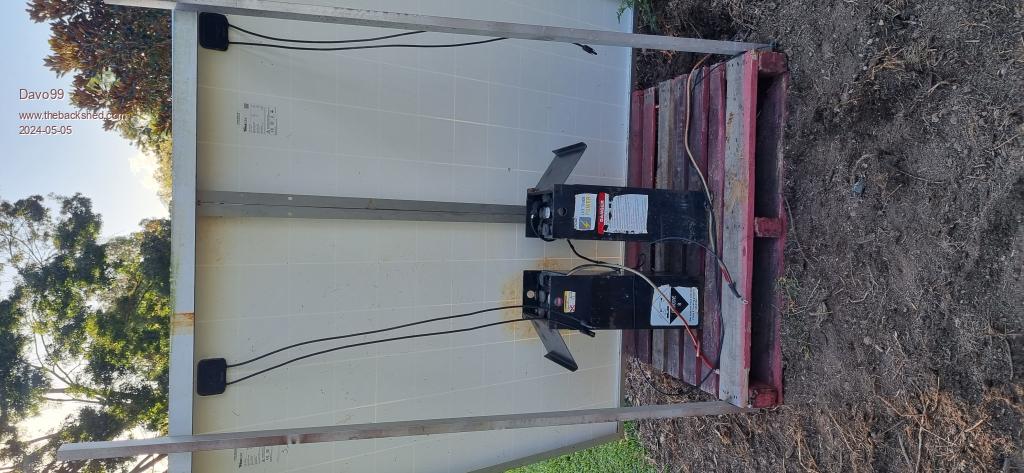

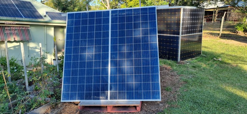

If you had some spare solar panels, you could a run them through a basic controller, ( not necessarily onboard) and if your outage was through the day, you could extend your run time.
I made some Ground mounts out of Pallets and some old solar racking but easy to use scrap timber as well. My last one had 2x 500W panels I had laying around so would provide useful power on a sunny day or you could do multiple of smaller panels.
I have a bunch of them that have old 360s on them and they do OK as well.

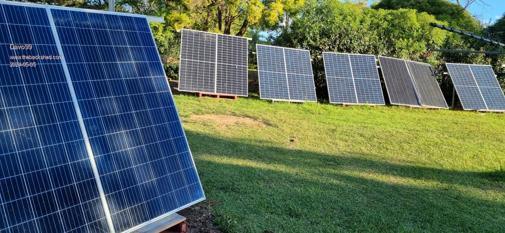

I still haven't disconnected everything! I got 8 panels on the Battery and even through it was overcast yesterday, there was still 26A going into it so going to take a while to run out especially as I connected it to the other pack as well.

but I aim to have over 100KWH reserve and I have 30+ Kw of panels plus several Diesel Generators I run on waste oil so I -think- I'll probably be OK.
