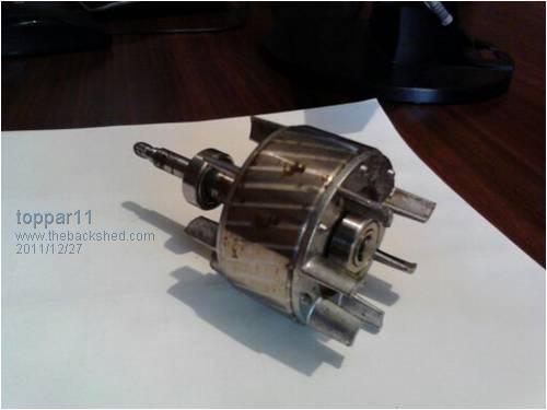

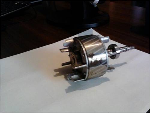

Hi, I need to repair a damaged rotor used in a Miele dishwasher water circulation pump. As you can see in the attachments one of the cooling fins is chipped and the other completely broken off, which I have. I think the fins are aluminum. This rotor is sitting on letter size paper to give scale.
Does anyone know if it is possible to repair this using some type of epoxy adhesive? I cannot find a replacement easily, the part is Miele and anyone who knows is hard to replace. I am repairing this motor pump for an older person. Thanks. Cheers.

The motor should work OK with that broken fin. Motors are designed with more cooling than is needed for normal operation, this allows for hot climates, dust build up, etc. So I dont think the missing fin will affect its ability to keep itself cool.
Vibration may be a problem though. If it had a even number of fins, I would break off the fin on the opposite side to give it some balance. But it looks like you motor has a odd number of fins, so you cant to that, as there are two fins on the opposide side to the broken fin. So you can either....
1. Gently file down the opposite two fins by half each. Easy but sacrificing more cooling ability.
2. Add weight to where the fin is missing.
I would go for number two. Find a small self tapping metal screw thats slightly heavier than the broken fin, then drill a hole to suit and screw in the self tapper, with some good 24hour epoxy on the thread.

I would not worry about the broken fins, or the effect on balance.
You can feel the weight of that iron rotor, and the weight of the broken off fin, which is absolutely negligible in comparison to the weight of the rotor.
It is not going to dangerously overheat, the loss of a fin (or two) will hardly matter.
Most of those small motors have no fins at all, and work fine.
The pump only works for very short periods anyway.
Just put it back together and it will run for many more years, if the bearings are o/k.

I agree with Tony above, the pump is at most running around 3500RPM (60HZ). Not at all like the 10,000+ RPM's some power tools run at and which do require to be carefully balanced.
Having a glued on fin fly off while the pump is running might be much worse than a slightly unbalanced rotor.
