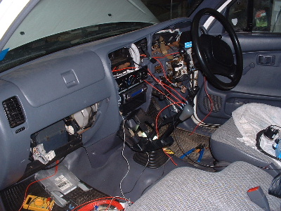

That fan on the dash - I beat it. It now works.

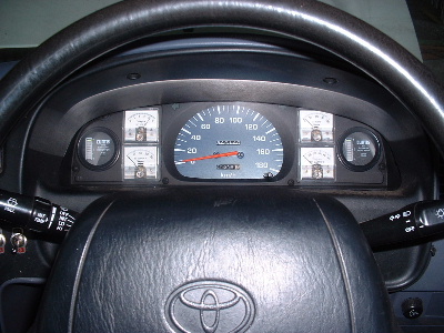

Have run some wires for the guages that will be in the dash. The other guages that I ordered should be here in another week or so. The 2 x fuel guages (12v & 144v) have been fitted to the dash panel.

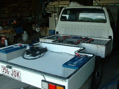

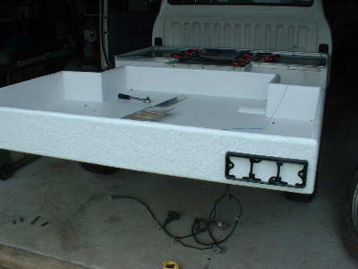

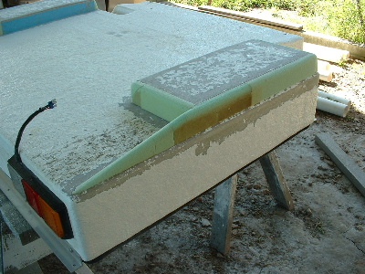

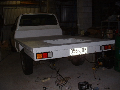

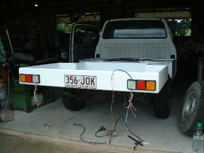

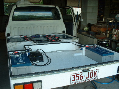

The rear storage box is fitted.
The rear lights also fitted and wired in. Still yet to cable tie them up. The lights are these new LED type that use very little power. Though not really significant in terms of the volume the main motor will take.

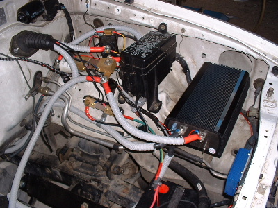

The megapulse units are strapped in for protection.

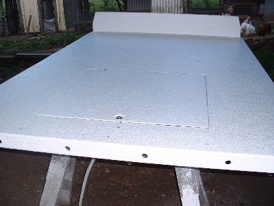

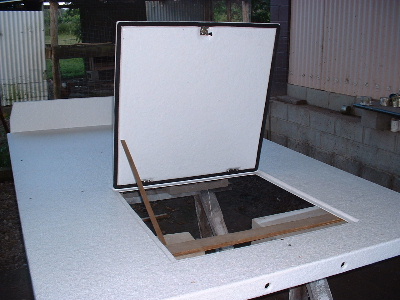

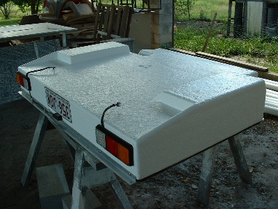

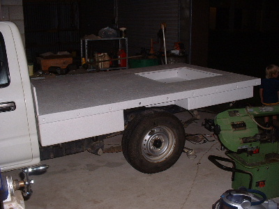

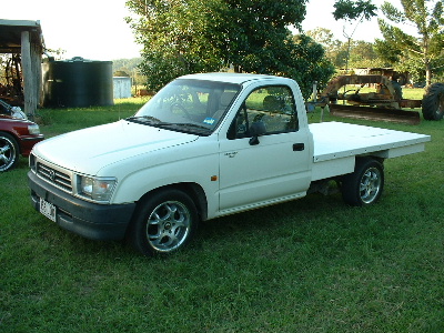

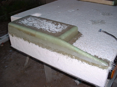

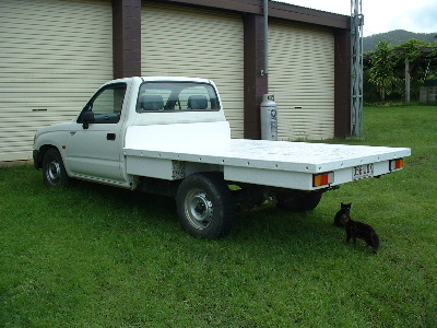

The tray is on. The hatch cover is still waiting for the rain & humidtiy to drop off, so it can be flowcoated.

Only got the hatch flow coated and fitted this week.

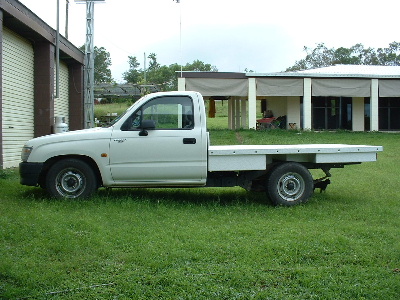

Hi All I know you have been waiting for this
Motor, FB1-4001, $3949
Power Control
Speed Controller, 1231C-8601, $2656
Contactor, SW-200, $323
Diode, MP-1, $6
Precharge Resister, 345258, $13
Emergency Push Button, ED252B, $280
Pot Box, PB-6, $171
Fuse(500A), SWE-FWH, $225
Fuse   Blocks, SWE-LSCR02, $81
Cable(50mm^2)& fittings & heat shrink, $423
Batteries
(Powersonic 226A/hr x 13), AGM, $6365
Charges
Zivan (144v,15A), NG3, $2495
CTEK (12v,25A), XS25000, $606
Vacuum Pump, 107CDC20/12, $438
Guages
    Fuel (144v), 900R, $202
Fuel (12v), 900R, $202
Volt (0-200v), TV1DVV200, $242*
Volt(0-15v), TV1DVV015, $242*
Amp(200A), TV1DAA200, $234*
Shunt(200A), 06715, $126
Amp(500A), TV1DAA500, $234*
Shunt(500A), 06508, $196*
Wire & Fittings & heat Shrink, $50
*+ freight from USA
Prices are subject to change
This is the basic components to convert this Hilux 2000 to Electric. We have gone the full hog, sparing nothing, biggest motor, biggest speed controller with the highest voltage possible, seeking highest possible Hp. The batteries are big to give us a good range, expected to be at least 120km. We are installing all gauges to be able to do extensive research and testing. We have made the complete back, added LED lights and had to change the flasher unit to keep the correct blinker timing. We have added switches for various reasons.
Different vehicles may use a different motor and speed controller. Smaller are cheaper. Gauges are optional. The volt and amp guages are very small to fit into our dash. Other gauges are possibly cheaper. There is a range of different types of batteries, with cycle life & price variation. The range and power you want helps in determining battery size and quantity. Lower operating voltage means less Hp. Smaller A/hr capacity, means less range, and less lead, and less weight. Smaller lighter vehicles may not need the vacuum pump (or earlier with no Brake booster). There are a lot of cheaper 12v chargers.
The options are many. You choose. What do you want to do with an electric vehicle??
Remember, cheaper is not always cheaper. Buy Quality. Go for what you want. Don't settle for 2nd best.
If it looks like junk before you start, the chances are it will look like junk when you have finished.
Put yourself in the picture. Now you have seen it done, you can do it yourself. I'm happy to help with the tough stuff, (or the whole lot if you want). I know you will be proud of it.

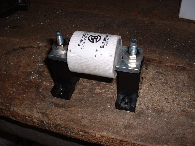

I really thought I would have had the volt & amp gauges by now, but they still have not showed up. The dash is basically all that needs to be done so I can go for the modification plate.
Also the big 500amp fuse. When I re-run cable to the 500 amp shunt, then this fuse will also be incorporated.

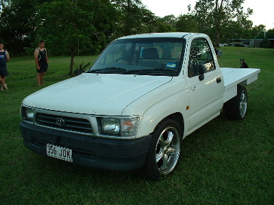

We had an afternoon with family and friends trying on different wheels.

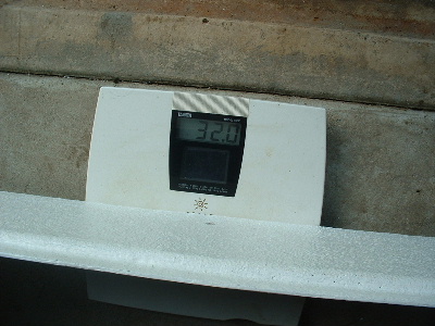

Also pictured here is the Tray weight(- the hatch)32kg. And the 500amp fuse yet to be fitted.

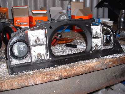

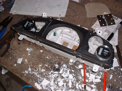

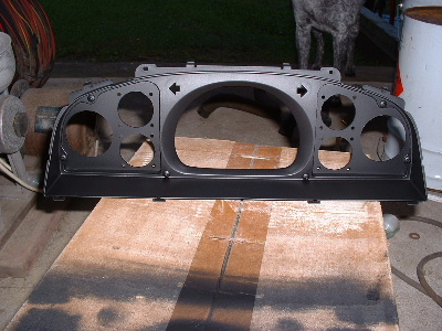

Gauges have arrived, very good quality too. The dash has been cut to fit the gauges in. These will be fitted and wired in when other important bits are done (see below).

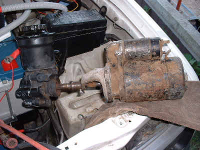

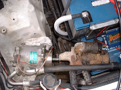

Tested the amp draw of an air conditioning pump clutch, 2.8 amps at 12v.
Tried several motors on the air conditioner and power steering pump. The only one that could give some decent amp draw readings was the modified starter motor. The linkage from the solenoid was disconnected and wiring not used. I rewired the brushes to make it spin the right direction. The end was cut off to expose the end of the shaft. Made adaptors to connect to the pump’s.
Connected to the air conditioner pump the amp draw (12v) was 200 amps.
Connected to the power steering pump the amp draw (12v) was 110 amps.
The quest for sourcing motors for these pumps still continues. Although I am now thinking I may not use the power steering. There is a commercial made power steering pump available for vehicles that do really require power steering. We can steer the vehicle without too much hassle.

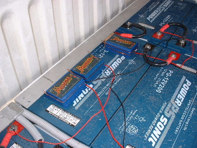

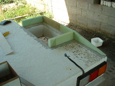

Have discovered a weight problem in the front, and currently modifying the rear box under the tray to carry the two batteries that finished making up the 144v system. With 126kg of lead shifted to the back, this makes the steering even better. With this change, also comes other changes that go with it. New mountings & cabling etc.

Some pics of modifying the rear storage box to fit the big batteries that used to be in the front. Batteries are now fitted and the necessary rewire is complete.

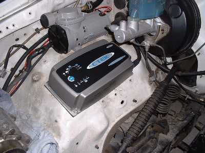

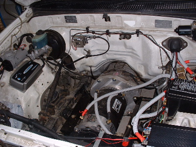

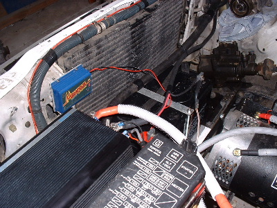

Amp shunts and 500amp fuse is fitted. The speed controller and the two chargers are re-mounted differently too. Gauges fitted but dash not completely back together yet....tommorow. Pics on these next time.

Pics of the new mounting for the speed controller, also showing the 500 A fuse and the amp shunts. Only one short cable could not be reused in the new configuration, an extra cable had to be made and one had to be lengthened.
The 12v charger is re-mounted on the right hand mud guard. The 144v charger can be seen in the previous post, in the rear storage box. The 12v battery has been downsized for now and left in the same place the larger 12v battery was. We plan to change this later to 2 x 120 a/hr in the rear storage box and none in the front. So then the 12v charger will also be shifted to the rear storage box.
The dash is all back together now.
