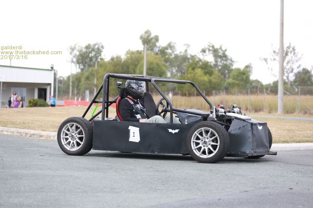

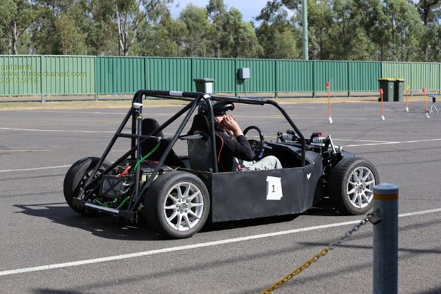

Hi everyone,
I have been competing in grass roots motorsport since 2005. But recently I built myself an Electric Vehicle (EV) from the ground up.
Engine: Advanced DC FB1 4001
Exhaust: None
Suspension: Home grown
Wheels: Various (some Bob Jane specials and some Simons)
Modifications: Everything from the ground up
Stereo Audio / Visual: None
Estimated Power: Power is not huge at around 75 KW but the torque is 440nm from 0 revs.
I know its not the usual ride you would expect to see here. I have built this car specifically for khanacross events. It weighs 530kg. Most of the running gear is from an N13 pulsar. It is front wheel drive and still has all 5 forward gears.
I also use it for Motorkhana and hill climbs but it is most suited to Khanacross. The batteries are from a Holden Volt. They give 7kwh of power starting at 170v dc and a peak of about 500amps. The motor controller is a Curtis also capable of 500amps.

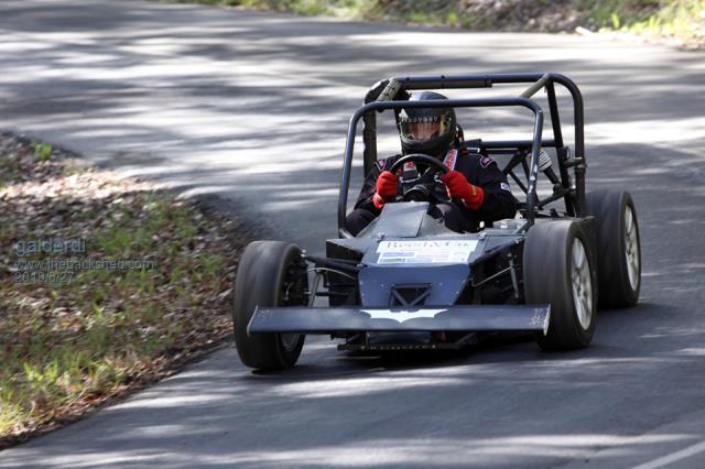

I made it to the final event for 2016. It was the Interclub motorkhana. The car and driver both performed fairly well. I managed to secure 6th place outright. That put me ahead of 8 out of the 10 Porsches and all 4 Caterhams.
There is still pleanty of room for improvement. The controller kept defaulting to 500amps instead of providing the full potential (circa 800amps maybe more). Plus I was using up some very old, very hard tyres. Heat was a concern. The air temp was around 35 degrees. As the motor built heat during each run it was unable to shed the heat and much of it was flowing into the controller (not a good thing). I will be adding some extra precautions to protect the system.
I have made a list of adjustments to make before the next season begins.

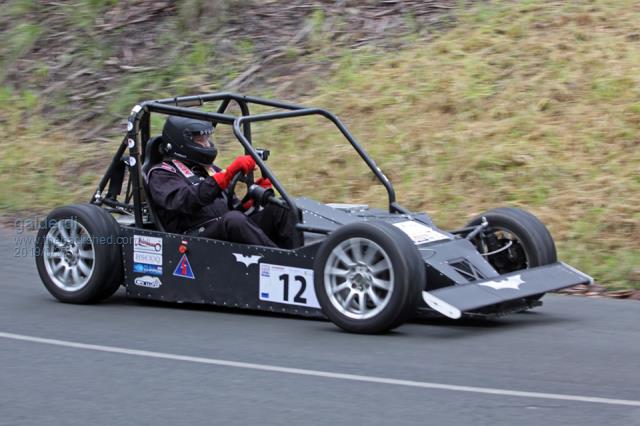

I managed to place 1st in class for khanacross and 2nd in class for motorkhana. Not bad considering it was largely a development year.
I have modified my rear lower control arms. They are now adjustable. I can wind them in or out to control the Toe and camber. I have also added a heat shield between the motor and controller.
I am really looking forward to the 2017 season.

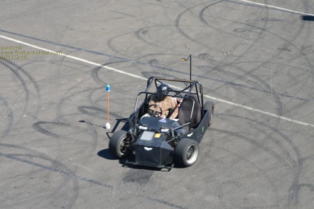

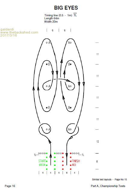

Motorkhana is about as grass roots as grass roots motorsport can get. It is basically a point to point time trial through a predefined test. The tests are registered nationally. There are around 100 tests registered. The tests are carefully measured so that competitors can improve on their results for each test from event to event an location to location.
My vehicle is considered a "Motorkhana Special" as it is specially built to compete in motorkhana. But motorkhana is open for all road cars and the majority of competitors drive their vehicle to and from the track.
The tests are extremely tight and technical. While acceleration is important, driver skill and memory are much more important. For any turns tighter than about 100 degrees it can be quicker to use the handbrake. This allows the rear wheels to brake traction and quickly spin the car into a new direction. To do a handbrake turn requires a fairly sudden application of the handle in order to brake traction. For the standard, cable, handbrake this is not a good thing. Even a few handbrake turns with a cable handbrake will likely stretch the cable noticably. So many of our competitors either choose to drive the corner (without the handbrake turn) or install a hydraulic handbrake. Hydraulic handbrakes can be applied suddenly with no risk of damage to the cable, and they apply th brakes more effectively too.
Motorkhana is an awesome platform for kids as young as 12 to learn how to control a car. By the time they get their license they have a much better chance of handling unexpected situations. In particular city kids that don't get the opertunity to drive old cars in paddocks. Even as an adult I credit motorkhana skills with my avoidance of 2 major incidents.

Here is an example from one of the tests included this past weekend.

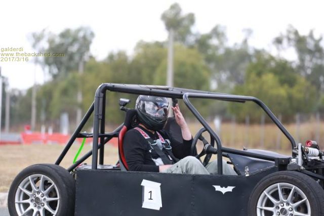

Thank you for your very informative reply. I'll look at the videos later, the pictures look great.
Now I know you were sitting in a kind of go cart with a roll bar and seem to have lots of fun.
I assume its rear wheel drive? Does the electric motor have regenerative braking? If it has could you not tweak that to act like your hand brake when you get to a tight corner?
galderdi
Joined: 12/08/2016
Posts: 99
Posted: 01:01pm 16 Mar 2017
No problems. No it is front wheel drive. I chose FWD for 2 main reasons.
Firstly I can put my expensive/sticky tyres on the front and old/hard/thin tyres on the back and still get great performance. With rear wheel drive you have to put sticky tyres on all 4 corners to get performance.
Secondly FWD tends to be ever so slightly quicker in motorkhana.
No regen unfortunately. I haven't had experience with regen but I imagine it wouldn't lock the hubs, if that is true it wouldn't help with handbrake turns. Unless it was applied at the same tiem as a handbrake.
Also the other usual questions are about AWD and All wheel steer. Both of these are against the rules in my sport.
As is anti lock brakes and traction control.
I have just started work on the next car. It is probably 18 months away from completion. I will keep the existing car and it will focus on the higher speed events to which it is more suited (due to the larger footprint). The new one will be a pure motorkhana car. It will still be FWD. It will be a bit shorter, single seat, slightly narrower in the front, much narrower in the rear. I am aiming for sub 300KG. The motor will be the baby brother of this motor (8 inch instead of the 9 inch). But the power to weight will probably increase overall due to the targetted 40% weight loss.

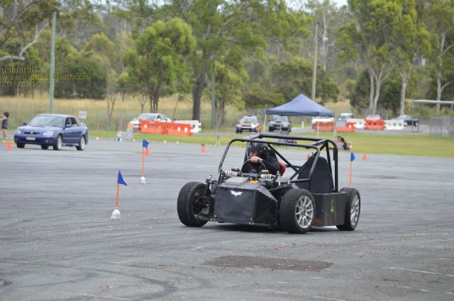

I was competing in Rounds 1 & 2 of the Queensland Motorkhana Championship in Gladstone over the weekend.
In preparation for the event I had a trailer brake pad seperate from it's backing plate. So I replaced that before leaving as travelling for about 18 hours round trip with no trailer brakes didn't appeal to me.
I tried to adjust my clutch cable, but in the end the cable gave way and sunk into the sheath. Luckily I didn't need the clutch for this weekend anyway.
Then when loading the car on the trailer I realised the throttle was playing up. I eventually reverted to an older throttle I had as a spare.
Luckily the weather held out despite the looming tropical Cyclone further north.
The first day the car was running very well and I was positioned in 3rd for most of the day.
But later in the day the heat got to me and I had a brain fade moments.
I still managed to place 6th outright which isn't bad considering I got 3 tests wrong out of 12.
At the end of the last run on day 1 it was apparrent I had developed a significant vibration. I beleived it to be a loose bolt from the flywheel or clutch plate putting the flywheel out of balance. Or potentially a worn gearbox bearing. The motor itself still seems to spin smoothly.
With little time and without my workshop facilities I could not risk separating the motor and gearbox to inspect the problem.
At the end of day 1 I was faced with the decision to protect the vehicle or continue with day 2. If the event didn't figure in the season standings I would have pulled out.
But as it was Round 2 of the Motorkhana season I decided I would proceed with caution.
I figured I would coast through the day with the aim to complete at least 50% to at least earn some more points towards the season championship.
On day 2 I found the vibration was worse at low revs. I was hoping it was just the clutch out of centre, but my clutch cable was out of action so I could not release the clutch to help it re-centre (if that was the problem).
But I pushed on. For any medium to long tests I selected 2nd gear from the start and turned the current up.
This was my attempt to keep the revs at a managable level and not do any further damage. I also periodically cooled my head with ice, which I think helped me concentrate, resulting in better results.
In the end I managed to achieve 3rd outright for day 2 which was about my target coming into the weekend and well exceeded my expectation after developing the vibration.
I have packed the car away as we have some really bad weather looming for the next few days. Hopefully this weekend I will be able to pull it apart and identify the problem.
My next event is a khanacross on April 9th (2 weeks). Hopefully it is a quick fix other wise I will miss my second khanacross in a row.
That would be devastating as the car is much better suited to khanacross and I have been really looking forward to seeing the car's true potential.
