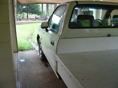

Some raw data on performance of the Toyota Hilux 2.7 litre petrol converted to electric drive.
Weight
before, 1363kg
after, 1940kg (measured), but with changes after expect it to be 1926 kg
Hp
before, from The Red Book, 108kW @ 4800rpm = aprox 144hp
after, rated at 100
but voltage is 144 nominal at max 500 amp (speed controller max) = 72,000 watts. Therefore 72 kW / 0.746 = 96.5 hp.
Acceleration
before, 0-60km/hr in 6 seconds, 0-100km/hr in 15 seconds
after 0-60 in 12 seconds, 0-80km/hr in 18 seconds, and 0-100km/hr in 30 seconds.
Top Speed
Have had it to 120 km/hr on relative flat ground and don’t expect any more.
Amp Draw
200-250 amps at 100 km/hr
130-150 amps at 80 km/hr
80-100 amps at 60 km/hr all on relatively flat ground.
Range
Have done 100 km driving at 80 km/hr on highway
Have done 80 km driving at 100 km/hr on highway
Town driving at 60 km/hr (accelerate and coast) is expected to be at least 120 km, but still yet to test it.
Electricity
1) 50km driving used 19.2 kW measured at the supply meter box.
2) 60 km driving used 20 kW measured at the supply meter box.
Electricity Cost
1)19.2 kW / 50km x $0.06 (super economy rate) x 100 = $2.42 per 100 km
2) 20 kW / 60km x $0.06 (super economy rate) x 100 = $2.10 per 100km.
Total km
driven so far is 342182 – 340092 = 2090km
There has been lots of general use. All the usual things you use a ute for. It’s a great ferry taking Dale (my young boy) to school and back. Marcy has been driving it more than me.
No problems driving in the rain, and muddy/gravel road. I have driven through the creek that is between home and the highway, water about 200-300mm deep.

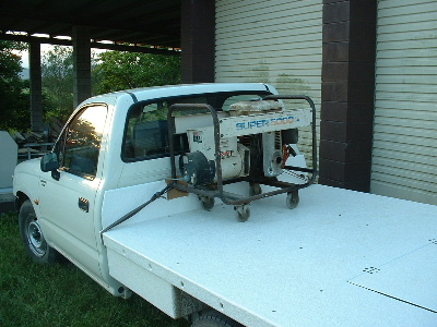

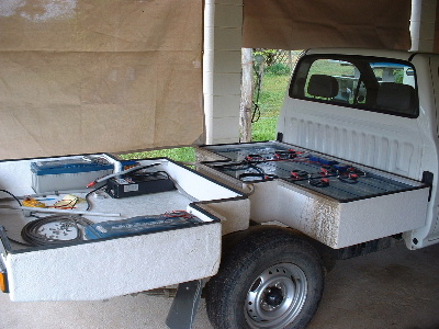

Tested a 5 KVA generator as range extender. Connected to the charger, there is only 15 amps delivered to the batteries. Rectified and connected direct to the batteries I was getting 23 amps. Not a lot of power considering the amp draw, 23 amps charging, and 200-250 amps discharging, but set out to see how it works. Had driven about 20 km and the brush holder melted and spat one of the brushes out. I will work on some other ideas / experiments that I have in mind. But I think the best solution is having a much lighter vehicle in the first place, so the amp draw is much less.
Trev @ drivebynature.com

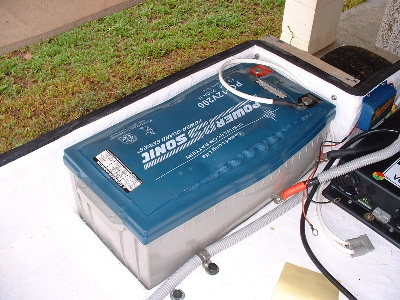

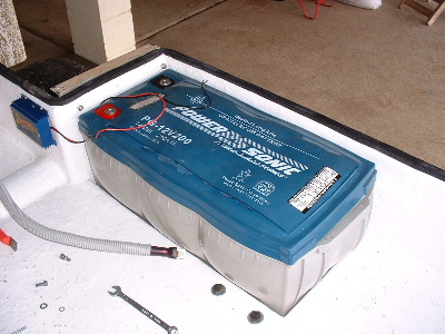

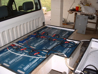

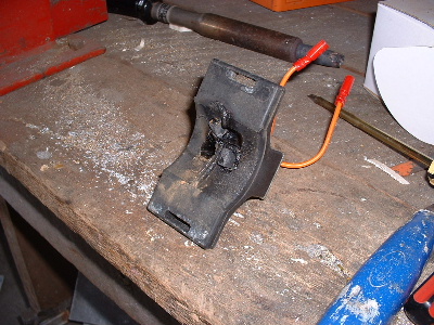

There is some battery problems. I had done about 50 km of driving and at the destination discovered that the 2 batteries in the rear box had become so hot that the plastic case had softened and swelled like footballs. The top is no longer sealed. The worst one was removed and replaced with the 13th one purchased at the same time. This swelled one is still working connected in with the wind and solar setup. The other swelled battery is still in the EV and still working.
I have emailed several times to the supplier and importer with no satisfactory answers why this has happened. They simply don’t know, but say it is likely to swell in charging. The swelling occurred in discharge while driving the vehicle.
I do not expect that these 2 swelled batteries will last very long, due to dry out. The batteries are just over 1 yr old with a 2 yr warranty and it appears that they are questioning and refusing to honor the warranty. I will no longer recommend these batteries as suitable for EV use, even though they still claim they are. There is no problem with the other 10 batteries all tightly packed together in the front box. To me, it seems to be a manufacturing fault. If they do honor the warranty I will make a posting to say so.
If any one has any clues why the heat and swelling, I would love to hear.
Now we have a range of about 70km at 80km/hr.

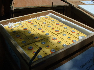

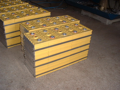

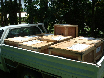

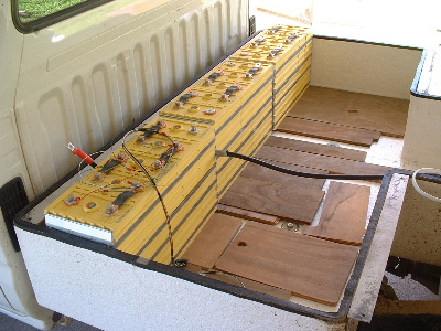

New batteries are in the process and we do not expect this should have any effect whatsoever on the warranty issue with the Powersonic batteries.

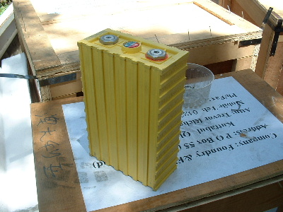

Thundersky Lithium cells are the latest addition to our product range. I have done some theoretical comparisons between wet cell, AGM, and Gel lead acid, with Lithium. Email me if you want a copy of these comparisons.
We have received the first order of Thundersky Lithium cells. Our pack is part of this order. I made a small error in not checking the input voltage to the charger. I had assumed the input was 240v single phase, but it is 380v 3 phase. So this one has to go back and they will sent another one. We will fit our Thundersky Lithium as soon as we recieve the other charger.
These cells are 3.2v nominal, so we have 45 cells in series to give the operating voltage of 144v nominal. Each cell is 200 a/hr. This is more useful electricity storage because there is no peukarts effect, like there is with lead acid.
Weight is only 7.6kg /cell x 45 = 342 kg. The AGM lead acid currently in use is 64 kg x 12 = 768 kg. A weight reduction of 768 - 342 = 426 kg.
We expect that our EV performance will greatly improve.

I would also like to see your battery comparison. I am doing an EV conversion using a Geo Tracker (2WD) - a fairly small and lightweight vehicle. I am interested in seeing your battery comparison, as I am planning on using about 1100 lb (500 kg) of lead acid batteries.
Once question - how large are the Thundersky batteries? They look rather large, and in my vehicle, space is as much a concern as weight.
Thanks,

Surprise surprise, it has now been 4 1/2 months, but I just received an email from Powersonic! They intend to send me 2 new batteries, under warranty!
We are still driving on the Powersonic batteries, even with one of the swelled batteries still in the pack.Edited by Trev 2008-04-01

Posted: 07:15am 06 Apr 2008
Thankyou Powersonic, we have recieved the 2 new batteries.

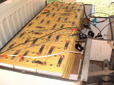

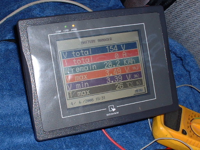

We have now fitted temporary the Thundersky Lithium batteries.
Initial charging is by the Zivan charger (used for the powersonic).
First drive did 40km using approx 10kw according to the screen.
After recharging again set out for max. distance driving at 80km/hr and achieved 140km using approx 25kw according to the screen.
That is double the range over the Powersonic AGM lead acid (70km, but with one swelled battery still in the pack.)
More testing and performance details later.

  Trev said   We have now fitted temporary the Thundersky Lithium batteries.
Hi Trev,
What is the difference between the 2 sets of data? Are the lipo batteries that much more efficient? Is it possible the weight difference has made this much difference? I make it $1.50/100km.
The results are looking good.
cheers, Gordon.

Driving 40km on 10kw is according to the BMS screen. Yes, Gordon this does make 10kw x $0.06 / 40km x 100km = $1.50 per 100km, but not correct due to the losses in the charging system etc. This is the same with driving 140km using approx 25kw.
Had driven 112km mostly at 100km/hr and used 24.5kw according to the screen. The Kw measured at the supply meter box was 37kw. Dollars then would be 37kw x $0.06 / 112km x 100km = $1.98 per 100km

I have ordered another set of batteries and if anyone wants to get in on the same shipment, I can give a very good price. Economies of scale are very good with multiple orders in the same shipment. If anyone is interested, you will need to contact me asap.

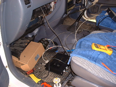

I tested the big 60A 3phase charger at the local saw mill and it works very good. It can charge the battery pack in 3-5hrs from right empty. For those that don't have 3 phase power, the option is, Thundersky have granted the normal warranty on the bateries if we use Zivan NG3 (single phase) chargers, along with the Thundersky BMS.
