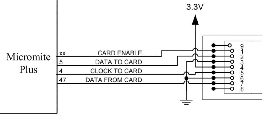

I am now trying to get the SDcard functions to work correctly but, is a no go..
I connected the SDcard socket up like it shows in the MM+ manual as shown here:
Using the FILES command says that the SDcard is not found...
So, after checking all the wiring again, I was pulling my hair out so, I decided

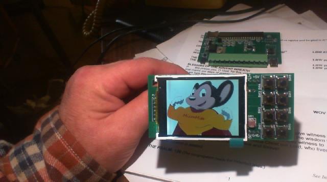

to take a look at Grog's excellent Explore 64 PCB and see if the socket pinout was any different.. Sure enough, it does show a different connection setup as shown here:
So, since my setup is not working, I guess it's time to get Mr. Razor Knife and see if the wiring change to pins 1,2, and 3 will get this thing working...
I will report back after "Surgery" and let you guys know if this helps..

Ahhhhhh yes.......
The ole 'MicroSD card pinout is different to the full-size SD card' dillemma.
As you have discovered, MicroSD cards have a slightly different pinout to full-size SD cards, so you have to make some changes there. If you wire up a MicroSD card socket the same as a full-size SD card socket, it WON'T work, as the pinout is different - as you now know!
Mr. Google is your friend there - type in 'Micro SD card pinout', and have a look at some of the hundreds of IMAGES you get back which show you what pin is what.
If it makes you feel any better, I made the exact same mistake when designing the Explore-64 with Geoff. I assumed the Micro-SD card would have the same pinout as the full-size SD card - WRONG!!!! In the 1A prototype(no-one has any of those), the SD card would not work for me either! I had to hack it to correct my wiring mistake, and then it DID work!

Post "Surgery" feedback..
OK... Things seem to be working fine now...
I did use pin 6 as the SDcard CS pin and, was correctly informed by the firmware that this pin was being used for the AUX console port.. So, I did set the option to
OPTION CONSOLE OFF
Nice..! OK... Now to turn on the WAVE sound system.. Prototype testing continues..!
