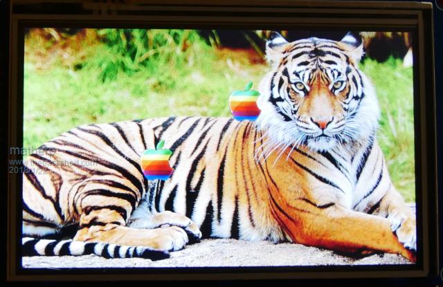

This release plays with some ideas for Sprites building on the existing BLIT functionality which has also been slightly simplified/improved. Sprites are full colour and of any size and shape. SPRITE/BLIT images can be displayed partially off the screen, this was not previously the case for BLIT on the MMX, and I believe the MM+, where partially off screen images were corrupted.
The commands and function SPRITE and BLIT can be used interchangeably
NEW FUNCTIONALITY
SPRITE LOAD
A new option in BLIT/SPRITE is added to directly load a .PNG file from the SDcard. PNG files are the standard for sprites in CSS and it seemed to make sense to allow the Micromite to load them directly
2018-01-22_034650_apple.zip

The code for a very simple demo is attached
