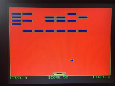

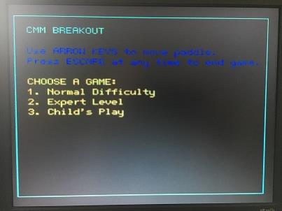

I just completed a game for the CMM (Color Maximite) - a clone of Breakout, but it uses a few parts of the Sprite system and brought up a few issues I see with the current implementation.
(I posted this yesterday on a thread Geoff Graham posted called "Seeking Games Programmers" but I thought it would get more views if I just started a new thread here).
Two improvements to MMBasic's implementation of Sprites I can think of (unless I'm using the sprite system incorrectly):
1. There's no way to reuse a sprite bitmap (defined in a .spr file) for multiple
sprites in a program. For example, I didn't use sprites for the bricks in this
game because I would have had to have the same brick image multiple times (63
times in this instance) in the file, which would have made the file
unnecessarily big for this game.
2. The Collision function doesn't seem to be accurate when testing for two
sprites overlapping. It works, but its not pixel-perfect (perhaps its not
implemented to be that way). Here's some example code:
r = Collision(3, SPRITE)
If (r And &B10000) = &B10000 Then
' not exact, sprites overlapping by several pixels before this evaluates to True
Here is the source code to the game if you're interested in testing it out. I'd love to know also if people notice flickering on the sprite images themselves (mainly the paddle in the game). No matter what I did I couldn't get rid of this problem.
