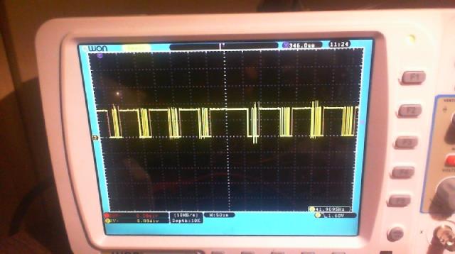

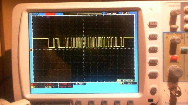

I actually managed to get a few hours in on playing around with a possible MM application I would like to try... It involves trying to create a new status display device for one of the Bitrode battery testing machines at work. Currently, we use a 2 line character display for this device and I would like to fancy it up a bit by using a 470 based 5" color touch LCD and add some functions to it...
Bitrode machines use a ColdFire based processor as their "Rack Controller" and uses one of the MPU's serial ports to transmit 9 bit based Rs-485 "packets" to the multiple test circuit "status displays"... The baud rate is 640K. The data packets should be going to Node Address "0" and "1", maybe more.. Getting more data on this...
Since i have one of G's excellent E-100 PCB's with a 5" LCD ready to go, I decided to use this as a "test bed" to help with the code testing. So, I started off by trying to write some "low level" code to try and get some data packets captured...
I used a DS3695 transceiver IC and a resistor ladder to get the 5v signal down to something safe for the MM input. By shear luck, I managed to get a scope shot of one of the ColdFire transmitted packets being sent to the MM receiver...
After several hours, I came up with this starting "test" program...

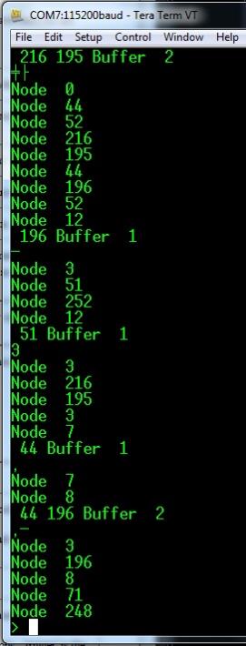

After some "stare at it" time, you can see what I am trying to do here...
I have a defined "Node" address set to "0". I decided not to use interrupts
in the port OPEN statement. I just loop as fast as it goes, waiting for 2 or more
bytes to be received. I use a "address match" flag to open the "data collection gate"
and add received data bytes to the "rxdat" buffer string. As long as a "0" is being received as the 9th bit, I stuff it into the buffer. I also print the ASCII value of the data going into buffer as its being filled. If a "1" is received as the 9th bit, I close the data gate and print out the number to characters received and then print out the rxdata buffer...
So, Originally, I was looking for a "1" on the 9th bit AND a match to the currently
set "node address" setup at the start of the program. Well after getting NO data ever received, I changed the bottom of the routine to open up the data gate on ANY received node address. I then actually started to get some action from the running program, but it's seems to be making not much sense..
It seems like the data is getting "out of sync" somehow because I know there should be no data packets being sent to the "wild" number of "nodes" being detected...

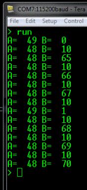

This Tx code is a single pass thing that transmits 2 "Packets", 1 for node 0, one for node 1. I took a look on the scope and it shows 2 groups of 4 bytes being sent..
So, on the E-100 side, I had this program running, waiting to receive any data coming in..
' 9-Bit Rs-485 Recieve test
Option default none
Option explicit
Dim a As string length 1 ' 9th bit - 1= adress - 0= data
Dim b As string length 1 ' 8 bits of Rx data
Open "com1:640800,2048,9bit" As #1
got_rx
Sub got_rx
If Loc(#1)>2 Then
a=Input$(1,#1)
b=Input$(1,#1)
Print Asc(a);Asc(b)
End Sub
End
I got this back on the output of the E-100..
I got my data back and the correct node address target device codes, but I am not sure what the extra bytes that contain the "10" value are..
