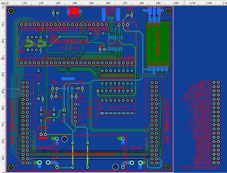

@ WW - 7" LCD panels. Running two of them in parallel. The LED back-light supply is a separate regulated 5v, but I wanted to make sure the 1963 chips did not suck too much current, as I plan to feed them from a 1703 regulator, and they can't handle more then 250mA max. I have designed a new board that connects only the data lines together - here was a thread about this recently, and other members have proved it works, so I am now doing the board for it.

Here's a sneak-peak at the PCB:
I need to redesign the 1455 side of things OUT of this layout, as the new 1D E64's fix that for me.

Looks nice.

Looks good G.
Out of interest, is it not worth considering using your New E64 instead? This is assuming there is enough space with the additional height of the daughter-board!
Nice sizing you squeezed it into there.

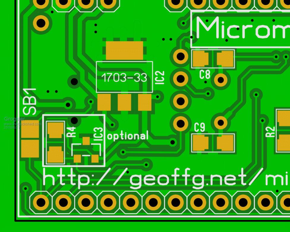

Here you are, WW:
The 11AA160 is connected to Pin-30 on the E64. This pin does not have any other assigned task, it is just a plain I/O pin, so I figured this was a good one to go for.
I can't have the 11AA160 on any of the other pre-defined pins, as I am sure you would agree.

Hi G,
I was assuming you meant adding the 11AA160 to your 'Dual Screen' PCB - not the new E64. However, great idea to add onto the E64 as an 'Optional' install.
Two comments:
1> Is it worth adding some silk-screen wording to imply what it is for? Under 'Optional' put '11AA160' maybe!
2> Could you allow for TO-92 as well as SOT23. Not essential - just asking. I guess this depends on tracks on other side of PCB!
WW
Posts: 10056
Posted: 08:57am 27 Aug 2018
Yes, I am thinking of adding this to the 1B(production) 1D boards.
1) Good idea. Will do.
2) TO92 would be pretty much impossible due to stuff on the other side - Not gonna happen.
