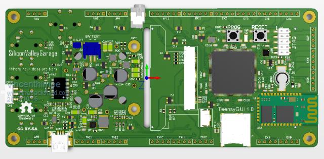

I studied the MZ datasheet a bit and there are actually 6 I2c controllers. all identical , just with offsets. The current i2c code is pretty convoluted ( i have the C sourcecode) and i'm thinking of writing a basic library that is portable between the channels. you just provide the channel and the code uses different offsets.
I am trying to port an existing hardware project from Teensy to the Extreme version.
I use a capacitive touch screen (as opposed to resistive which looks dull and reduces luminosity of the panel) and i use one i2c bus for internal household : buttons, led's , navipad (rotary encoder with 5 way tactile pad). battery backed RTC , battery gauge / charger and more stuff.
The hardware is open source and posted on Circuitmaker hub.
