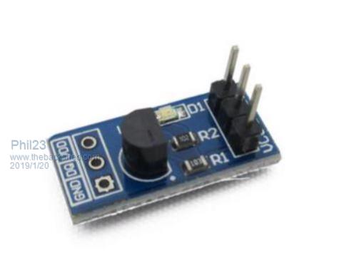

Just wondering is my DS18B20's are self heating themselves a bit.
Not so much the sensor it's self, but the SMD Led & 1k resistor on the board.
This is them....

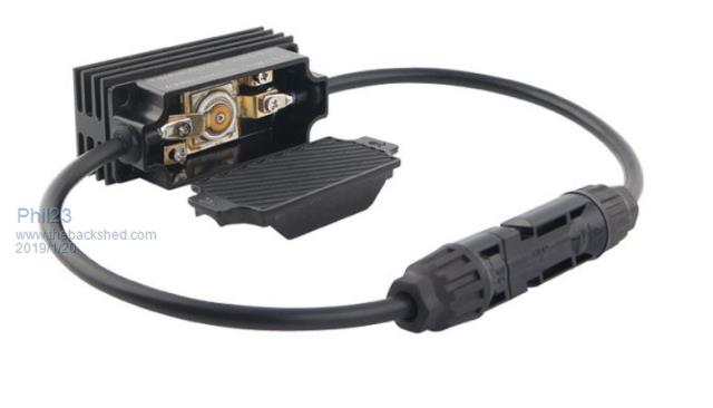

What has got me thinking, apart from the possible 1°C or so value I question is the heat I'm seeing in my solar blocking diodes.
When carrying 8 amps they get to about 62°C, & I'm guessing that is coming from about 5 Watts.
The LED & resistor would consume 25mW? Is that a significant amount for the size of the PCB & module?
These are the solar diodes...

My modules have the 10k resistor, D1, removed.
It's between 5V & the data pin.
Mine are connected as a string of 10.Edited by Phil23 2019-01-21

I would like to see the DS18B20 mounted off the board a bit to thermally isolate its case from the board itself & move it away from the LED etc. (I assume by the look of the photo it is sitting on the board).
BTW, on some of my open air sensors, I use a female spade connector as a bit of a heatsink.
I cut any plastic insulation off them & open the spade part up just enough so they slide over the sensors. Having a heatsink will even out temperature fluctuations & reduce any self heating effects. It does slow down the response time a bit though.
Not sure what you are on about with the solar blocking diodes. . They will dissipate heat with current going through them when operating.
What temperatures are you actually measuring?

  Chopperp said  Not sure what you are on about with the solar blocking diodes.[/quote]
I mentioned them as I was a bit surprised by the temperature they reached with only about 5 Watts being dissipated.

They do get hot. A 5W soldering iron gets very hot as does a 5W resistor at full power.

Quick & dirty analysis this morning.
Cut the track to the LED on 2 of the sensors hanging easily accessible...
My office down from 29.4 to 28.1.
Bedroom down from 27.75 to 26.5.
Not much scientific control of the comparison, but it looks like at least as full degree of variation.
Should win immediate brownie points for the lower temp readings with MrsC I suspect????
Phil.

Have you tried blowing a gentle stream of air across your (unmodified) boards to see what happens?
Should reduce effects of the heating elements etc.
(Not much good if you are just measuring still air though).
