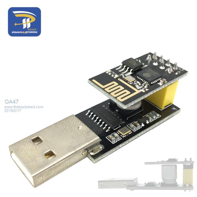

I purchased some ESP and Serial-USB converters as shown.

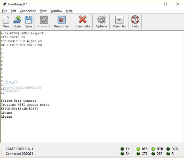

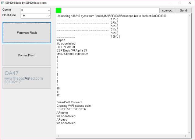

The first thing I did was to upgrade the ESP unit with ESP-Basic v3 and this all went ok.
The units boot up with the following messages on the terminal program.
I can log onto the ESP WiFi without any problems.

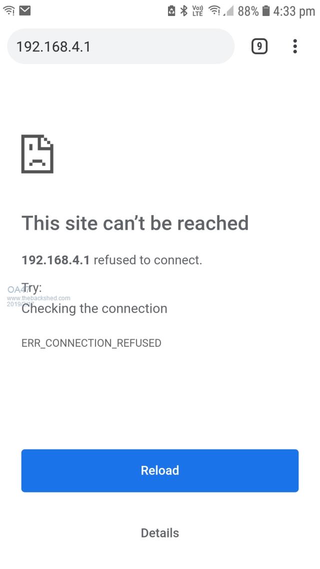

Before I can update the ESP with logon details and ESPBasic code I need to be able to reliably connect to the pages. Occasionally I can get the main page up (But very occassionaly) and if I do I cannot navigate to the SETTINGS or EDIT pages. I have tried 3 different android devices and get the same result. Can anyone assist with where I am going wrong?

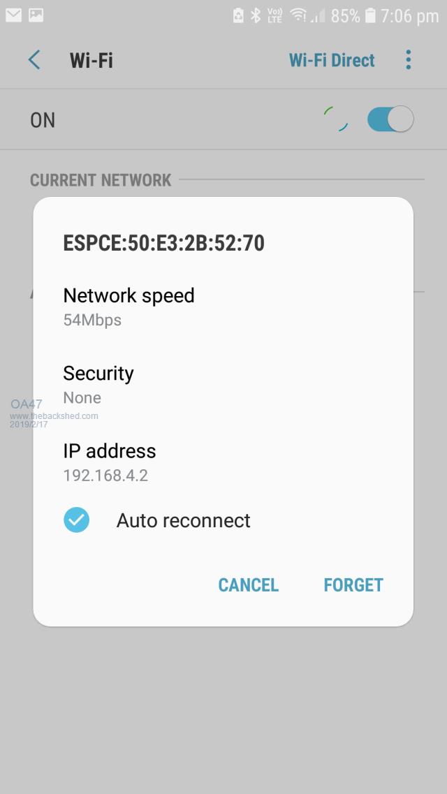

Thanks for the reply CYBERLAB. I am connecting to the access point mode of the ESP8266 as the android screen shot shows "Current Network ESPCE:50:E3:2B:52:70" and it is awarding the IP address of 192.168.4.2 to the android device.

The issue I have is that I cannot bring up the page 192.168.4.1 to configure the ESP8266.

Hello, the most likely thing that is happening is that it is not loading well the espbasic file, to be honest every time I try it with the application ESP_Basic_Flasher.exe, it never worked.
luckily at that time I started using micropython in the ESP8266, which by the way I recommend you take a look.
use the same steps to load the micropython to load the ESPBASIC and in the first attempt it works, I comment the steps in case you want to try it.
First download the latest version of python, for your operating system there are 32 and 64 bits, at this moment it is 3.08.0a1, when starting the installation check the box: add python 3.8 to path, everything else accepts what you propose by default.
Once installed, open the DOS COMMAND window and execute the following:pip install esptool
once finished the process connects your nodemcu and verify what port number your pc assigns.
in the same window execute the following:esptool.py --port com3 erase flash
replace com3 with the port number assigned to your nodemcu, this step is to completely erase the flash.
Download the ESP8266Basic.cpp.bin file from the page and save it to c: \ users \ name \
replace name with the username of your pc.
then run this command: esptool.py --port com3 --baud 460800 write_flash --flash_size = detect -fm gave 0 ESP8266Basic.cpp.bin
again replace com number.
wait until it finishes and in some moments you will see in the wireless networks of your pc one that starts with ESP connect to that network opens a session with your browser and in the address bar enter:192.168.4.1
click enter and voila the page of your esp8266 appears.

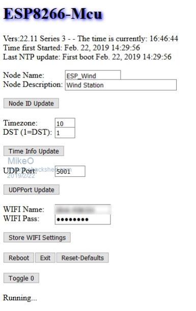

Setting up ESPbasic successfully on a ESP8266 module can be a little challenging sometimes.
In order to help out one of our forum members I found that my documentation for this process was sadly lacking and mostly "in my head" so I have gathered the tools together , created a pdf describing the process and even made a few more code changes to my ESP8266-MCU library for the module. I have updated my web page so if anyone would like to have a go please visit here for the information.
The ESP8266-MCU does not need a uMite to be connected, has its own UI and could be used as the basis for your own application.
